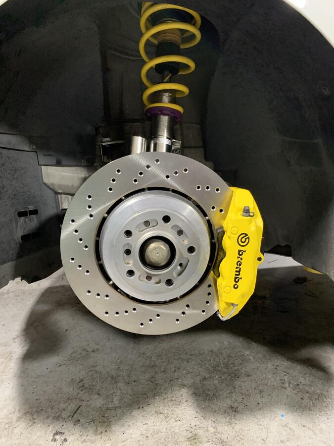

Hey guys, i just finished my install, and it took about 12 hours to finish. Some side notes if anyone is interested. I was using 12.5 MM Turner Spacers in the front and it did NOT clear, it was super close id say about 1mm. 15mm was good. As for the brackets, I used RR for the rear, and I did not have to grind the bolts down at all, it fit flush no issues, used CM for the front, and no issues either, everything fit flush with no Macgyvering needed. Def get some help if you can. Pads were flush , did not use and dampers for the rear just the front, and no noise or vibration,squeeling or knocking. Big thanks to Tyler (Tbone_) and XPEM3 the write ups they were were incredible, step by step made the whole process way easier. Big thanks to the forum.
yessir ZCP, will post pics later once i wash my car because its dirtier than i am right now. Big thanks tyler much appreciated honestly, shit would of been an absolute headache without those writeups.
Great info guys! I was just asking this question in another thread. I’m running OEM ZCPs and currently have 12mm spacers in the front. Picked up a set of 15mm spacers based on old info, but looks like I won’t need them. I’ll report back after my install.
So it sounds like you will need 15mm according to bassel
I want to revise what I had said earlier about csl/zcp width difference affecting clearance- it wouldn't. The half inch is spread across the midline evenly so only offset needs to be considered, I believe.
So 15mm spacer for zcp et47 and 12 (even 10 but too little gap) for csl et44. It makes sense as my offset is 32 which is 12 off 44, and my wheels fit without a spacer, though just. Et30 (10mm spacer) would probably be too close for comfort.
Kind of late since I already orderd all the parts.
Will the Porsche Brembo calipers clear ARC8 18x9.5 ET35 front wheel?
From what I recall based on the old M3forum.net info, you will need a 3mm or 5mm spacer up front to be in the clear. I suggest you go with a 5mm spacer. Am sure Tbonem3 will chime in soon.
