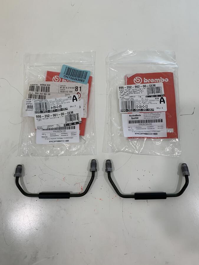

            Doing this conversion as my quarantine project, and I ordered two rear crossover pipes. However, despite ordering two different part numbers, I received two identical pipes. Can anyone confirm which one of these is wrong?
              Looks like you have two rear right pieces. These are what I received.
              996-352-961 is "left" and 996-352-962 is "right"
                Click image for larger version Name:	IMG_2816.jpg Views:	0 Size:	58.6 KB ID:	20379
                Noted, thanks!
                  I went thru the same thing when I ordered a new crossover line from FCP.

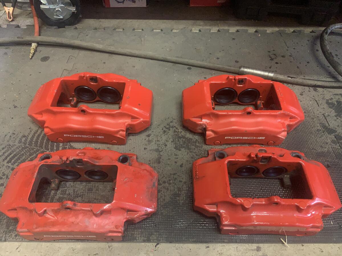

                              Finally got everything I needed to start my Brembo project - Stripped my Calipers and being sent off to powder coat Click image for larger version
                              Pretty much ordered - all new everything and I will take more pictures of everything once the caliper come back
