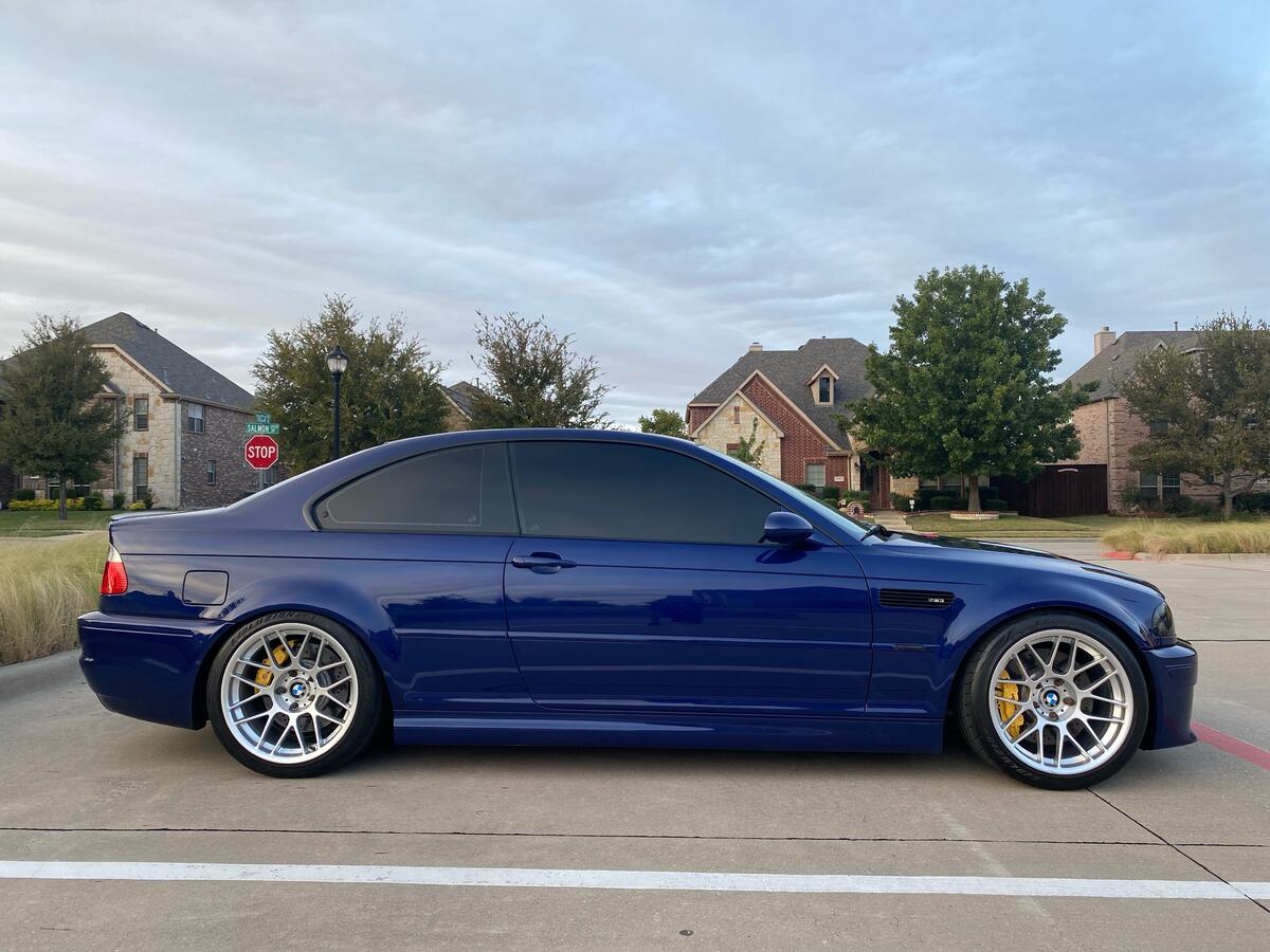

    Still need to drop mine off for paint, but here’s a local friends car that just completed install on his.
    ILB - yellow / so classic Click image for larger version

    2006 ILB | M-Texture

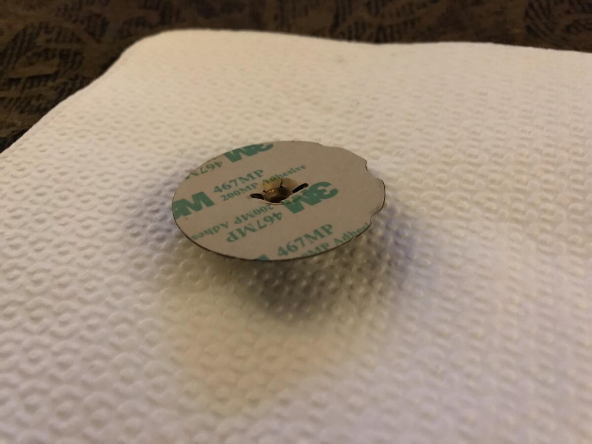

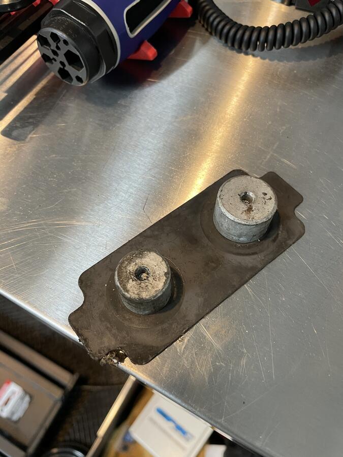

                              Did you guys install the brake shims below or can you leave them off?

                                I installed mine. They help reduce noice from the piston contacting the pad.
