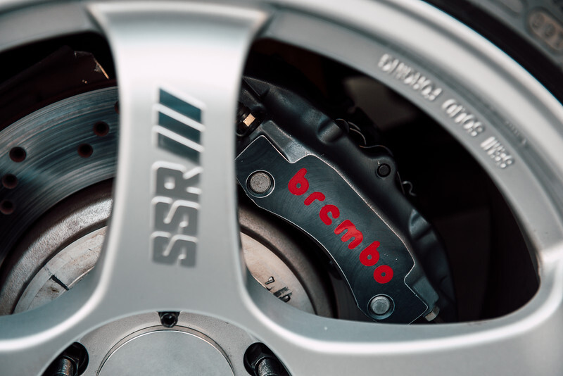

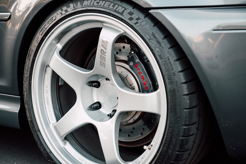

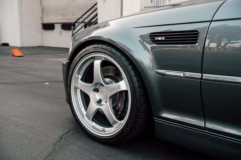

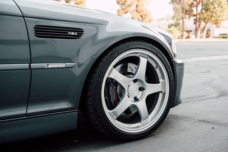

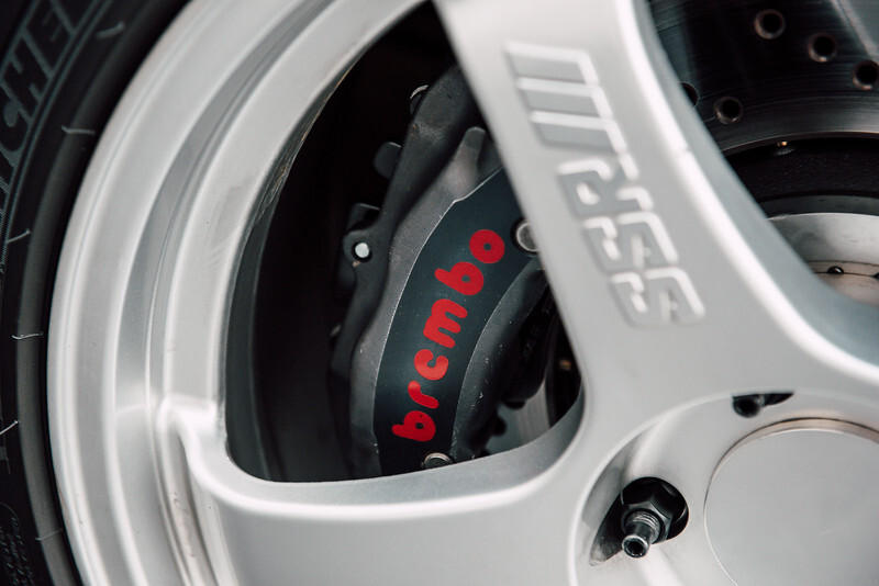

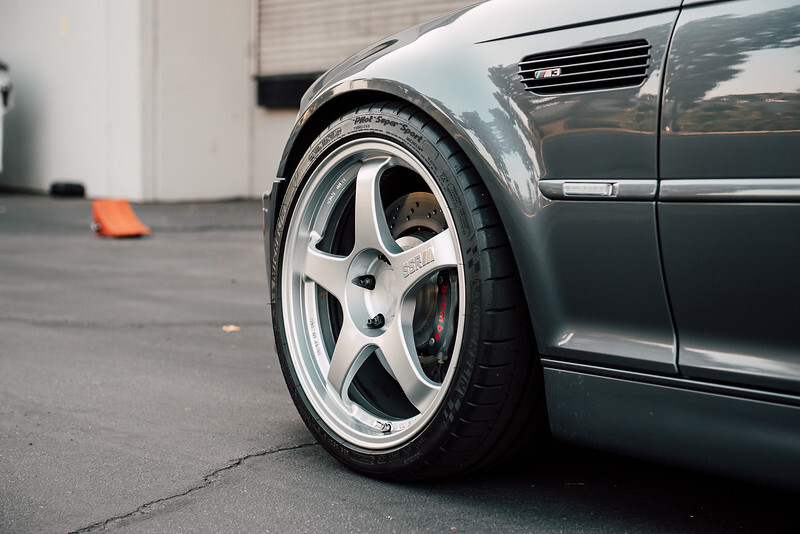

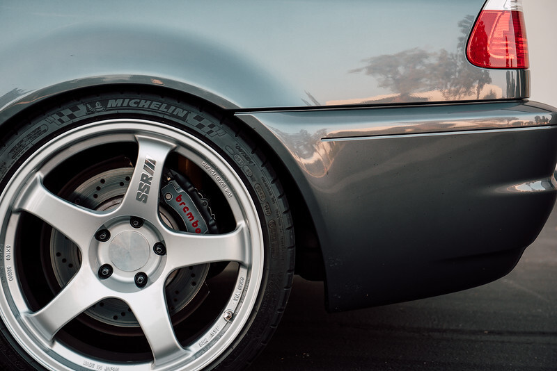

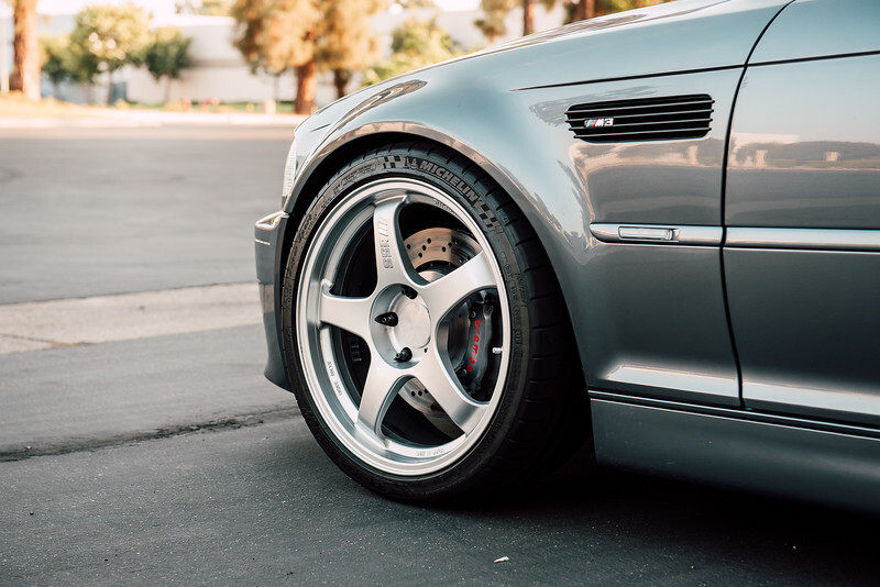

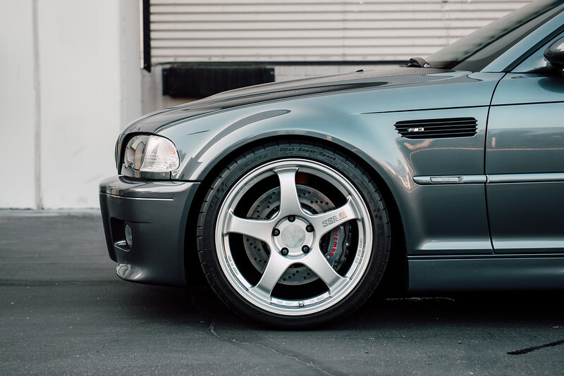

                    Hi guys, here are few photos from my recently finished install.
                    I am still getting a slight squeal when coming to a complete stop, but it has improved since re-bedding the pads. It is still not gone, but it is really only audible when having the windows down. I want it gone completely, but I feel like putting more miles on the car is helping. The last bedding was 10+ stops from 60-75mph down to 20. They were smelling a ton and I felt like I reached a temp threshold with the pads. Interestingly enough the squeal is not present until the brakes get some temperature into them, I don't hear the squeal the first few stops from cold.
                    Factory Anodized Porsche Calipers with custom painted IND inspired Brembo Moto Logos
                    Rally Road Brackets and Lines
                    Textar Pads
                    OEM ZCP Rotors
                    SSR GT2-H Wheels (19x8.5 et42 w/ 10mm spacer, 19x10 et25)
                    Michelin PSS (235/35-19 and 275/30-19)
                    Motorsport Hardware 75mm Stud Kit
                    Ground Control Street / Track Coilovers

                      Turned out Great! 🤙

                          Tbone, Do you happen to know the torque values for the adapter to the king pin? Also the caliper to the adapter?
                          Did you figure out the torque specs?
                            Front:
                            Adapter to king pin: 50 ft-lb
                            Caliper to adapter: 35 ft-lb
                              Mine screech when warm and come to a stop. I have Textar and Porsche pads so I think it's going to just be somewhat noisy. Mine are also silent when cold. I know they're warm when they make noise. It's only when I do light breaking though. They don't make any noise above 20 mph. I opted out for the caliper sticker inserts because I was ease of removal and not to spend $70 on noise I can live with.
                                I had this issue on the rears, I retrofitted the red backing plate from a set of ceramic brembo pads I had and the noise went away. I no longer have any noise at any speed at any temperature
