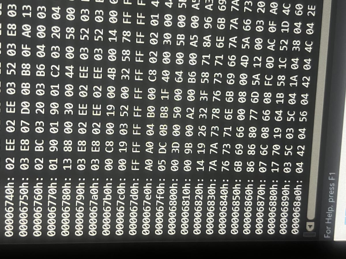

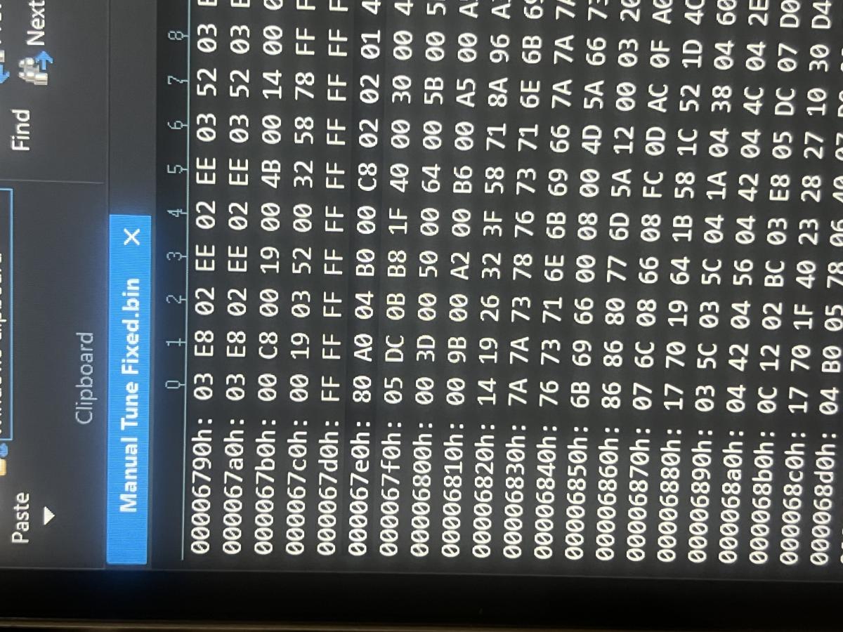

                                *SOLVED*
                                So turns out, the fault was with the manual swap coding and the fix was finding a thread by nextelbuddy . I wrongfully attributed the airbox/tune to this as I did the manual swap right around the same time. Also big shoutout to ugaexploder for showing how to get rid of $793, which was also present. Interestingly enough after getting rid of $793 it was stalling even with the AC off, which really drove me to find a solution. I also noticed this was mentioned in the Comprehensive Manual Swap DIY for US cars:
                                “US cars: Set K_MD_MIN_VERH_KRAFTS to 0xA0. It is located at 0x67E0 on 2801 (MSS54). It is located at 0x88A2 on 2701 (MSS54HP). Default value is 0x80 on US cars (Euro cars are already at 0xA0).”
                                In the latest version of ECU worx You have the option to choose clutch switch with GPS option or clutch switch direct wire and then you have a check box for GPS delete Those options work in general but they are not setting one additional option. Two cars that I flashed for SMG to 6 MT conversion. I've used ECUworx and both
                                0x67E0 was 80 instead of A0…no more stalling, we’re back in business boys ​​
