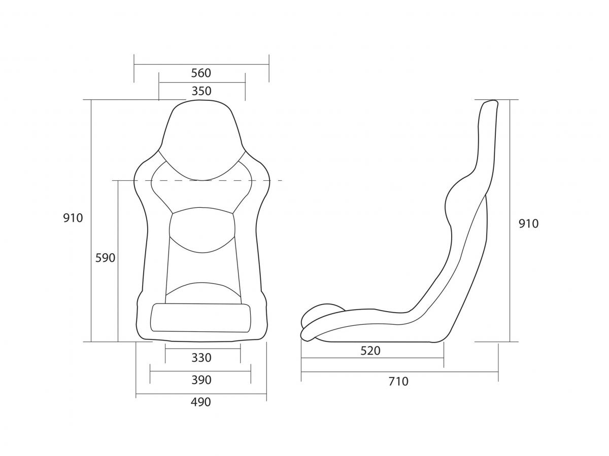

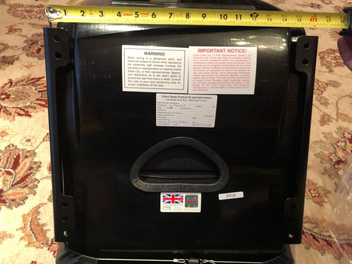

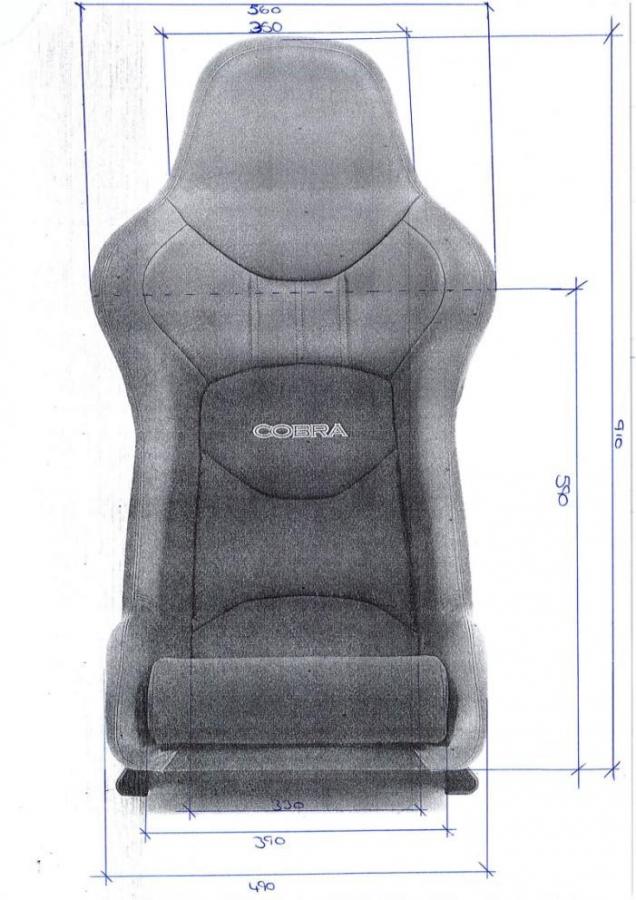

                                Does anyone know if you one can use Recaro Pole position seat mounts with the Nogaros?
                                is the mounting width the same?
                                it seems like it will, i cant confirm this as cobra is not clear with their dimensions.
                                Could someone please confirm the width of the mounting points? is it 390mm?
                                So far this is what i have found.
