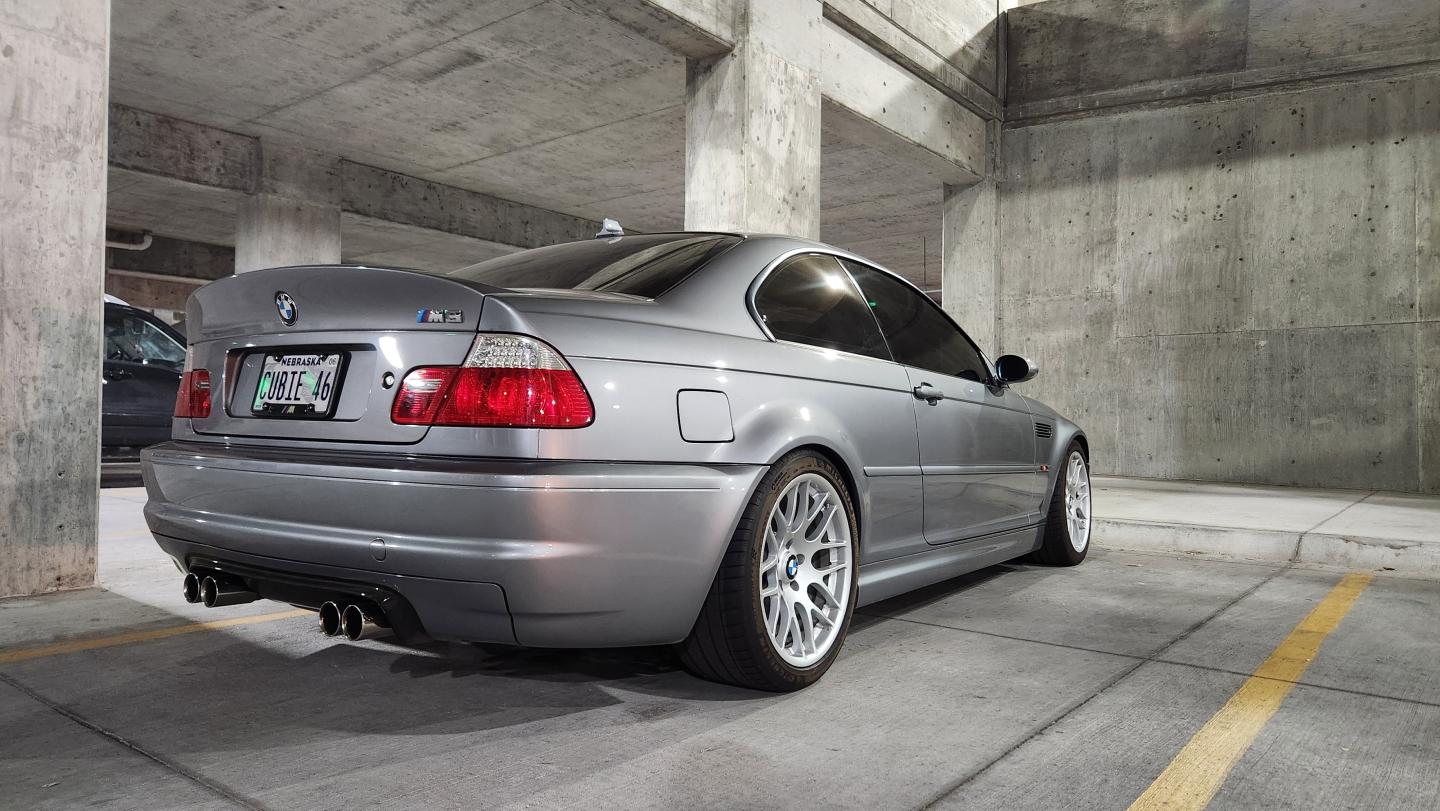

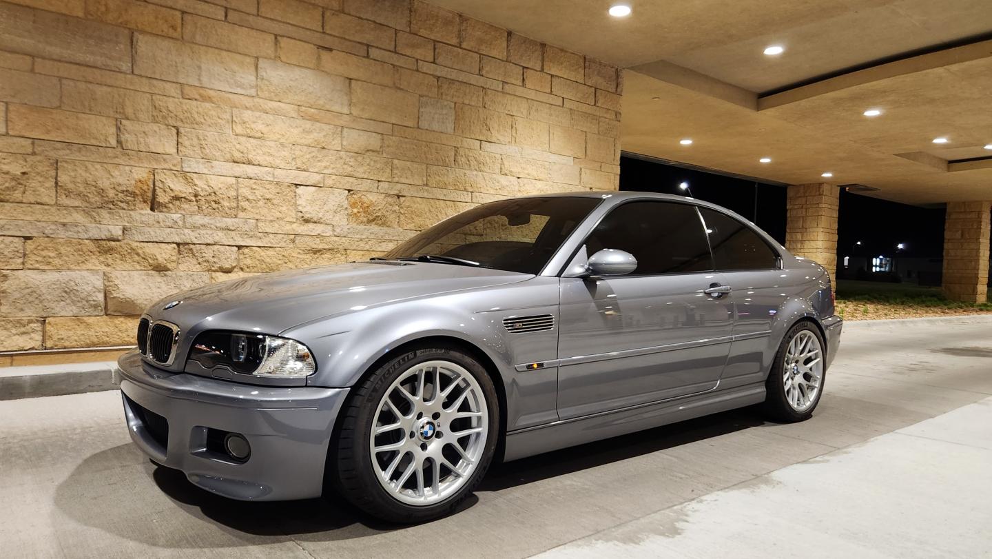

        Photos for reference, you can see how low it sits, particularly in the rear.

        Great looking car. It does sit nicely.

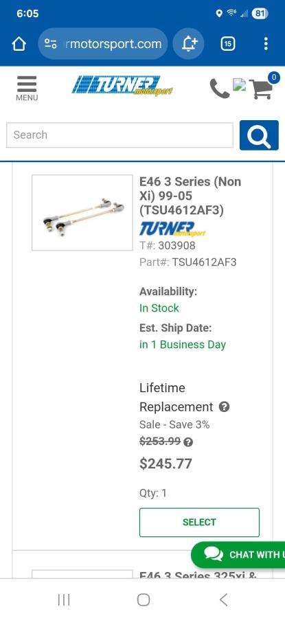

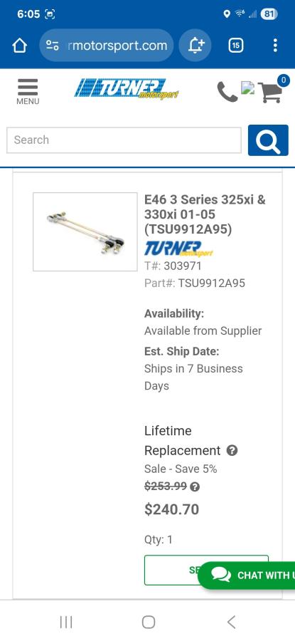

                          What endlinks would work with the TCK SA's?
                          I see bimmerworld has one for a stock height and MCS coilovers that is 247-273mm.
                            I used Turner # TMS339009​. Used them with both TCK DA's and the Eibachs I had on the car previously. They should work with the SA's.
                            Old, not obsolete.
                              Do you happen to know which out of this list you got? There are two for the E46 listed. I would assume it would be for the non AWD models.

                              ​​​​​​​https://www.turnermotorsport.com/p-3...s-pair/?pdk=Aw
                                This one. For some reason I cannot get the link to work.
