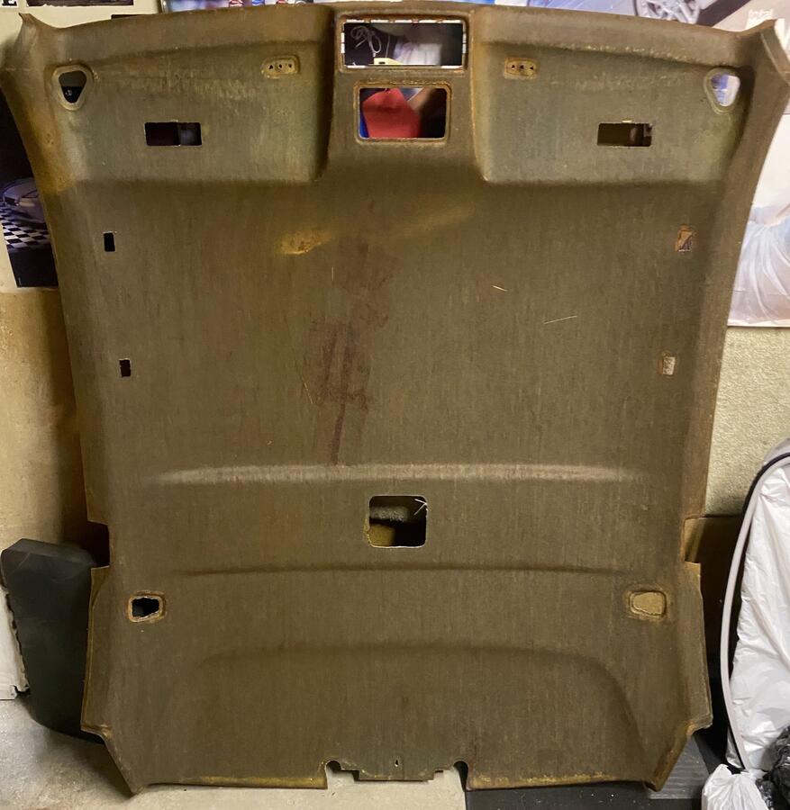

          Headliner is out, and nope respraying the original stock headliner anthracite cloth is not an option. The foam separates from cloth and is a layer of gunk that has to be scraped off. Unlike the A/B/C pillars which have a thin felt like material on the plastic between the unbacked cloth which is glued over it.

                                I have a factory slicktop. So the headliner is a bit more rare, and expensive as is the configuration (no sunroof). I baby this car but it was outside in unusual sun/heat while getting construction done on condo. To my dismay the stock headliner separated and needs to be re-glued. My first E46 in 2000 had a sunroof. I think perhaps non-sunroof headliners are closer to roof and thus get exposed to more heat, or maybe not.
                                My question is would you stick with the factory headliner, or go Alcantara since taking it out? I feel car value would actually go down with Alcantara vs stock on a slicktop. Interested in hearing thoughts of which to do? Thanks
