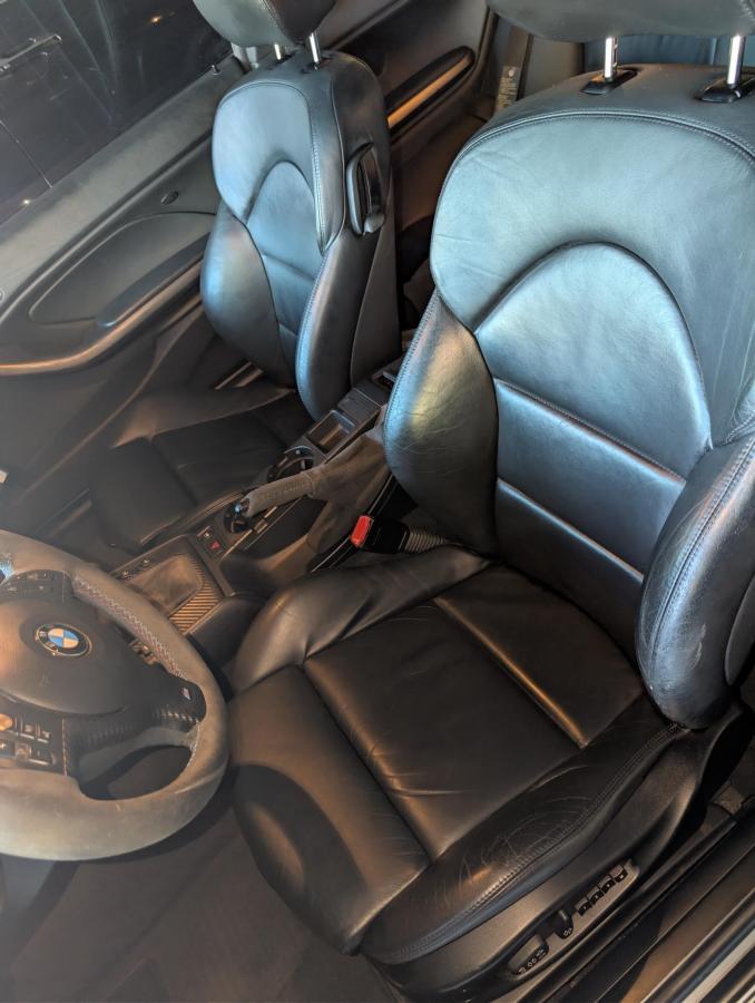

            I bought Leatherique a while ago, but didn't use it when i should've during the summer. We had a mini heatwave this week and took the opportunity to use it the first time. Initially after using 2nd step the cleaner the seat still felt oily, but after 24 hours it feels normal. I have some side bolster wear on the driver side, but it seemed to have darkened the wear area, so its less visible. I may need to do another treatment as the leather still feels a bit hard. My rear seats are still very soft feeling and matte looking as they are hardly ever used. Are the front seats supposed to feel the same way? I didn't treat the rear seats only did the front.

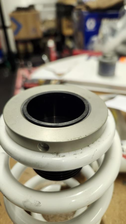

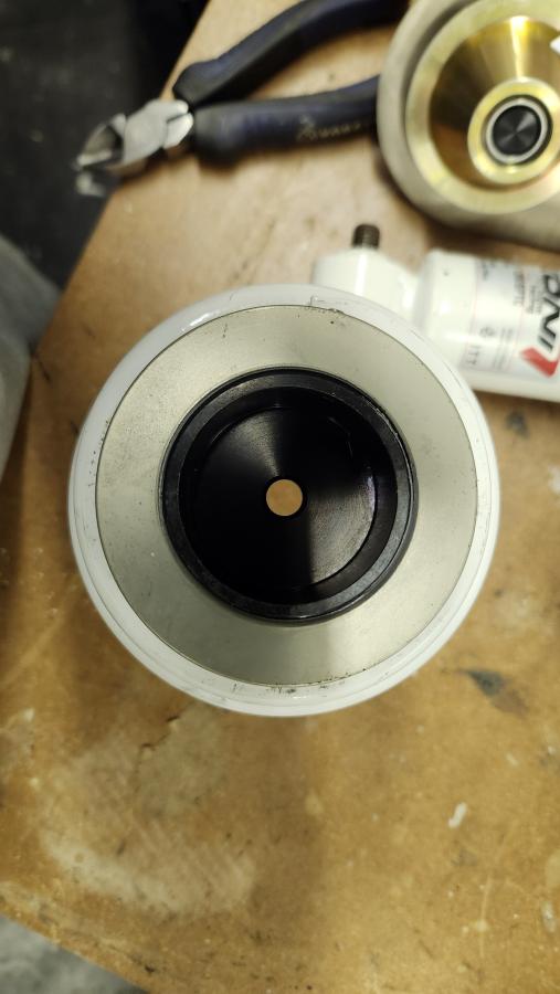

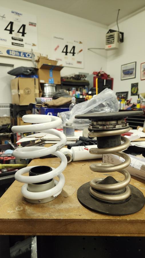

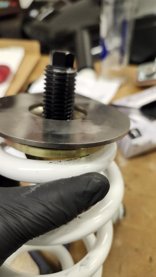

              Edit, another question..
              I am installing the TCK SA rear springs and the height adjusters are much smaller than flat area on the bottom of the springs, this seems odd.
              There is a ton of slop, I know this should disappear when the vehicle is on the ground, but still, why not make them the size of the spring?
              Also I bought some R.E articulating perches and they seem to seat even worse, especially is they are not centered perfectly. In addition, when the R.E perches are at their lowest setting the adjustment bolt is ~1mm from the axles.
              I may use the adjusters from TCK as they can go lower but adjusting them looks like a pain as they are sitting down on control arm with very little access.
              My BC's had the adjustment up top, that made things easier. Also they use both the lower and upper spring pads which the TCK's do not allow, somewhat disappointing.

                Looks like they're 2.25" spec rather than 60mm. You can find thin metal or evenhard plastic "donuts" or shims that will have the same ID (like 2.25") but then a wider OD like 2.5" which might put your mind at ease. Truth be told, you don't need the entire flat surface of the spring to make contact in order for enough contact to be maintained. But it would feel better wouldn't it?
                  I was puzzled when I installed a TCK setup on a friend's car many years ago. The only upside I could think of is that it will allow the spring to articulate a bit during the suspension travel. Sort of a cheap mans articulating spring perch that rogue and GC makes.
