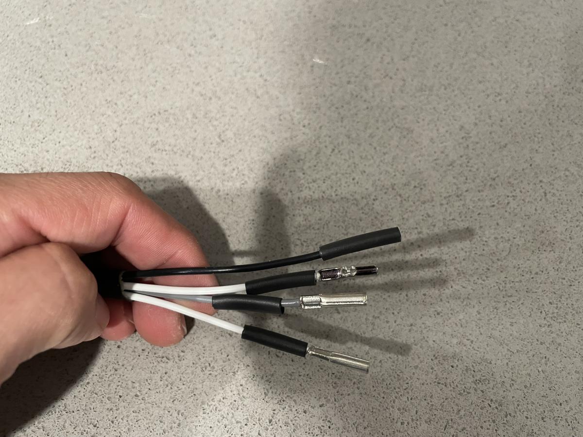

    Making a harness extension for the rear 02 sensors so I can route it under the beauty cover as per the factory
      I’ve been wanting to do this - I have all of the male and female connectors, just haven’t found a minute to get wiring. Do you have a cheat sheet on which wires you bought?
        No, I have not made one. But will do one as I splice them and join them.

          Yeah, I have a few sets of sensors I can pull the wiring from but wanted to find the wiring separate from cutting through a few O2 sensors… fun!

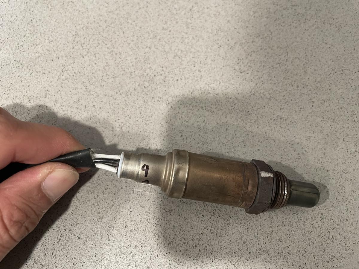

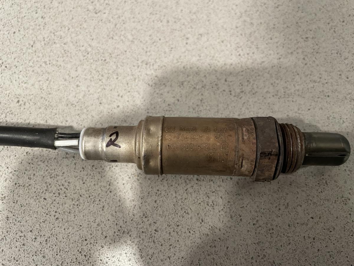

            I have traced the pins, the tricky ones are the white ones, but I am almost certain they don’t have any polarity, anyhow, this is how they are from the factory, the numbers below are the PIN numbers on the connector side
            1 - white wire. Heater element
            2 - white wire. Heater element. This lines up with the sensor part number on the sensor body
            3 - gray wire. This is the signal wire to the DME
            4 - black wire. This is the sensor element ground
            the white wires really just close the loop to the heater element which is nothing but a resistor, same in principle as a light bulb filament.
            I am basically making one sensor harness out of two, to join them I am using crimped terminals isolated with heat shrink tubes. To make it easier to myself I colored white wire for pin 1 with a black sharpie so I know which is which without having to removal the harness protective sleeve

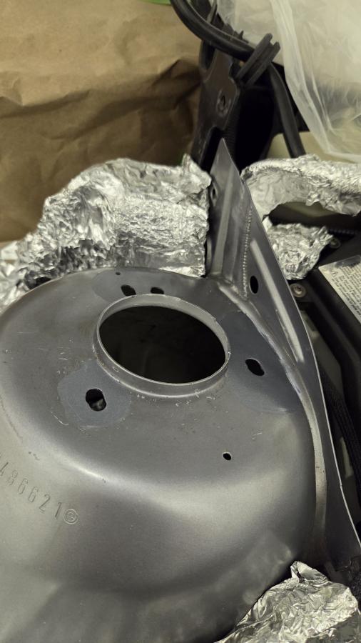

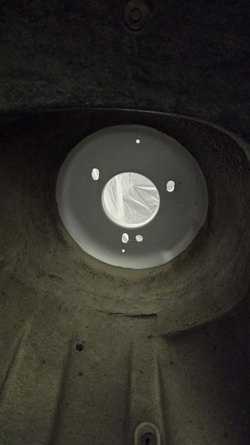

                      Finally unmasked my botched repaint over the repair areas on my strut towers, they were cracked.
                      I knew I should have just sprayed the entire tops, regardless of match just spraying 3 separate spots will always look off.
                      On the underside I used self etch primer, and POR-15 over it, I can already tell that won't last, I should have used 2k epoxy like I did up top, superior rust protection.
                      Oh well, I can always have it done professionally later and now I can get the car put back together.

                        You're good man, enjoy the car for a bit. It's not a show car Besides once you get everything back together it won't be as noticeable if at all from what I can see.
