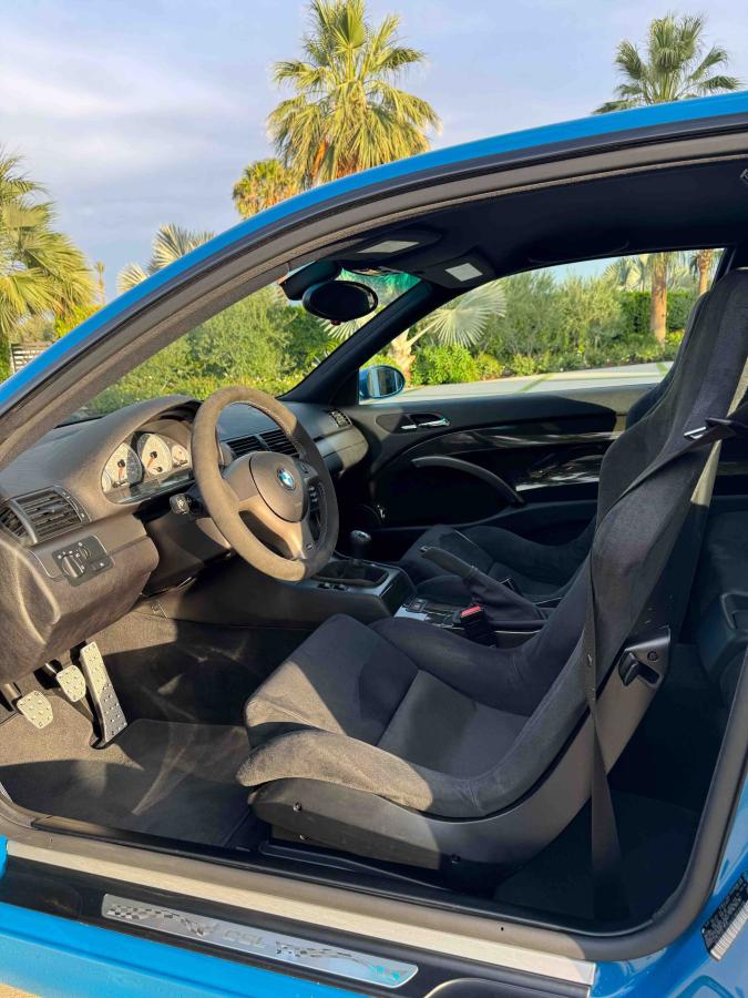

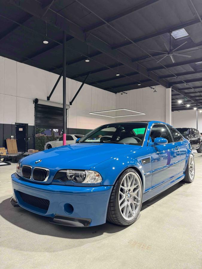

                Finally got my front seats finished to complete the interior...also some new rare kicks!
                Long story short...I was able to source a complete ZHP coupe alcantara/laser cloth interior and extra rear seats for additional fabric. I ripped the center cloth fabric off the seats and used them to reupholster the Recaro PPs. The Laser cloth (G7AT) material appears to be the exact same as found on the M3 CSL labeled ADAT - Anthracite Reflex cloth which I thought was interesting.
                Recaro Pole Position Carbon ABE w/ Anthracite Alcantara and Laser Cloth (G7AT) and a very rare set of 18" BBS FI wheels:

                  I think you have a problem with wheels. Let me help you , I will buy one set of E88 so you have extra space in the garage

                            That CSL interior is drool worthy !
                            It's only missing the SMG to be complete
