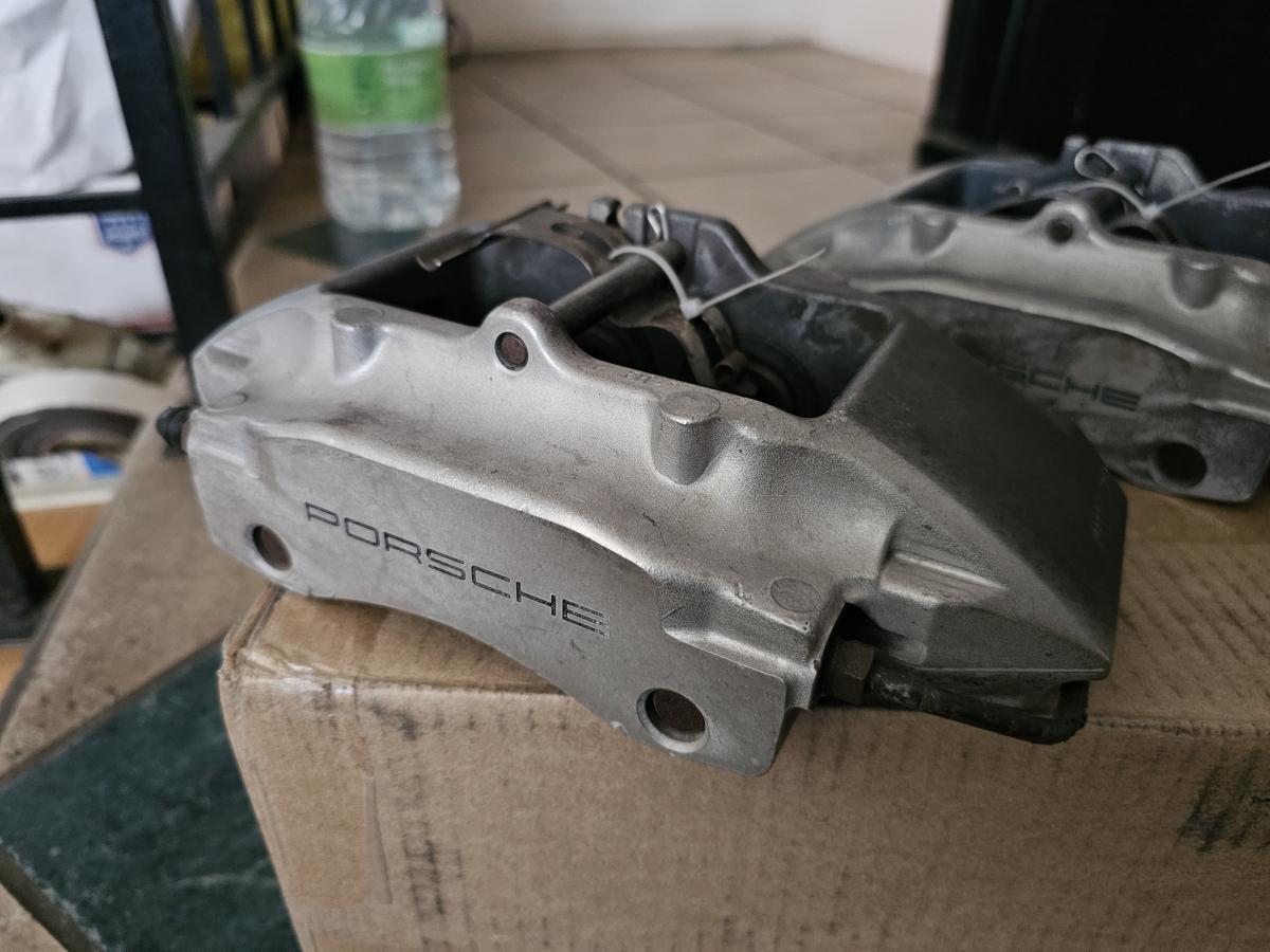

                    Inspected the parts I bought for it.
                    Freaky Parts front Brembos:
                    Porsche 996 rear Brembos:
ID:	325120 Click image for larger version
ID:	325121 Click image for larger version

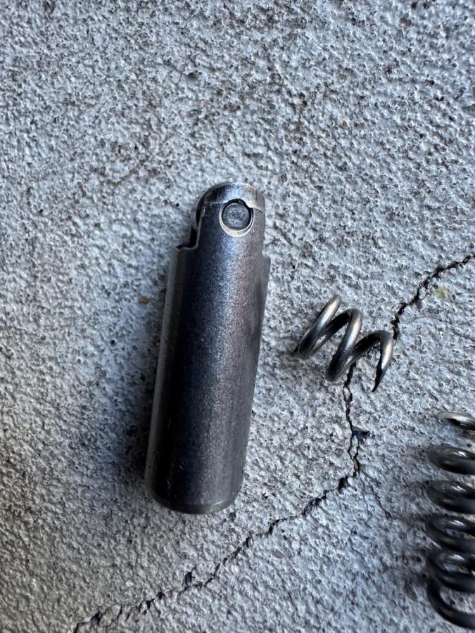

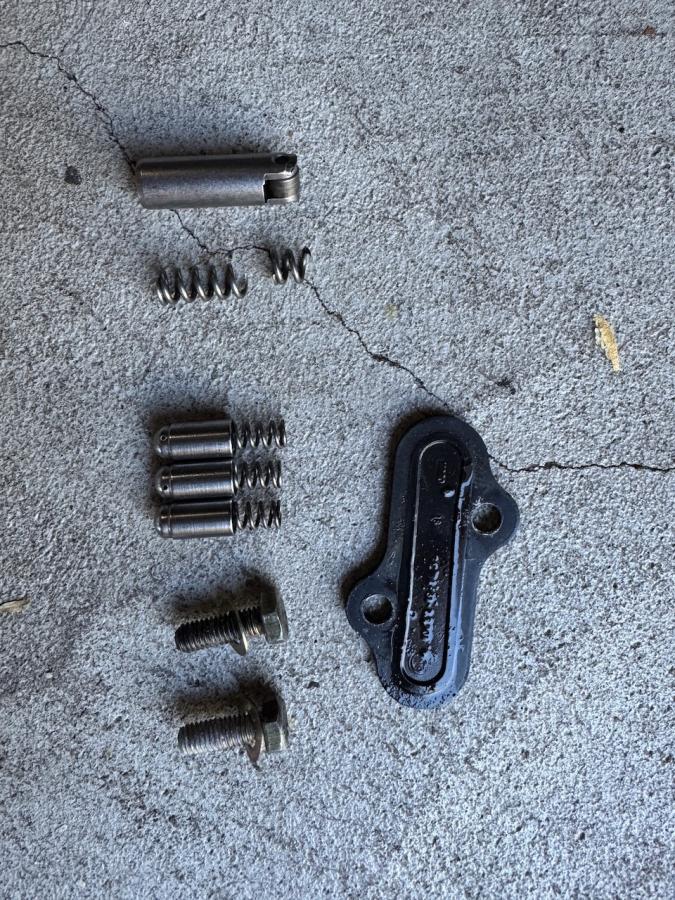

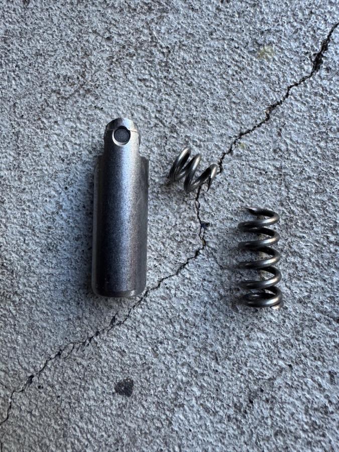

                        Replaced detents on top of the transmission, roller with a spring on the side behind the GPS, and shifter rod seal. Guess I now know why the shifter was popping out intermittently 😂😂 The shifting feel is much tighter now than before.

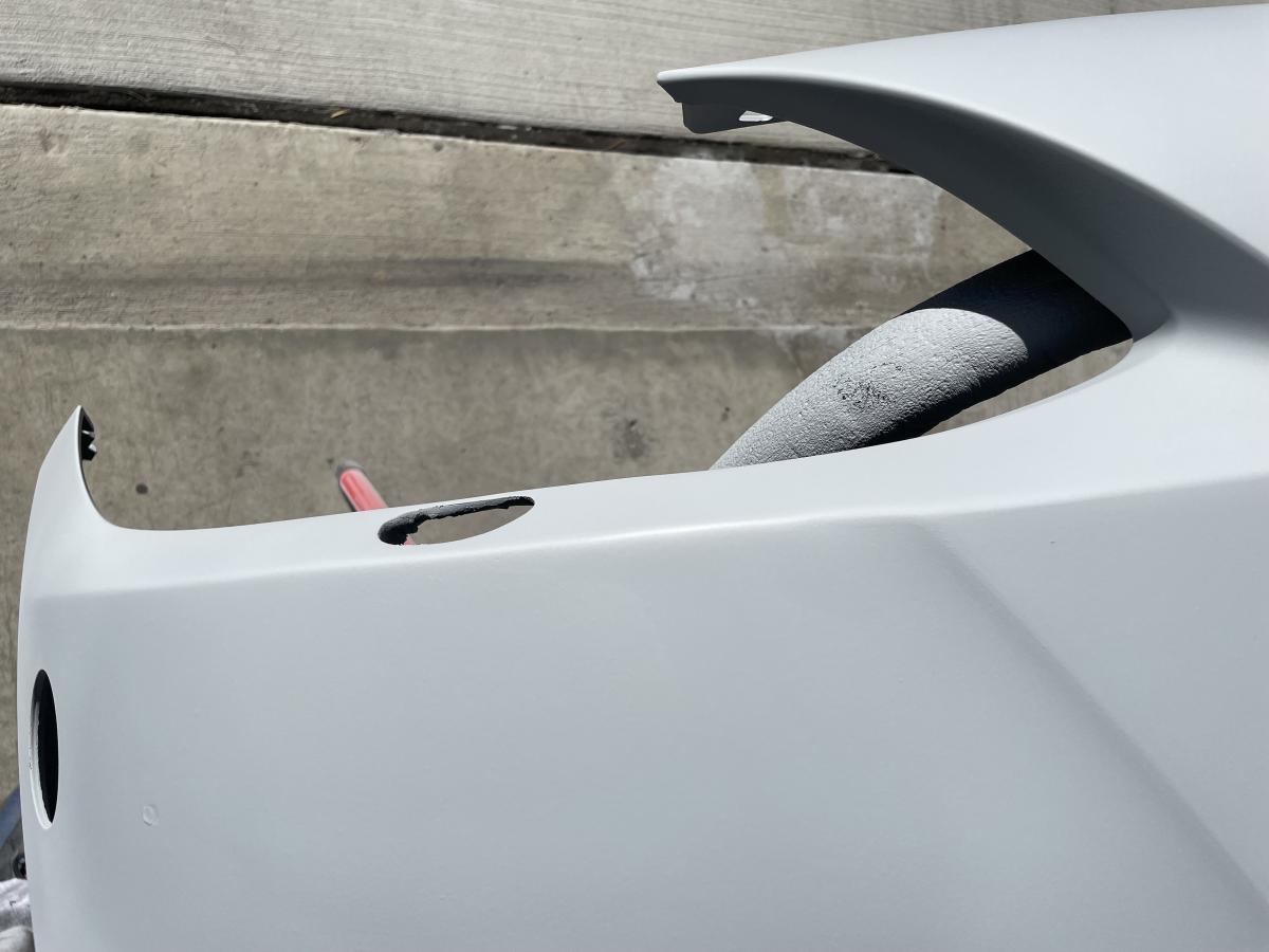

                            Made some progress. I applied the primer, I mixed it as a surfacer. Came out good with very few dust particles. Not concerned at this point as it needs to be sanded to make it flat. The area I repaired came out ok. Not perfect, but I think I can level the primer just enough to make it invisible once colored and cleared

                            Sanded the primer on the repaired area and super happy with the result, I cannot tell where the damage was. I just need to finesse the edge, it may not be perfect but for the untrained eye, nothing happened there

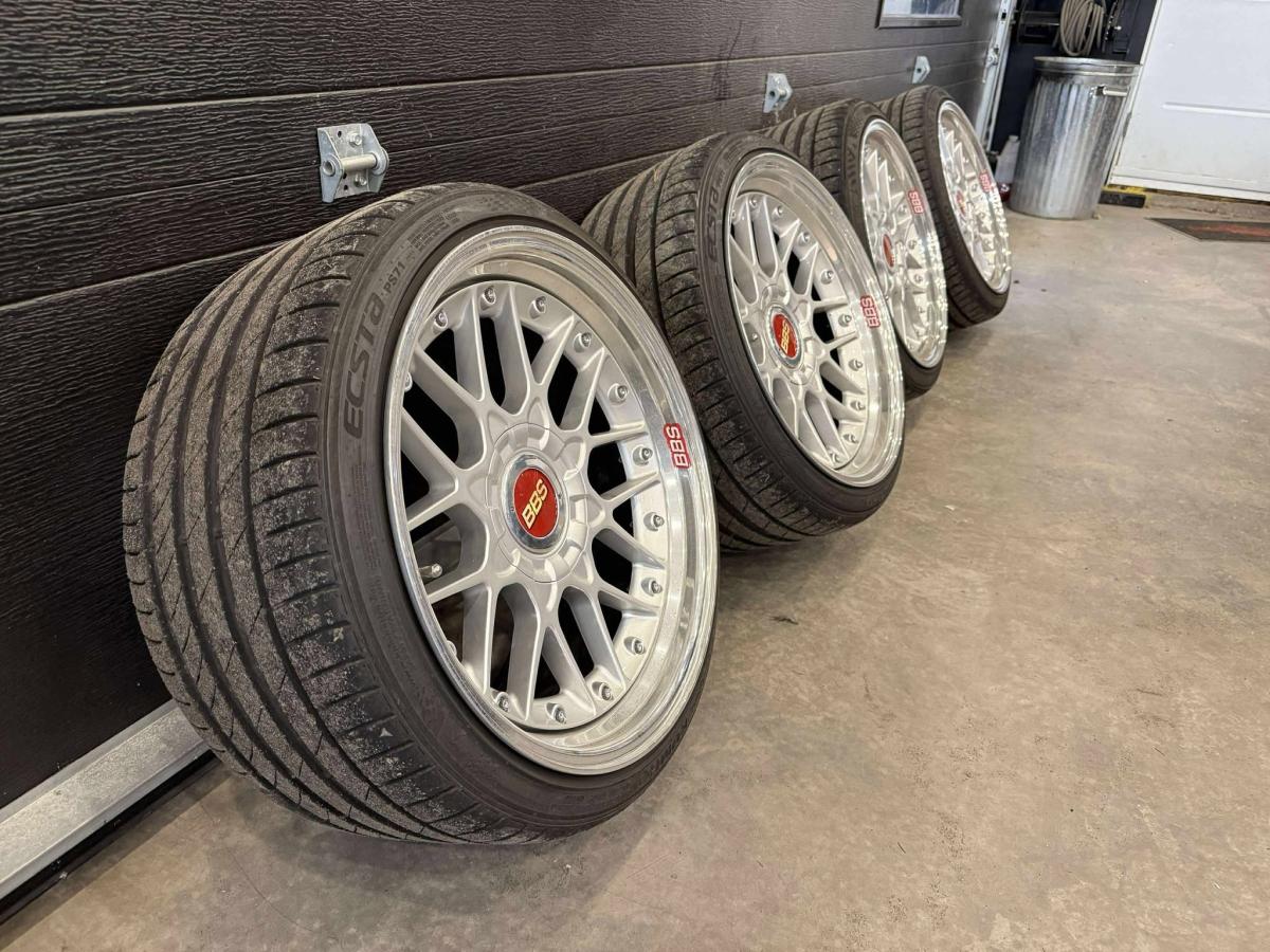

                              I found a local set of BBS RSII. Will be polising them, installing PS4S tires and waiting to find a clean E46 M3
                              Instagram : @gc.m3sg
