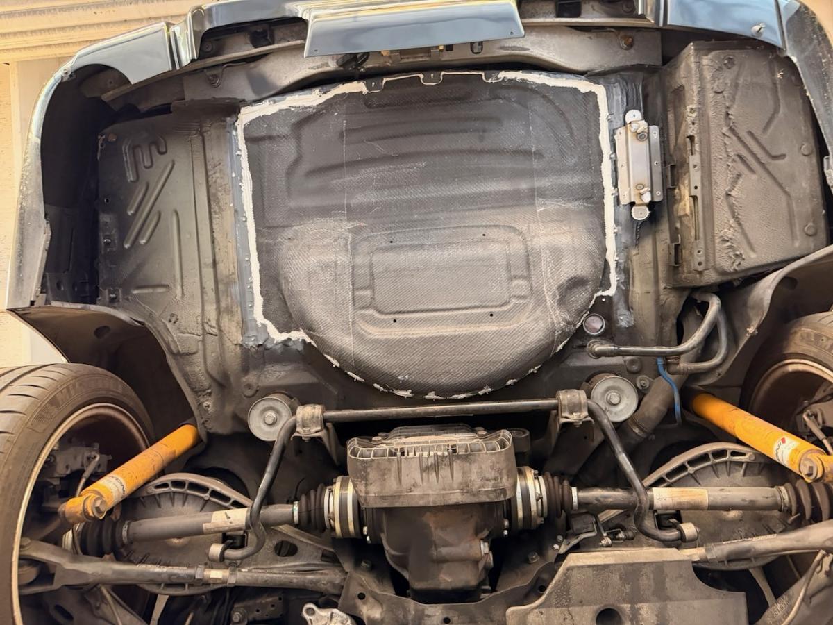

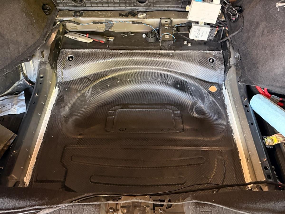

    If you're up for it, bigjae46 has a mold and can make carbon trunk floors as well @ 3.5lb
    My car is the guinea pig:
    Click image for larger version  Name:	IMG_0161.jpg Views:	95 Size:	169.6 KB ID:	367089
    Click image for larger version  Name:	IMG_0148.jpg Views:	97 Size:	168.2 KB ID:	367088
    you guys keep hurting my wallet smh (just ordered some E86 brace parts from bigjae46 and printing your fender braces). What's the weight savings on this (my vert needs to lose every pound possible)?
      Ha, about 12lbs. Maybe a little less on an M3 since the trunk doesn't have a spare tub. It's a good deal of effort to be sure though!

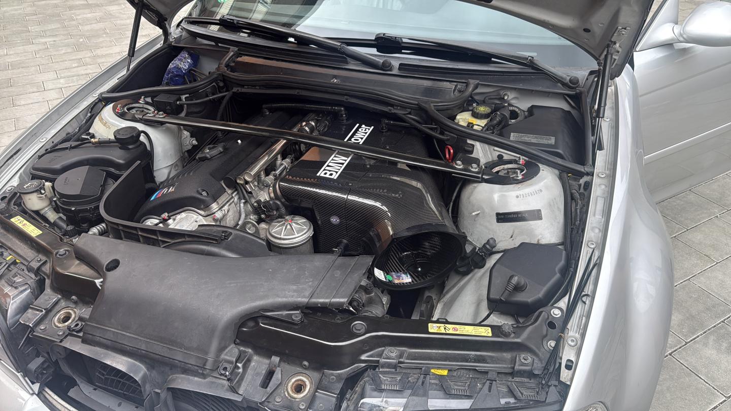

                        Installed a CSL Airbox 😅
                        Also finished installing euro headers
                        Pics?
                          Originally posted by 332 View Post
                          Pics?
                          😄 still printing the snorkel. Takes about 18 Hours. Managed to find Euro cats after much searching. Limited even in Germany 😅

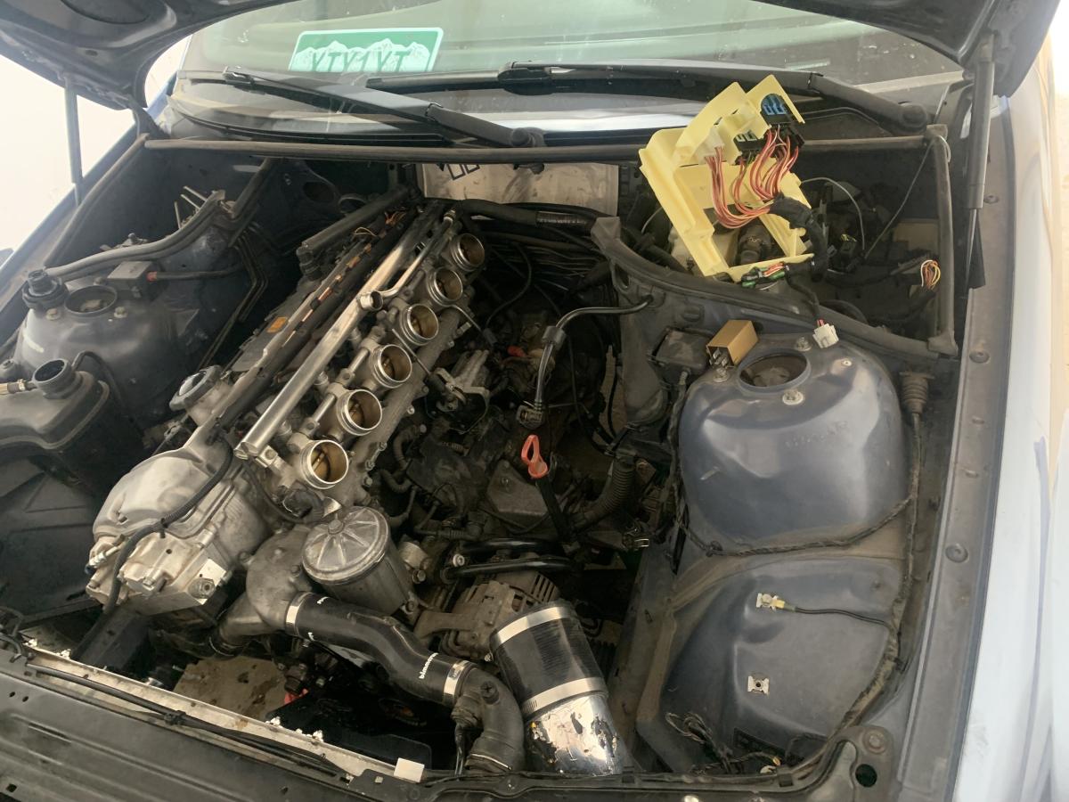

                            Nice, I've been doing some major surgery on mine.
