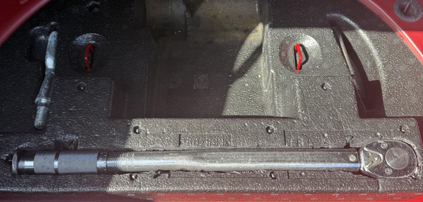

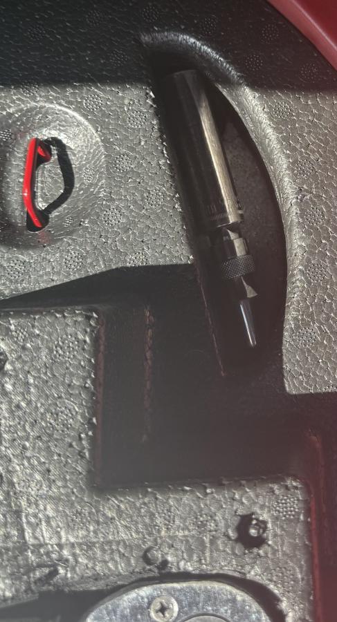

ID:	366772 I know it doesn't look like much but needed to carry a torque wrench without the entire tool box and a special deep socket as I am on wheel studs and locks.
          Carved the existing foam and my wrench is secure without taking up any extra space. You can do this for a breaker bar as well. etc...​

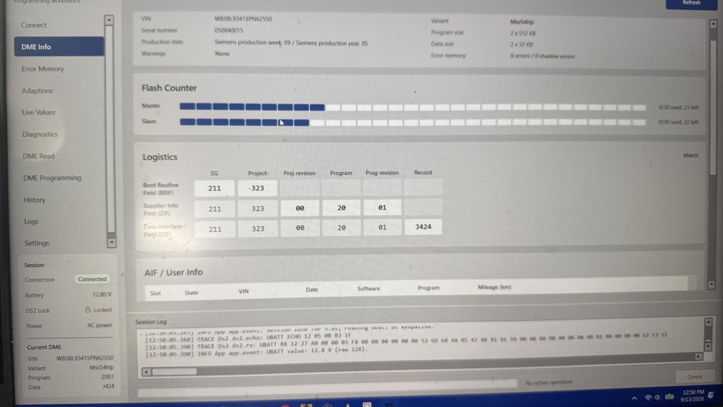

                  Since I now have euro headers and section 1 I installed the euro program/tune 211323002001J424 .
                  1. Get the MSS54 DS2 Tool https://nam3forum.com/forums/forum/m...sh-counter-etc
                  2. Go to "DME Read" in the app.
                  3. Back up the Tune
                  4. Back up the program
                  5. Make sure your battery is charged and stable. I recommend power supply mode on a charger if you have one.
                  6. Download the Program "Full 211323002001J424.bin" from https://github.com/saildot4k/MSS54-X...20Full/MSS54HP
                  7. Download the Tune "211323002001J424 (EU3 6MT).bin" from https://github.com/saildot4k/MSS54-X...MSS54HP%20Bins
                  8. Go to "DME Programming" in the app.
                  9. Under "write program" select the "Full 211323002001J424.bin" you just downloaded and click "write program".
                  10. At completion I received an error message "program control: 'finalize programming' returned verify byte 0x0E. program and data references do not match'. I ignored this, perhaps because tune is not yet loaded.
                  11. I exited and restarted DS2
                  12. Go to "DME Programming" and under "write tune" select "211323002001J424 (EU3 6MT).bin" that you previously downloaded. Click "write tune".
                  13. You're done. You can check your version under "DME Info". Big thanks to karter16 and his helpers for creating this.

                    Thanks for posting the detailed steps! Would be interesting to see what your impressions are before and after the updated program/tune.

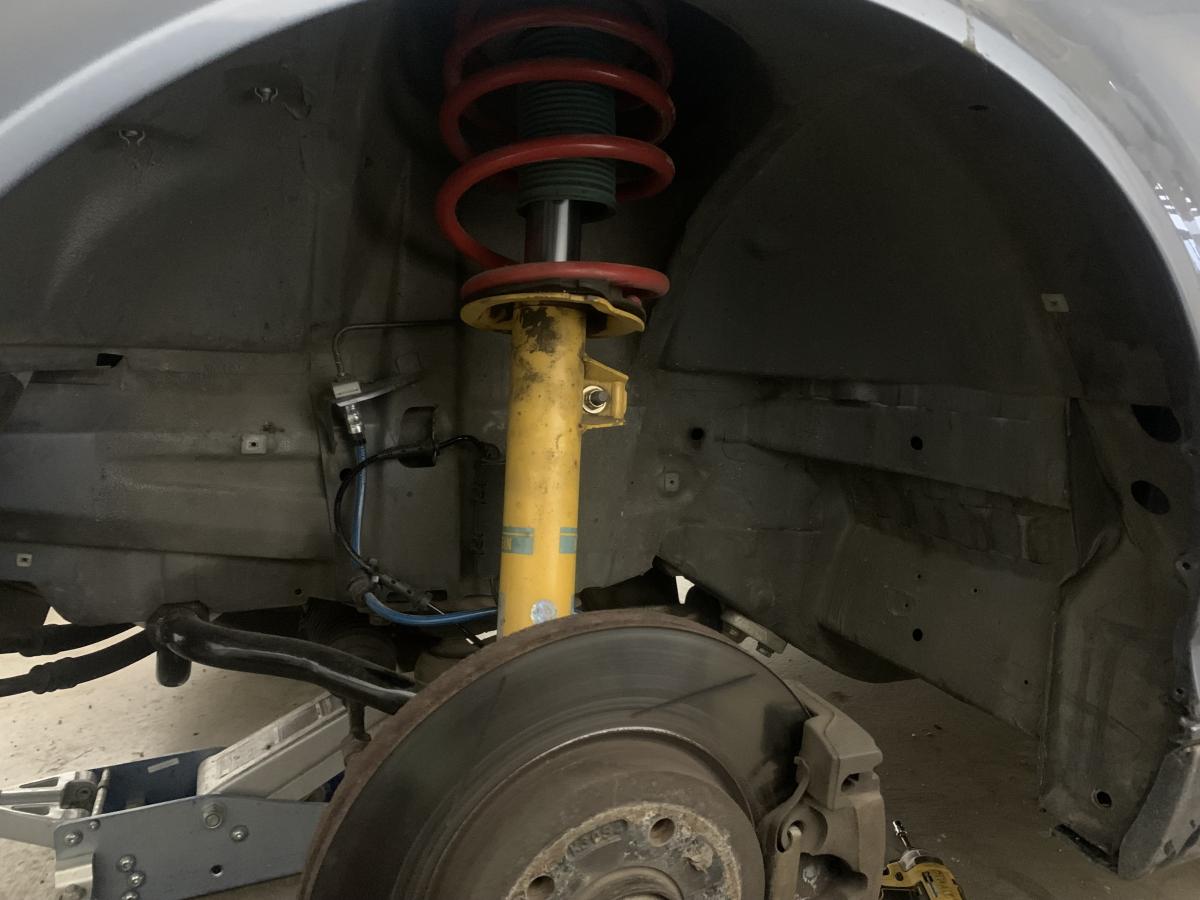

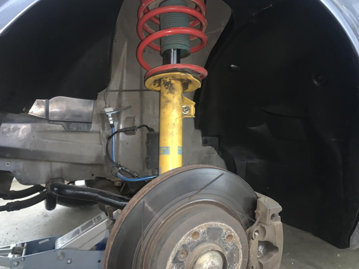

                      New inner fender liners for the sedan!! New pads, rotors next. I used 330I front brakes for my swap b/c the rotors are the same size but lighter.
                        After driving the car for a few days I can say the differences are very subtle, nothing dramatic. The butt dyno can feel a little more pep, but again its super subtle. I'm euro headers, euro section 1, stock section 2, and stock suitcase muffler. I can also say its perhaps a little smoother through the RPM range after application of the euro tune.
                        I do like the rasp better under the euro setup but that is subjective.

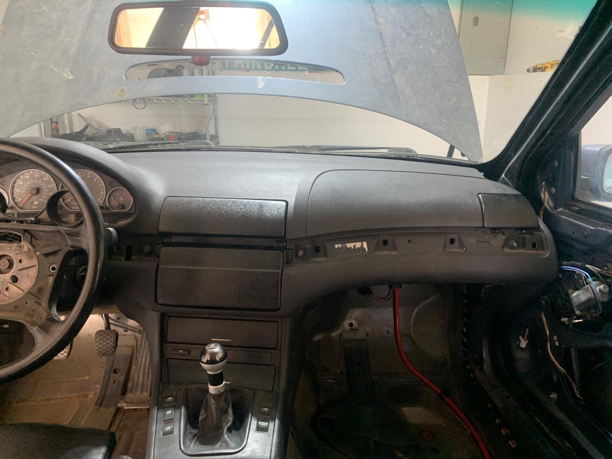

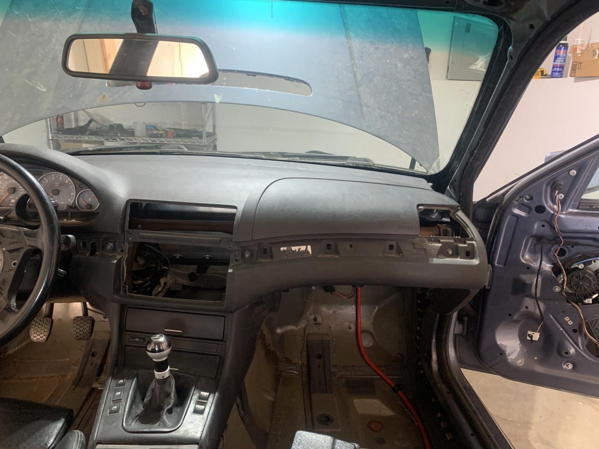

                          Click image for larger version  Name:	IMG_1994[1].jpg Views:	0 Size:	122.3 KB ID:	367082 Click image for larger version  Name:	IMG_1995[1].jpg Views:	0 Size:	115.9 KB ID:	367083
                          Got the HARD motorsport E46 Dash block off panels installed today.

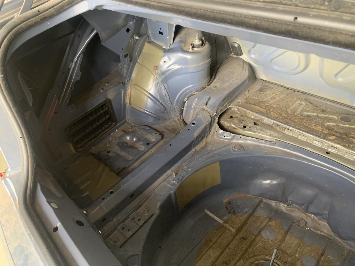

                          Click image for larger version  Name:	IMG_1997[1].jpg Views:	0 Size:	103.2 KB ID:	367084 Click image for larger version  Name:	IMG_1999[1].jpg Views:	0 Size:	119.0 KB ID:	367085

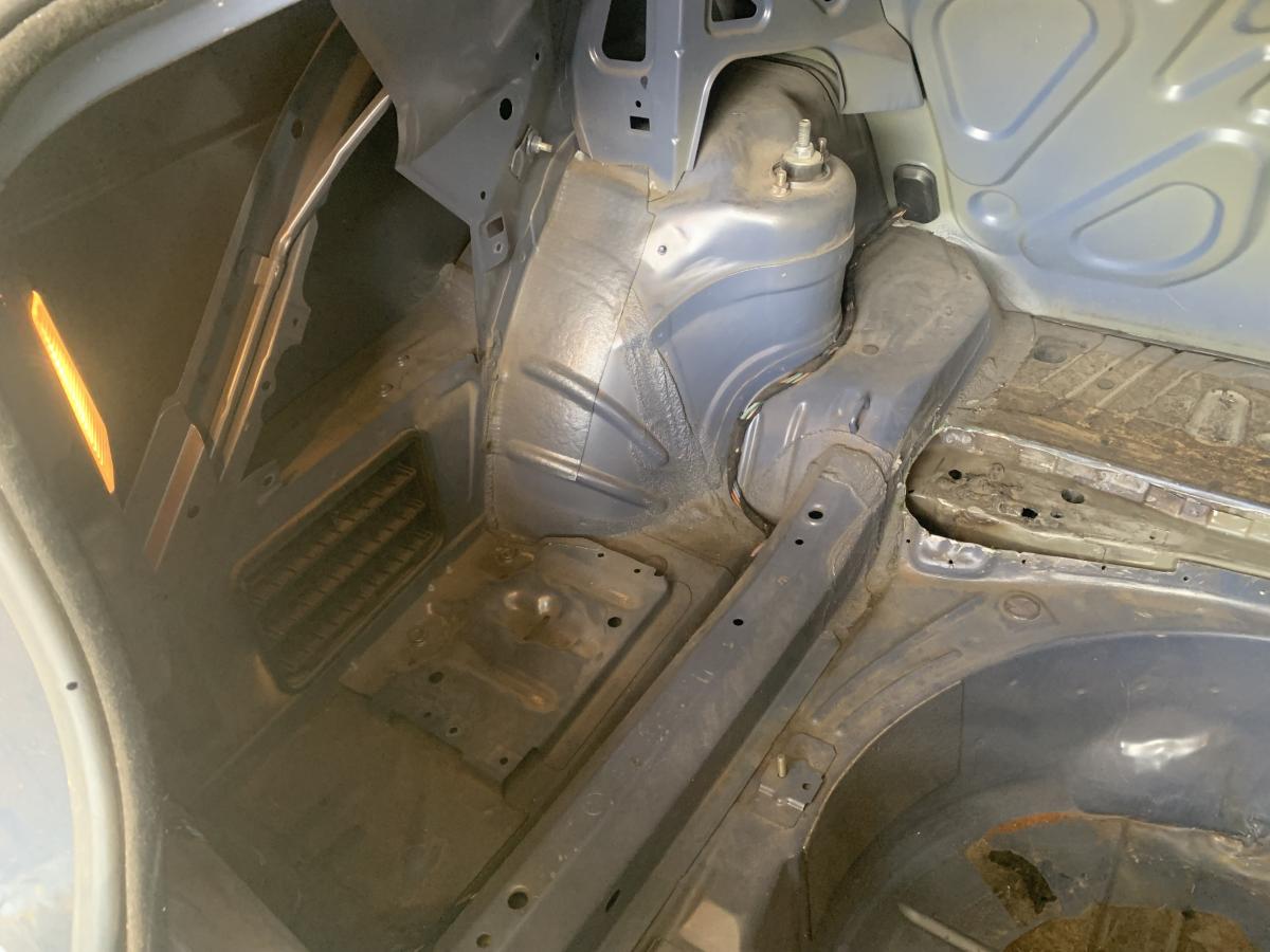

                          Removed the last bit of the sound deadening from the trunk area, to prep it for Turtle Labs spare tire well and battery delete. (sedan) Heat gun, acetone is the way! If you are curious why the spare tire well is smashed in, I had to clearance it to fit Hotckhis sway bars. Stock M3 bars will clear the spare tire well, Hotchkis wont!

                              Maybe if it was a flat drop in panel, I don't need the impression. The Turtle Lab aluminum panel is 3lbs @ $115, that is pretty hard to beat.
