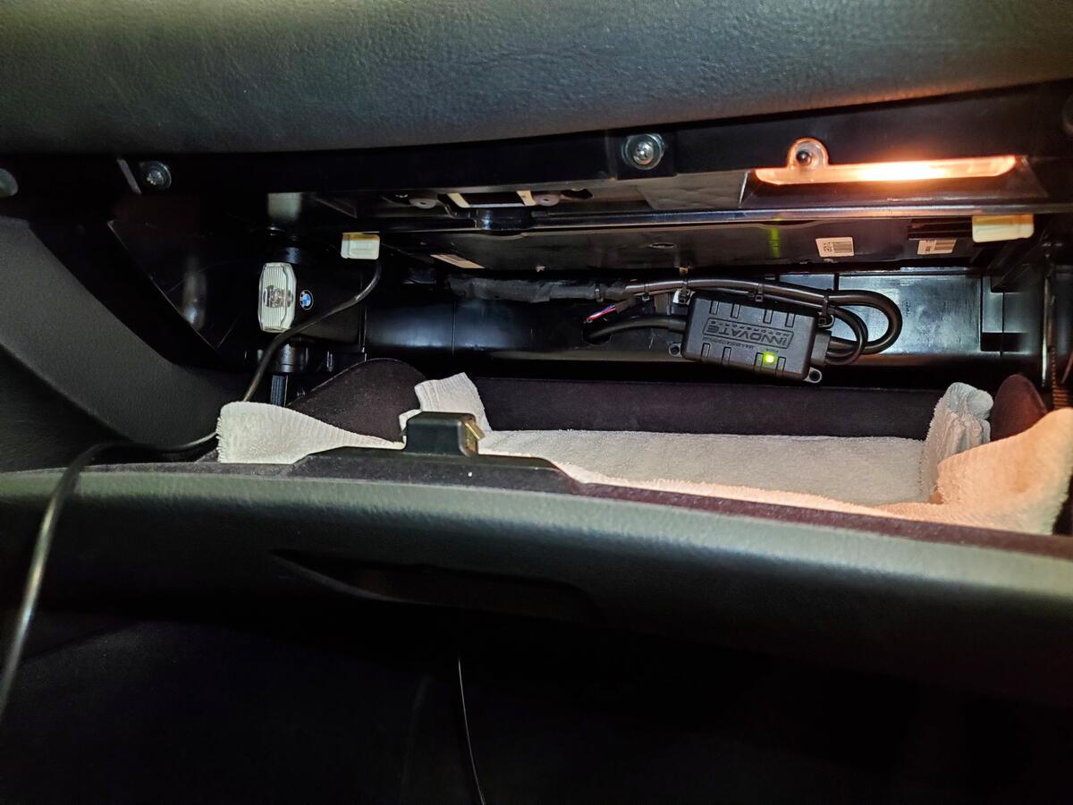

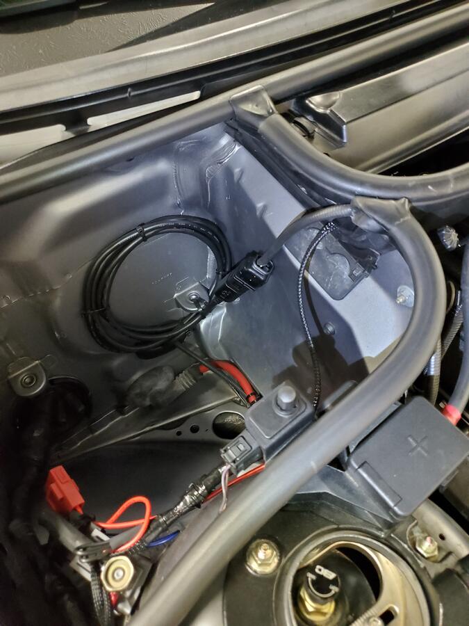

                            Installed an "Innovate LC2" wideband O2 sensor, used switched/fused 12v power and ground from pins 6 & 7 found under the center console from the telephone connector. This was handy as all that need to be removed was the cupholder/coin holder.
                            Tried my best to make it as clean as possible, the module is located in my glove box which is nice as there is a status light you can check easily.

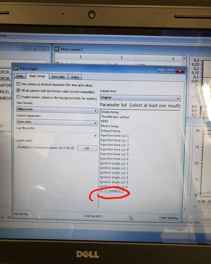

                            I just bought a serial to USB adapter and can now read real-time AFR in Testo now I just need to find out how to record or log the AFR alongside other information.
                            So far I can view/log AFR on its own or view/log other "main" info (from OBD) on it's own but cannot combine or sync AFR with "main" info into one cohesive log file.
                            EDIT: Got it, time to log some data..
