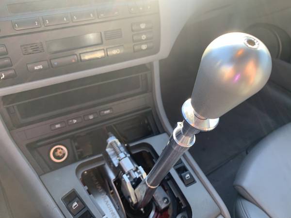

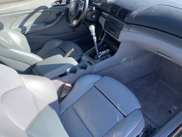

      The CAE shifter is chassis mounted and should be fairly easy to remove, but you may just like it enough to keep it. It's a bit like a fine bolt-action rifle when shifting with the CAE.

        This. It's possible that the car with the CAE shifter was originally SMG. That shifter has its own detents, which makes it so you don't have to machine the trans bell housing. If this is the case, then replacing the shifter with OEM would require that you also drop the trans, machine the bell housing and add the detent springs and related parts.

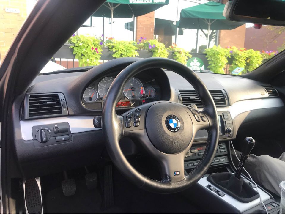

          The RTD car has an SMG cluster and the picture of the CAE looks to have a manual cluster. That leads me to believe you wouldn't be able to remove the RTD without pulling the transmission and finishing the SMG swap.
            Good eye. The RTD car would need a good amount of work to go to an OEM shifter. Also based on the link you posted in the craigslist thread MTiz , the CAE car is probably a factory manual since it's got a manual plenum. That one should be much easier to swap out.

                            You can juuuuust barely make out that the gear position indicator is still present, although the lights are disabled. With the SMG swap and self-centering shifter it's a high possibility that the bellhousing has not been modified to accept the self-centering spring
