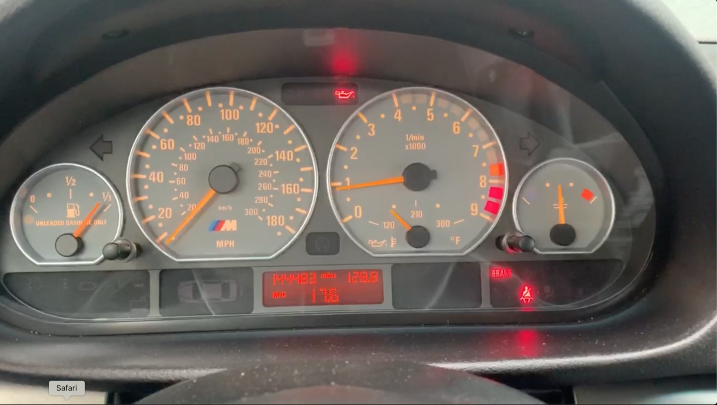

Name:	Screen Shot 2021-02-08 at 1.26.56 PM.png
                            Figured I'd go ahead and update this thread. Got the car back on Saturday after paying for rod bearings a second time (proper clearance ACL bearings), and all the associated gaskets. Shoutout to FCP Euro for getting me all the parts within two days. My Indy thoroughly inspected my oil pump and it looked mint according to him. Put about 120 miles on the car that day, and the next morning (yesterday) the low-pressure light came on after the car fully warmed up.
                            Same symptoms as before, only comes on at idle. Not sure what to do at this point.
                            2018 BMW ///M3

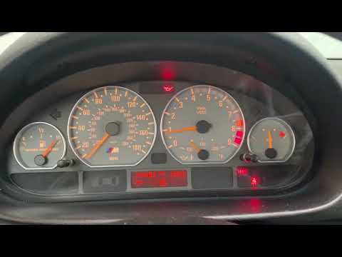

                              Uploaded a video for reference
                              2018 BMW ///M3

                                Damn, sucks that you had to pay for this twice and the issue hasn't gone away (hey, at least you got welcomed to the spendy part of m ownership). You mentioned a thorough inspection of the oil pump, but did you have the pickup tube o-ring replaced?
                                If yes, then maybe this is a sensor issue? I would suggest actually measuring oil pressure with a good old gauge before throwing any more money/parts at the car.
