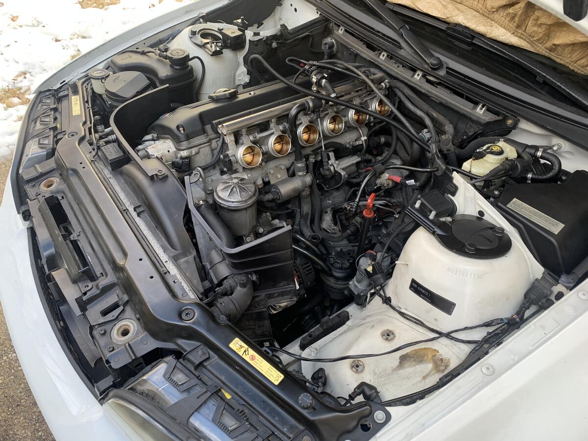

      Took the airbox off to fully open up the oil filter housing and only managed to break one small piece of plastic along the way. Don't have the pressure switch off as of yet because none of my wrenches are big enough, have to get a 24mm one (correct me on this if I'm wrong please).
      Big question-- once I hook my mechanical gauge up to the car, do I have to put everything back together? Airbox, intake, MAF, filters, all the hoses, etc etc? In my mind it doesn't make sense to put everything back together only to have to take it apart again just to take the gauge back off. What needs to be plugged back in and what can I leave off for the time being?

        Car will trip out without the MAF. I would just position everything back without bolts or hose clamps or anything and plug in the MAF.
        Edit: oh and the starter cable, car won't start without that. I've made that mistake before and wasted a bunch of time troubleshooting.

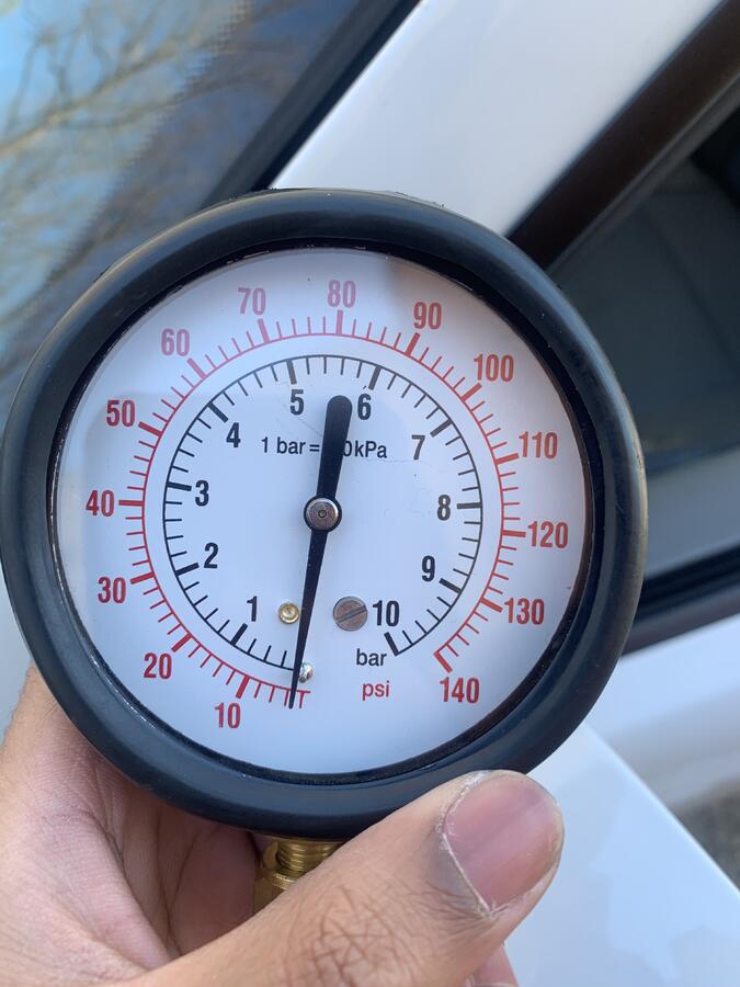

          Sure enough, the pressure is below spec once it fully warms up. Should be sitting at 7-8psi. What does this mean? Bad oil pump? Arehman is having the same issue with his car and it didn't go away after a new oil pump was installed.

            #80
            Does any pressure register on the gauge when the engine RPMs are increased?
              #81
              Yes, the pressure moved up as RPM's increased. I took a video of the gauge moving up and down with the RPM's: https://www.youtube.com/watch?v=72pj...ature=youtu.be

                I know this is a pain to deal with, but I would go back to the shop with this video.
                It's possible that this is all a huge coincidence and your pump decided to let go at exactly the same time that your rod bearings were replaced. Highly unlikely, but whatever, it's possible.
                The big issue I see is that the shop told you that they verified the oil pressure themselves and made sure everything was within spec. You've clearly just demonstrated that that's not true, so how do you know that everything else they said they did was done correctly? Did they actually inspect the pump and replace the o ring? Don't want to imply that the shop is incompetent, but in my mind the issue was clearly caused by the rod bearing work.
                As for technical advice, I wouldn't drive the car until this is taken care of. You've verified that the engine isn't circulating oil properly and this can ultimately lead to some pretty serious damage. I don't have first-hand experience with this, so I can only take some blind guesses as to what the issue is. Checking the pump, o-rings, pickup tubes, oil passageways, etc is what I would do next.

                  Very nice. Remarkable its so low that the gauge doesn't register any pressure. Next course of action, mechanically, is beyond my paygrade.

                    "The big issue I see is that the shop told you that they verified the oil pressure themselves and made sure everything was within spec. You've clearly just demonstrated that that's not true, so how do you know that everything else they said they did was done correctly?"
                    +1. I bet the pump is fine but the mechanic messed up the connection when removed/installed the plumbing.
                    OP, at 2000 rpm and only 10 psi pressure is too low. There is a big leak on the plumbing somewhere in the oil pan and they lied to you on the pressure test. I hate to pay the pros and got this kind of result.
