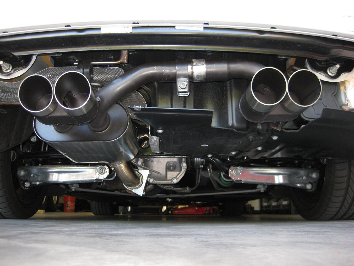

      Here’s some pics of the oem exhaust with the euro tips. I hope he doesn’t mind me using the pics he sent me originally.
      Hey George, I know what you mean about looking forward to installing the stock exhaust. I went through quite a few aftermarket and wanted to go back to stock but needed to do something about the tips. I couldn't believe how quiet the stock exhaust is. Looking forward to your impressions after it's installed. I did go back to the dark side though
