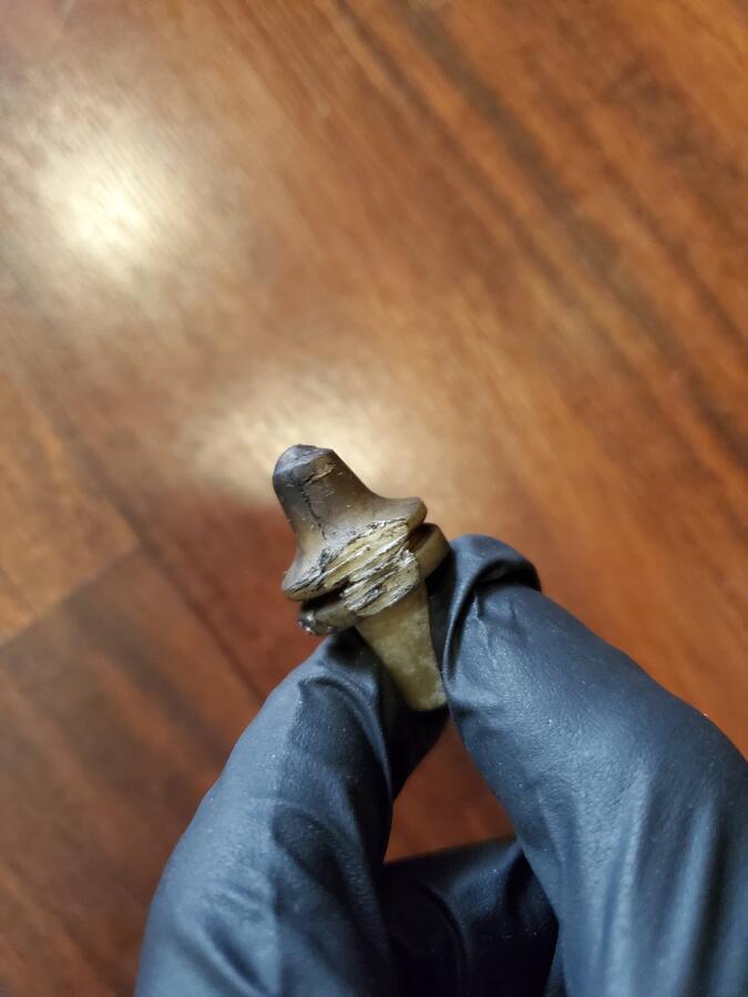

            Rented some shop space to replace clutch, flywheel, and other transmission parts. I can't imagine doing this on jack stands and commend those who do. Ended up spending 12.2 hours without breaks, but got everything done in a day. The thing I spent the longest on was getting the transmission out. I put it on the transmission jack but apparently didn't tie it down tight enough. This let the trans rotate and get stuck on the trans tunnel. Took me about an hour to straighten it back up and pull it out.
            I had originally planned to replace all transmission seals, detents and the rear main seal. Ended up just replacing the shift selector rod seal. I've had bad experiences with radial seals before, so I also decided against doing the rear main seal, since it looked totally fine. Hopefully I don't regret this decision. I did replace all detents, except for those inside the bell housing, since I couldn't find a way to get the detent caps out without removing the bell housing.

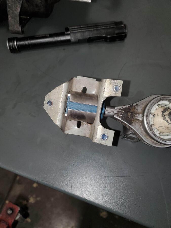

            Plastic pivot pin looked fine for ~121k mi. Some mushrooming was present, but hadn't failed (those marks on the side are from the vise grips I used to pull it out).

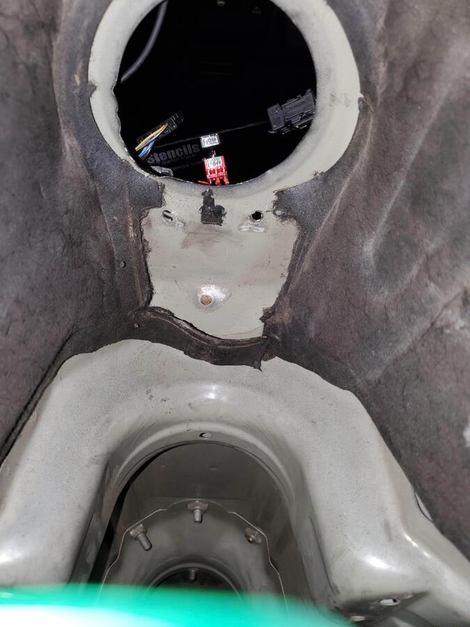

            Also found that my shifter bushing carrier had ripped out of the transmission tunnel. No clue if this was was due to having a poly bushing in or due to me being too aggressive when installing my shift knob in the past.

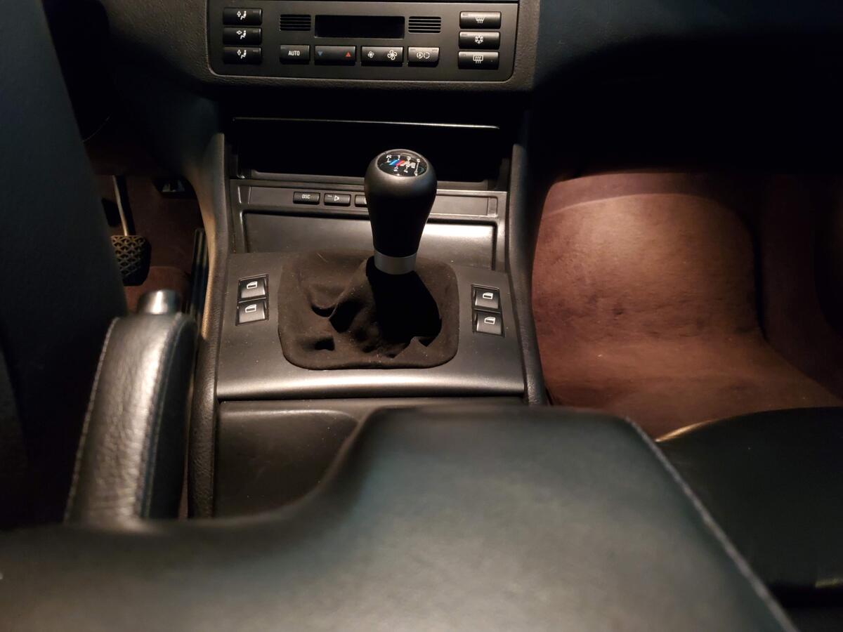

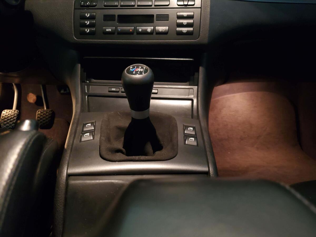

            Replaced everything with stock parts and an AutoSolutions AutoCross SSK. I know that coming from a shifter with a ripped out carrier isn't the best comparison, but the AS SSK feels way, way better. I'm glad I decided to go with this.
            Also, it's pretty crazy how far off center my previous 330d shifter was.
            330d:
            AutoSolutions:

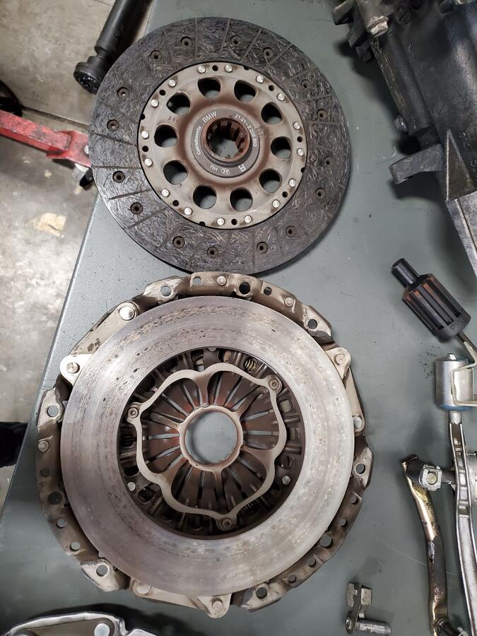

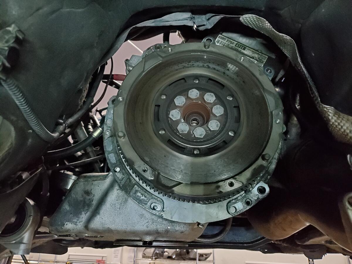

            Clutch and flywheel looked like I expected them to at this mileage. Not terrible, but I'm glad I changed them:

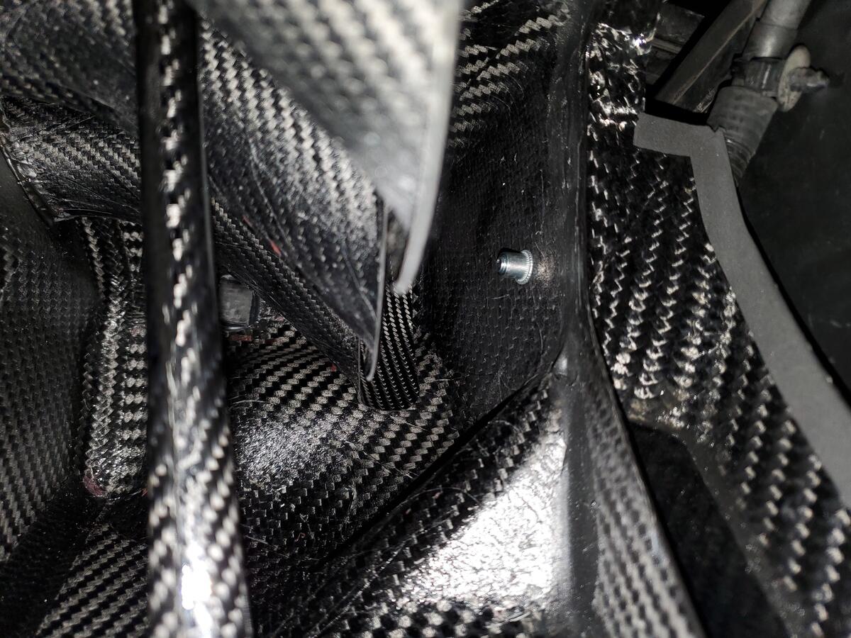

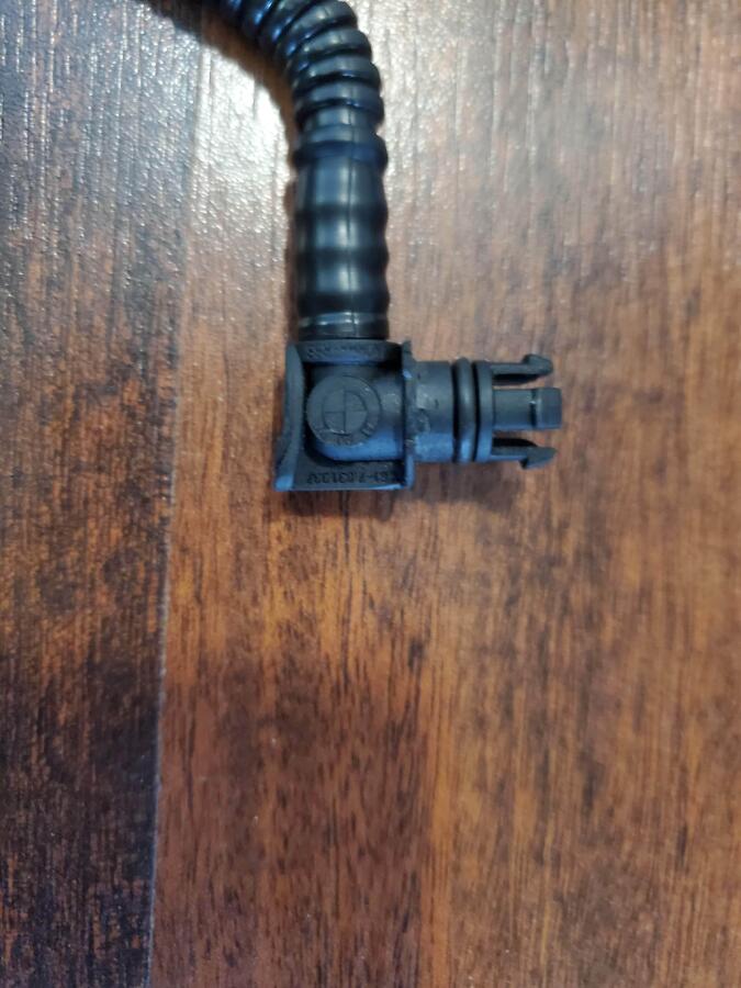

              May 2020

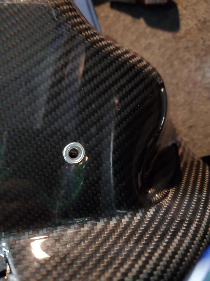

              A couple weeks later, I took off my airbox to fix the underside bung for the line that leads to the oil pan. I found that that bung and the one on top for the shut off valve were a bit too big to let the connectors snap correctly into place. I decided to modify the plastic connectors. Filed them down until they snapped correctly into place. This is what the bottom connector looked like after the modification:

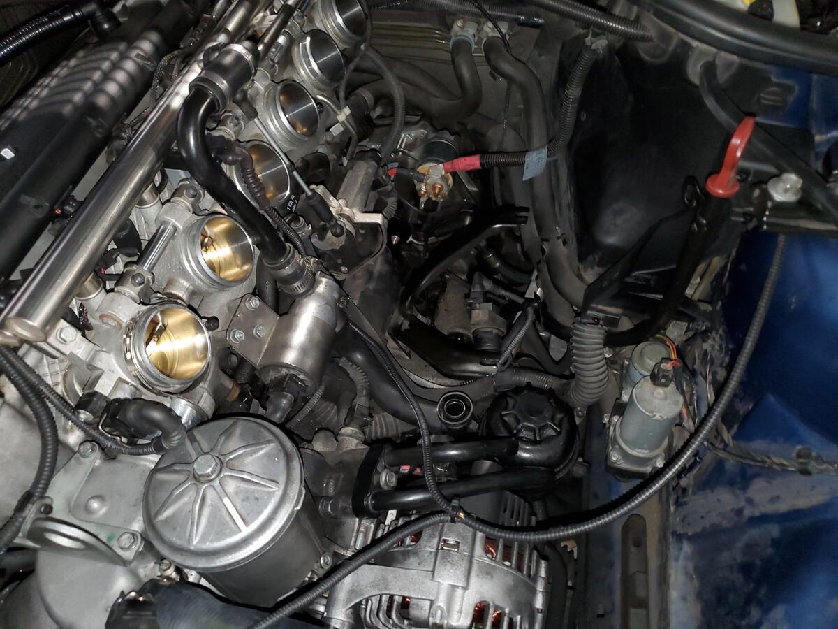

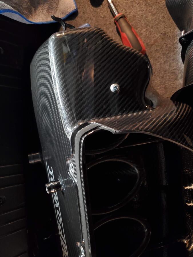

              With the airbox off. I noticed I hadn't plugged the hole where the alternator cable bracket goes, which meant a small amount of unfiltered air was being allowed in.
              Plugged it with a screw I found laying around and some threadlocker:

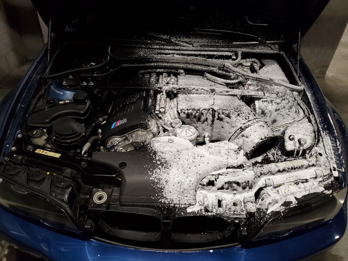

              Messing around with the airbox made me realize just how dirty I had let my engine bay get, so I did this:

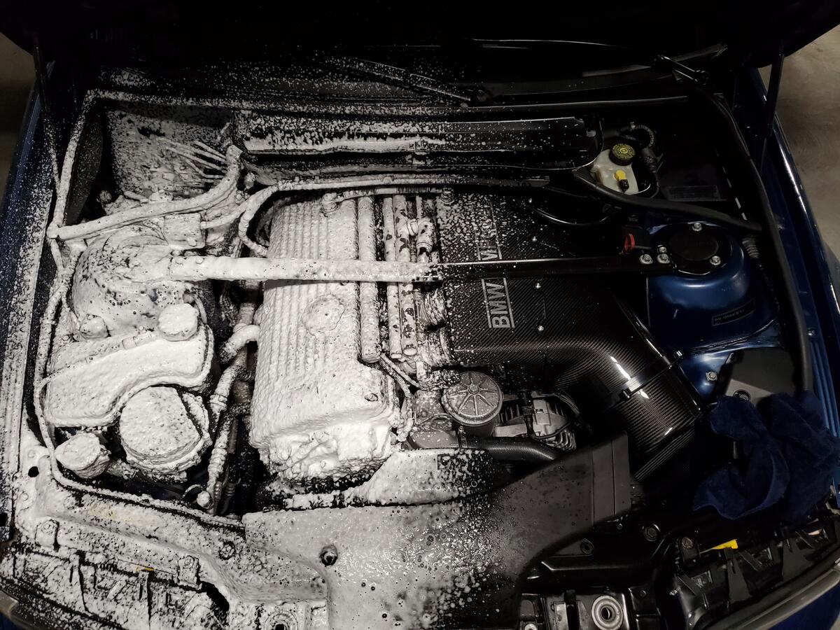

              Right side clean, left side still dirty:

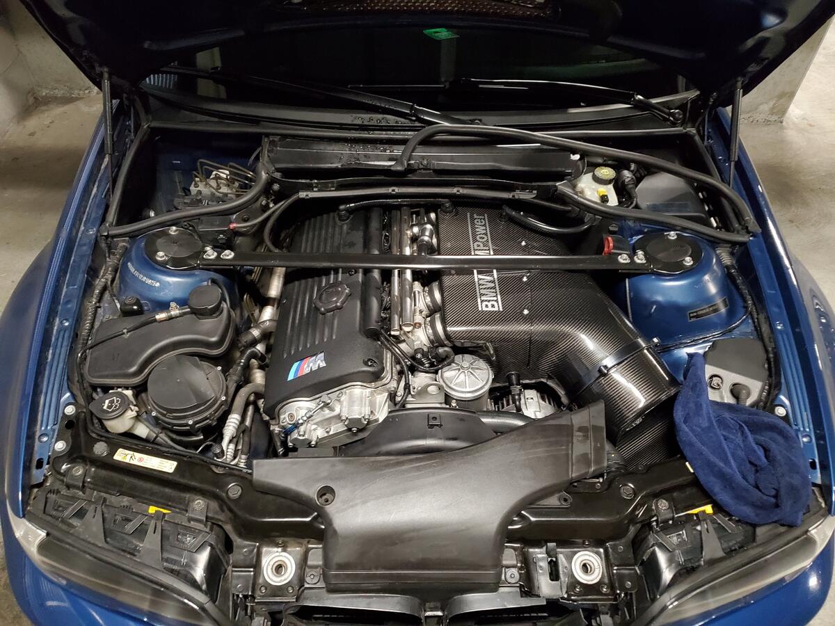

              And finally all clean:
              Looks so much better!

                  I think the reason why I hadn't noticed the carrier was loose was because it was resting on the sound deadening, which was acting like a much worse carrier bracket. When I removed everything, the sound deadening crumbled away in my hands. It probably would have only lasted a little more before it broke off on its own and let the shifter fall onto the driveshaft. That trans tunnel picture shows just how bad it was. Glad I caught it when I did.
