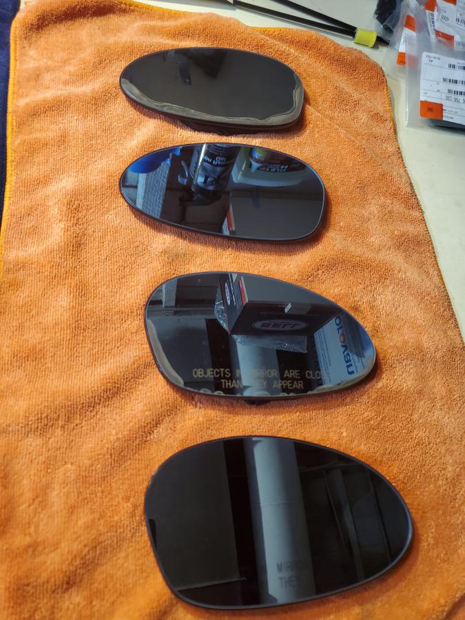

                                When I replaced my mirrors, I bought a genuine BMW part for the driver's side and an S-Tec branded one for the passenger's side. FCP said S-Tec was OE for the passenger's side, but not for the driver's side. I thought that was weird, but the price difference wasn't enough, so I just trusted them.
                                The passenger's side mirror fit with no issues, but the driver's side mirror was very wavy. So wavy that I drove the car for about five minutes before driving back home and swapping the old, corroded glass back in. Thought it was funny that the genuine unit was worse than the OE one, but whatever. Returned the BMW one and bought an S-Tec one to use instead, since it had worked perfectly on the driver's side. And of course, turns out S-Tec is actually OE, since the BMW logo is clearly ground off:
                                Unfortunately the S-Tec part was also wavy. Not surprising, since it turned out to be the same part, but at least I got the same thing for $30 less.
                                Also, I noticed something that I didn't notice last time. The glass was perfectly flat when not installed, but became wavy once clipped in. Seems like the clipping (and holding) mechanism is distorting the glass. Great.
                                I went and pressed on the eight "preload" tabs (pointed out below) with my fingers until they weren't sticking out as much. This seems to have reduced the force on the glass enough to not distort it when installed. Nice, fixed.
                                Hopefully the tabs don't spring back and re-distort the glass. If they do, I'll probably cut them off and some foam/double sided foam tape for preload instead. I'm slightly annoyed at BMW for switching to the newer glass mechanism. The old one works great and is held in place with a radial locking mechanism, instead of using a bunch of tabs to clip in. I see no need for the switch, but I guess these new ones are probably cheaper to produce.
                                Anyway, after much more effort than needed for a simple mirror glass swap, I finally have glass that doesn't look terrible
