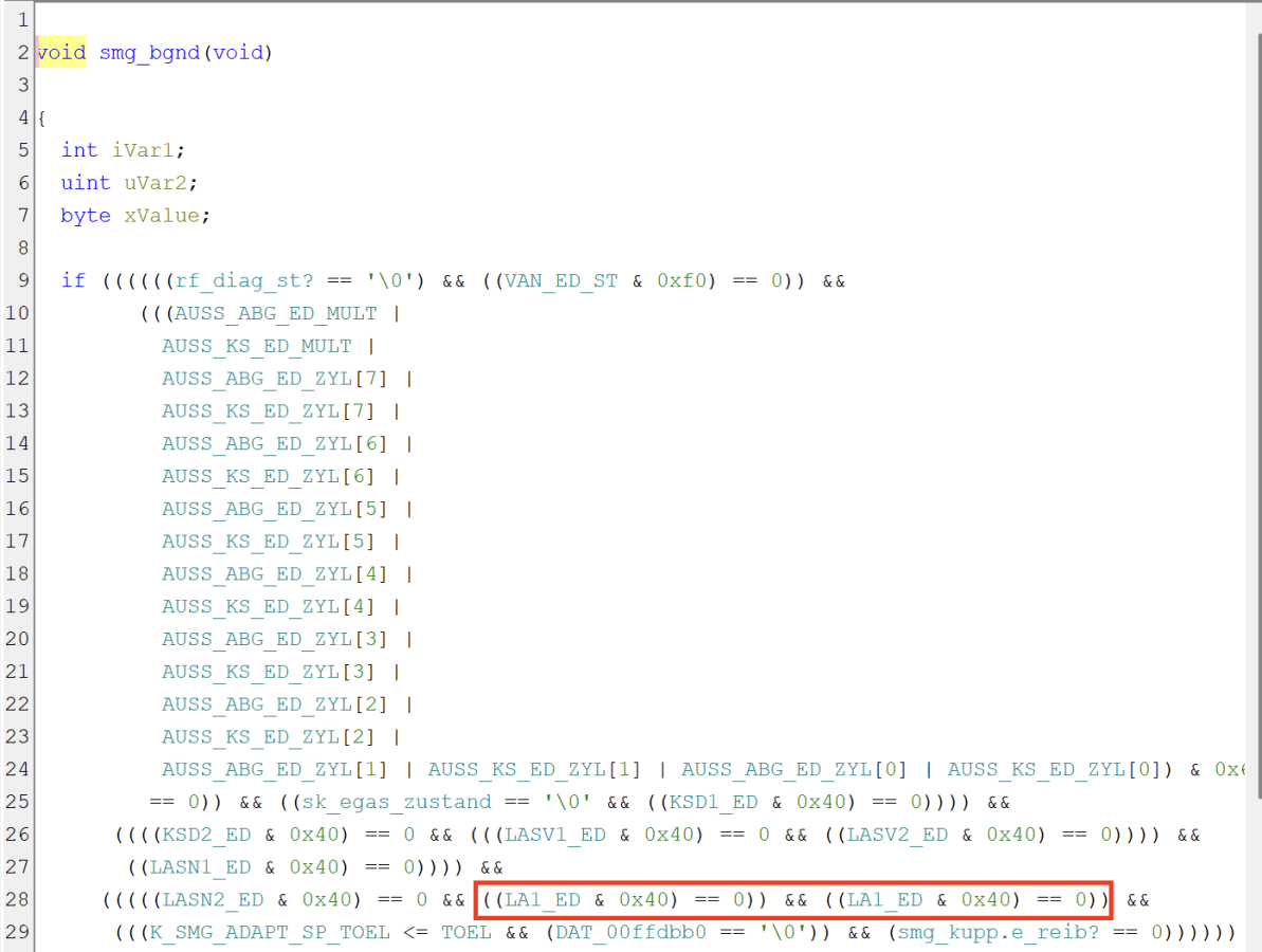

                    Found a bug in the SMG background task:
Name:	Screenshot 2026-08-02 at 5.25.48 PM.png
                    The error check conditional checks LA1_ED twice. The second test should be LA2_ED....
                      Karter16
                      You are amazing
                      This bug was fixed in 323_1801 (M3 MY 04 first M3 MSS54HP)
                      But thats only a very small bug in SMG clutch learning behaviour

                        Interesting! so BMW fixed for the standard M3 when they moved to the MSS54HP, but never bothered publishing a fix for the CSL specifically right? As you say it seems to be a pretty small bug, would be a bit of an edge case I think to cause any issue.
                          You are right.
                          The bug was also fixed for MSS54 nonHP in 322_1701, but never for CSL
