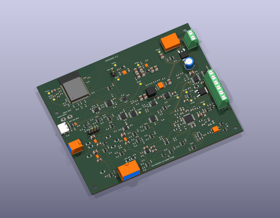

    ESP32 for the (still in development) wideband board is an interesting choice. Wonder how that will hold up to engine bay temps/vibrations/etc.:

        Oh man that would be very cool. As Bryson says that would be a massive rewrite. It wouldn't just be about the actual code changes, but also the amount of research and investigation to understand, to extreme detail, how the MSS54 currently ingests the narrowband, plus how something like the MSS70 uses a wide-band and then figuring out how to bring them together. There's also all the hardware considerations (e.g. are there appropriate ADCs available on the MSS54, etc.). For the Civ fans it would be deity level difficulty. Not to say it couldn't be done, but it's certainly beyond my ability (although to be fair I think I said that about the CAN logging changes as well at some point, so maybe future-me will surprise myself ).​
          They explained it in a bit more detail in the video. Doesn’t seem as bad as I thought as it’s sort of a hack way into running a wideband. As I understood it, they’re not doing any ADC conversion on the board, just taking wideband info via CAN (hope that’s fast enough) and interrupting the narrow band O2 sensor response in the middle. Also sounds like they haven’t written/tested/released this yet so we’ll see.

                Yeah ​I'm not sure about the Wideband approach either and using CAN for this. Firstly the approach is super hardware-heavy with that board as heinzboehmer noted, and secondly means CAN is now in-the-loop of critical engine functions (which it isn't otherwise for the MSS54 at least). I presume they're using a 10ms CAN frame, and the narrow-bands are read every 10ms so technically it is fast enough I think, but yeah...
                I don't really see what this approach gets them over the approach MpowerE36 https://nam3forum.com/forums/forum/e...s50#post368639 is taking on the MSS50 which seems more elegant to me.

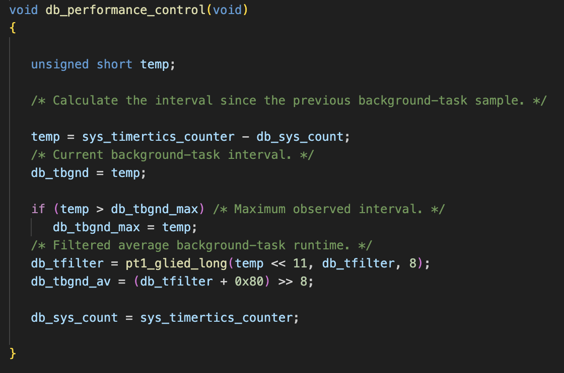

                        Yep great point - and indeed there actually IS an easy way to test this:

                        db_performance_control() runs in the Master and Slave background tasks. db_tbgnd, db_tbgnd_av and db_tbgnd_max give the current, average and max interval times between runs of the background task.
                          What is the background task in this context? Is it what gets scheduled when the system is idle? Or is it actually doing work?
                            Sorry should have made that clear. It's essentially "main()" for the OS. It consists of a while(true) loop and continuously executes when no higher-priority task is running. It's actually doing work, a large number of non-time-critical functions (e.g. table lookups with slow moving inputs like tmot, etc. etc.). So in the true sense of the word it's not really actually a "task" as such in that it's not triggered by interrupt/scheduler.
                              I see.
                              So what I'm hearing is that we can pipe `db_tbgnd` out through CAN, then run the car for some period of time and work out average CPU utilization?
                                I see.
                                Yep that's exactly what I'm thinking. Ideally need to do it on both an HP and a non-HP, however I'd have to port the CAN logging to a non-HP version of the code :-)
