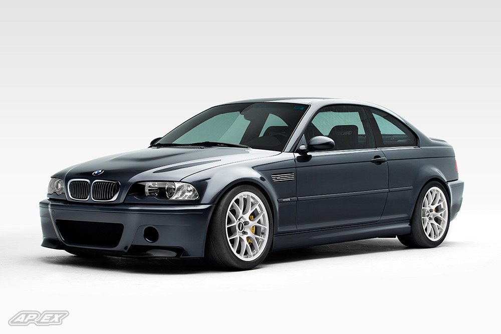

                    APEX photo shoot with a square 275 setup. Not my wheels as I have CSL.

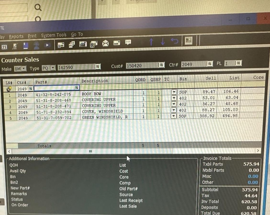

                              Here's a parts list for my carbon roof install. This is all the stuff I had to order from the dealer. Luckily my friend works there and got me great prices on everything, but this does give you a good ballpark of necessary parts not including roof and headliner.
