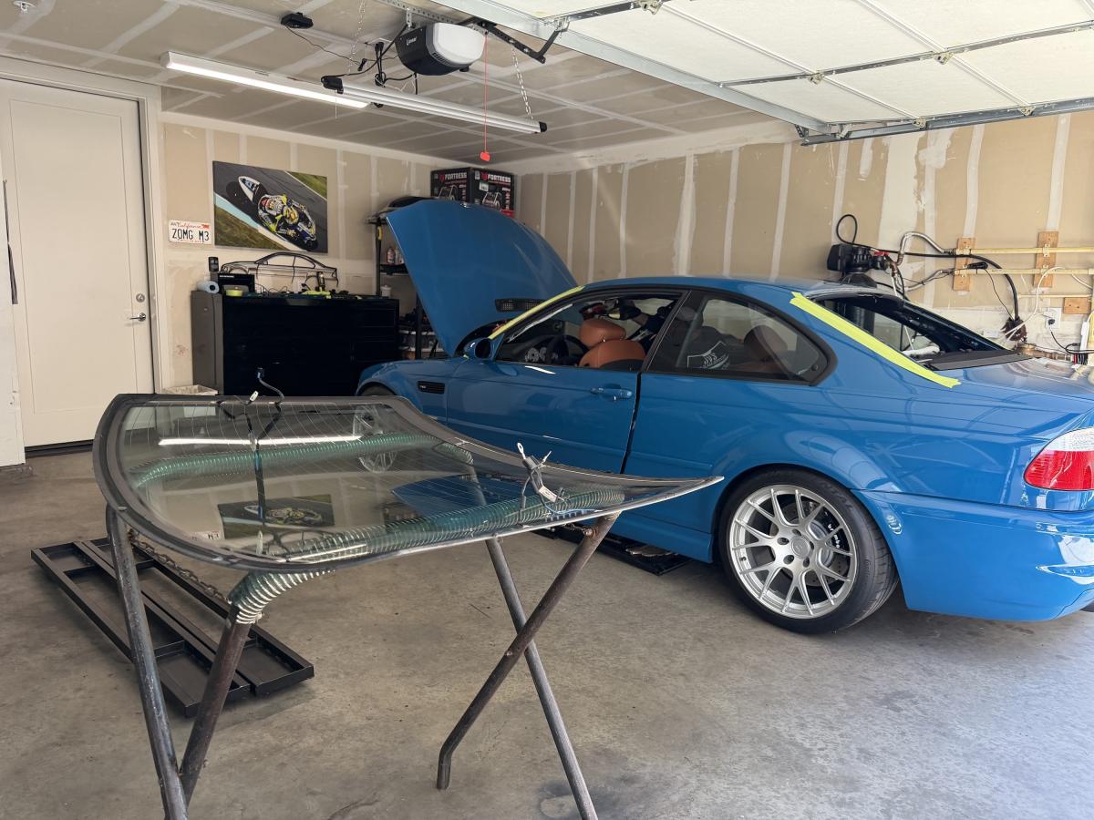

                    Had a professional come today. Very happy with the service. No power tools, hacking, or banging up interior parts.
                    Both glass pieces came off cleanly. Will be replacing the front anyways.

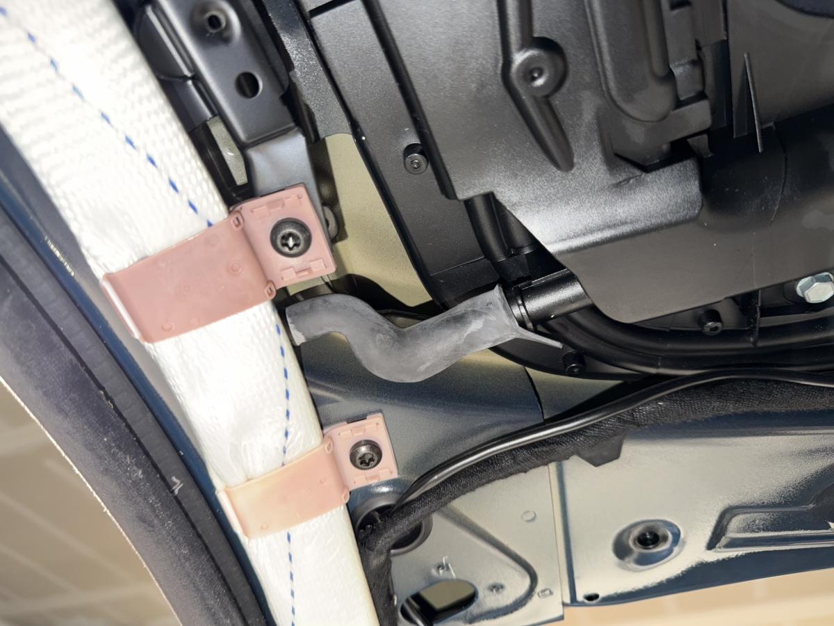

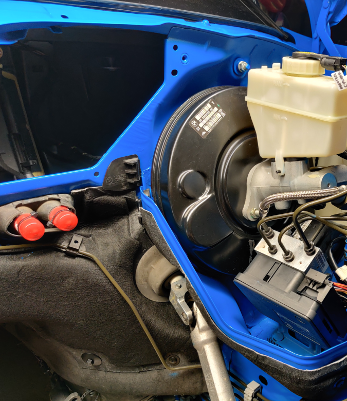

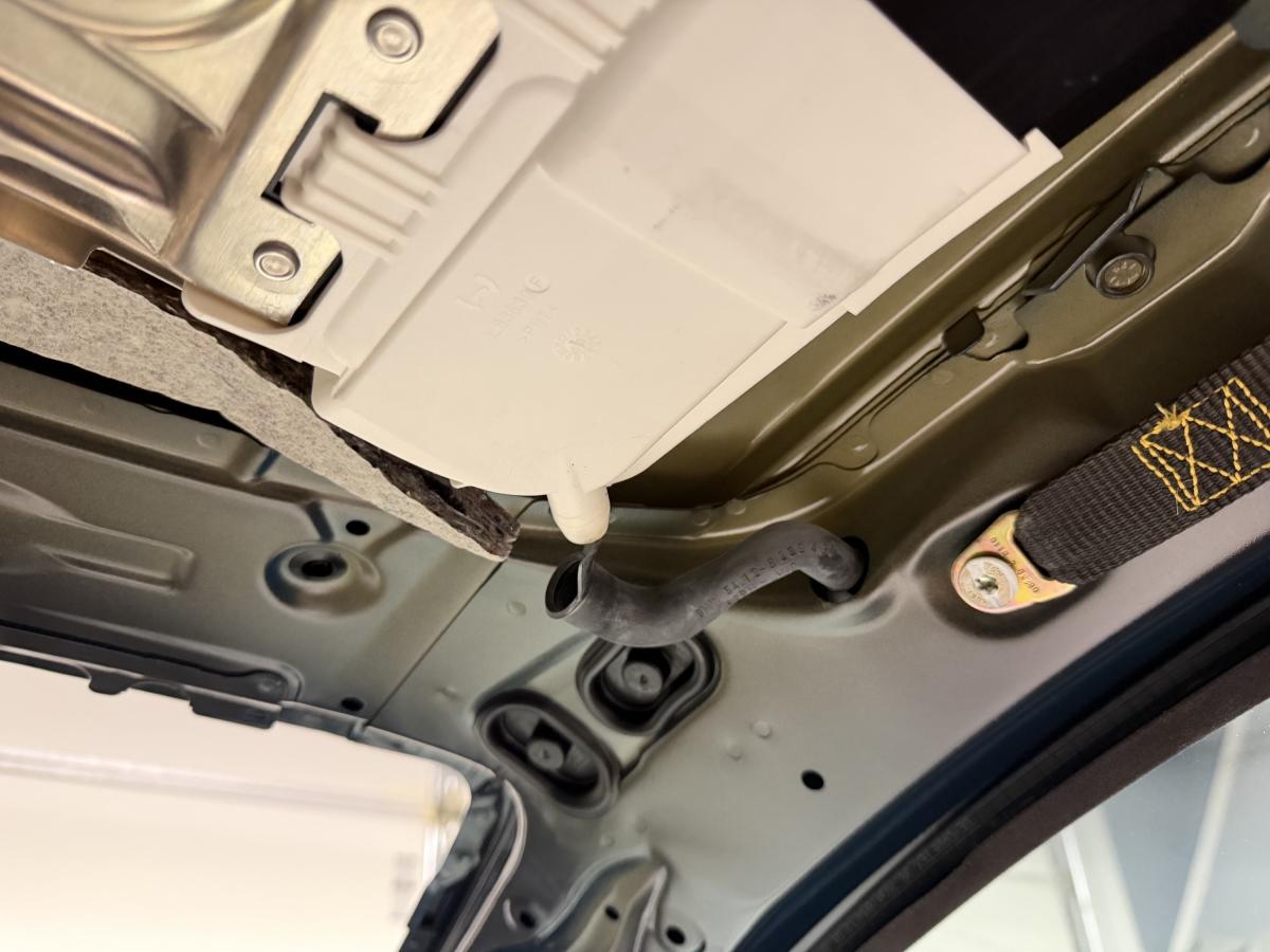

                        Curious what we all did with these drain hoses?

                          IIRC, I just plugged the holes and called it a day. The drains are [obviously] useless on a slicktop.
                            Found an old pic. I couldn't find a pic where I capped them off, but I purchased an assortment of silicone caps off from McMasters or Amazon (can't remember) and just capped them similar to the red caps in the 2nd pic. If you measure the OD of the drain pipes, you can pick up the right size caps pretty easily.
                            Or... just leave them be. I can't imagine they'd be an issue if left open.

                              Thanks Casa de Mesa I figured, but was curious what others did since I didn't see them mentioned anywhere.
