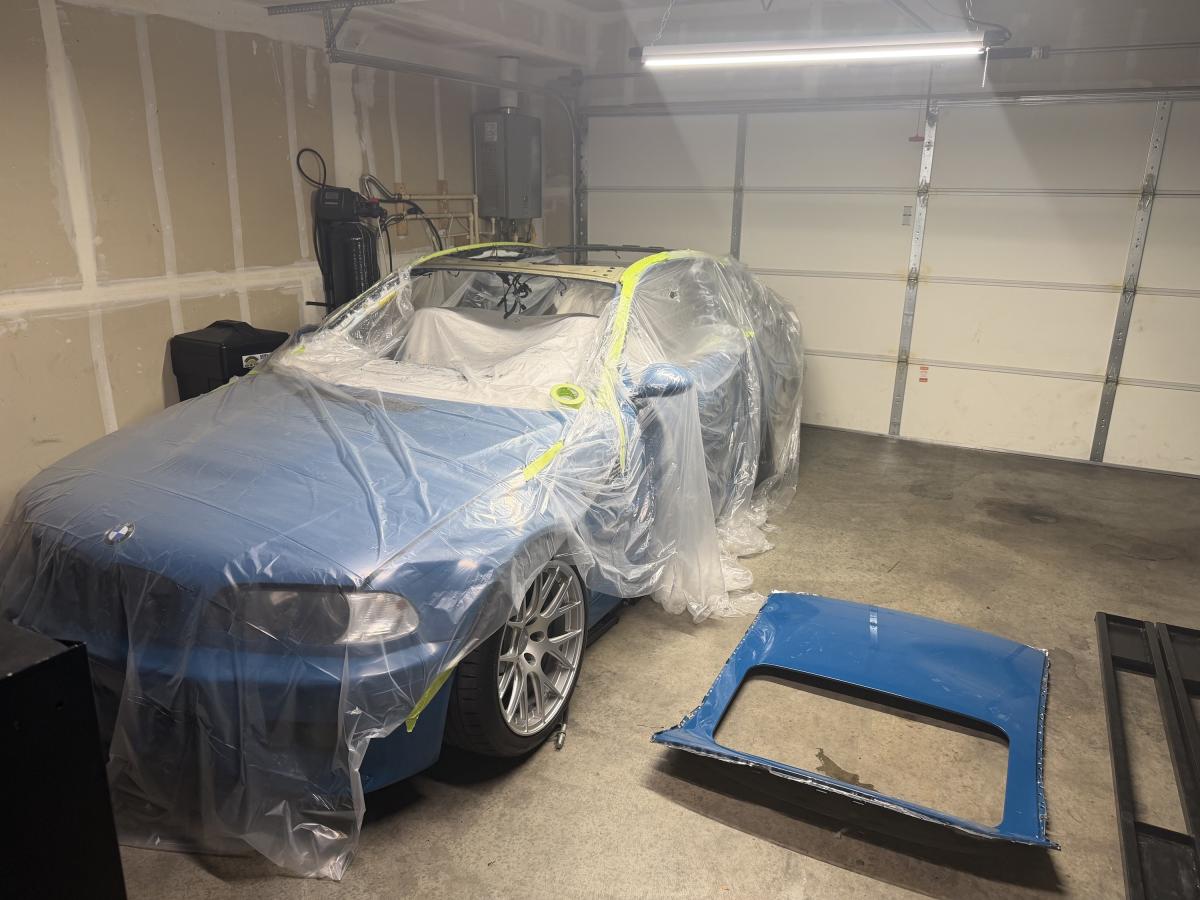

    You bet. We need progress pics as they become available!!
    Things are happening.
      Nice!
        Some day I'll do that too !
        Love the pictures in this thread !
            Indeed. Good things. Very good things.
