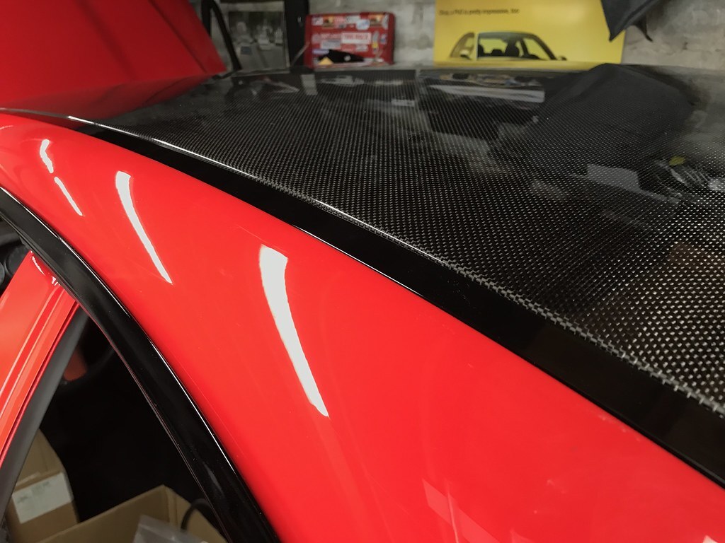

    My Lang Racing Roof. Weave and fit is perfect, carbon is strong enough to stand on. Only problem is it did not come lacquered so had to do it myself.
    Please share the details. Where did get it installed?
      #47
      Any decent body shop can do this. Its more time consuming than technically difficult. There is a lot of anxiety on spending this much money to rip off a perfectly good roof but looking at the roof everyday I have no regrets.

            where did you purchase your roof from? looks clean. is that 1x1 weave??
              #51
              Its a Challenge roof 2x2. VERY nice weave and absolutely no flaws. Was pretty straight forward to install. I had the car repainted so it also has fresh clear coat and polish.

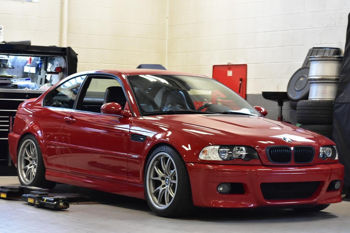

                            Somebody posted some pictures of a slicktop conversion done on an Imola on M3F just before the site when down and it looks fan-fn-tastic.
Name:	Slick top 1.jpg
Name:	Imolarot 2004 E46 M3 .jpg
ID:	44516 Click image for larger version
                              #59
                              ^ I recognize that garage and car, bought my ZCP wheels from him. Nice dude, nice car and cool conversion. Personally I’d just go CF at that point, it’s mostly labor cost anyway. Unless these stupid roof rails become impossible to source or obscenely expensive
