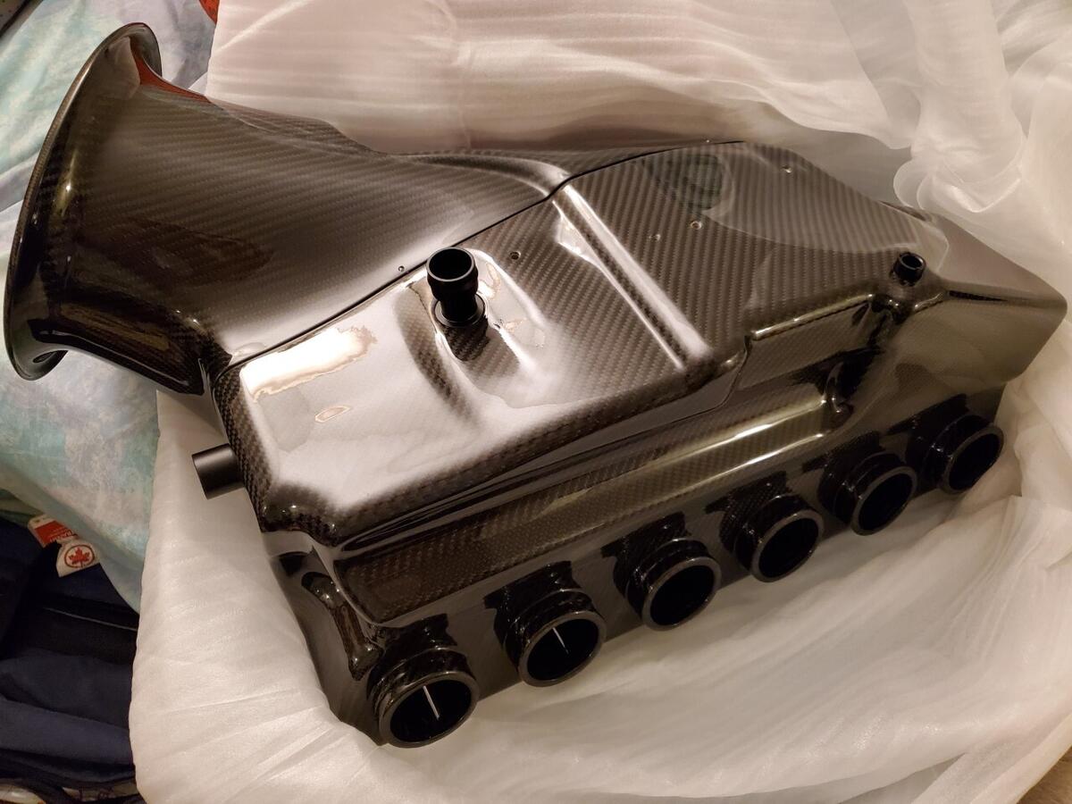

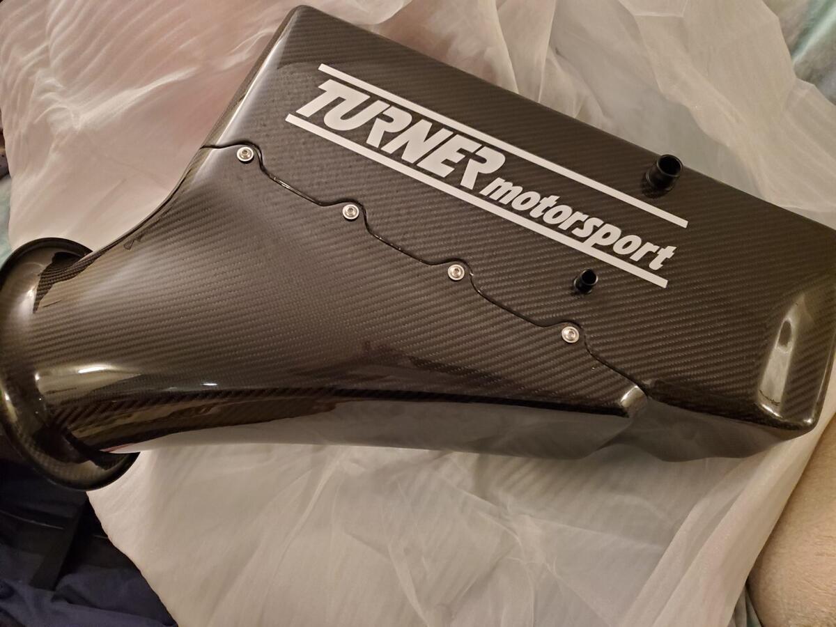

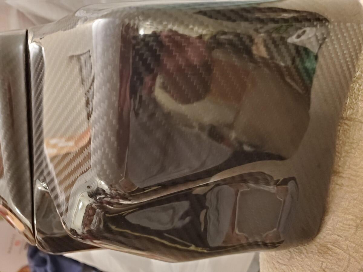

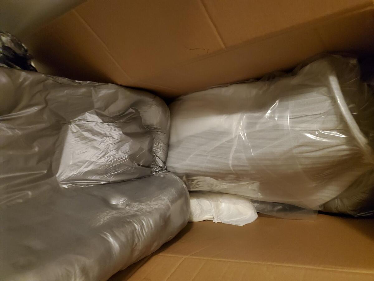

          V2 box just came in, Ian from Turner confirmed. Packed really well, took a while to open it:

            Are the V2 boxes coming with the Turner decal already stuck on? I thought I remembered the first V1 boxes arriving plain.
              The V1s had the decal, at least mine did. All decal and no PCV port.
                I wonder how it would survive the journey to Australia, getting close to ordering...
                  With how they are packed now it should make it no problem. Its worth it 100%(even if i am biased) the sound is amazing.

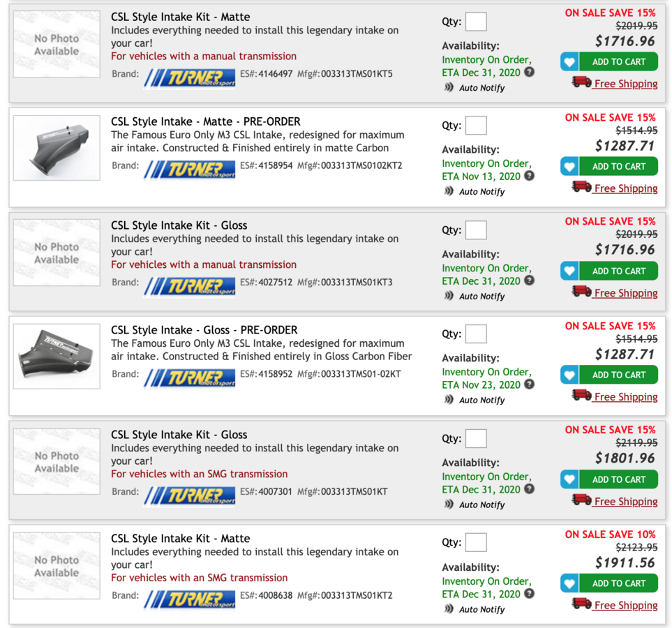

                    ECS has them "on sale". These don't include the filter anymore, so the price is less now, but I guess that makes it more affordable. Still need to get the filter, though which will put you back at about hte same price as it was before.

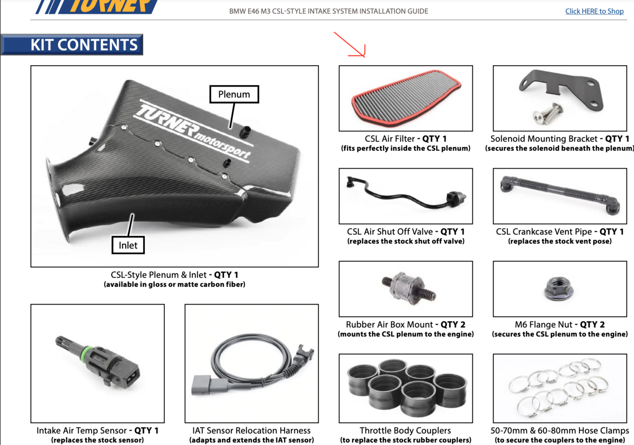

                        I thought earlier versions did. I might be mistaken though, even their installation manual explicitly says the filter is included with the intake.
                          Yeah the filter used to come only with the “kit” on the earlier version. Now it doesn’t.

                            Ah I see. Yeah sorry I thought you meant filter came with the basic box purchase. In any case the price of the basic box is down near what the groupbuy price was, so, a pretty good deal I think.
