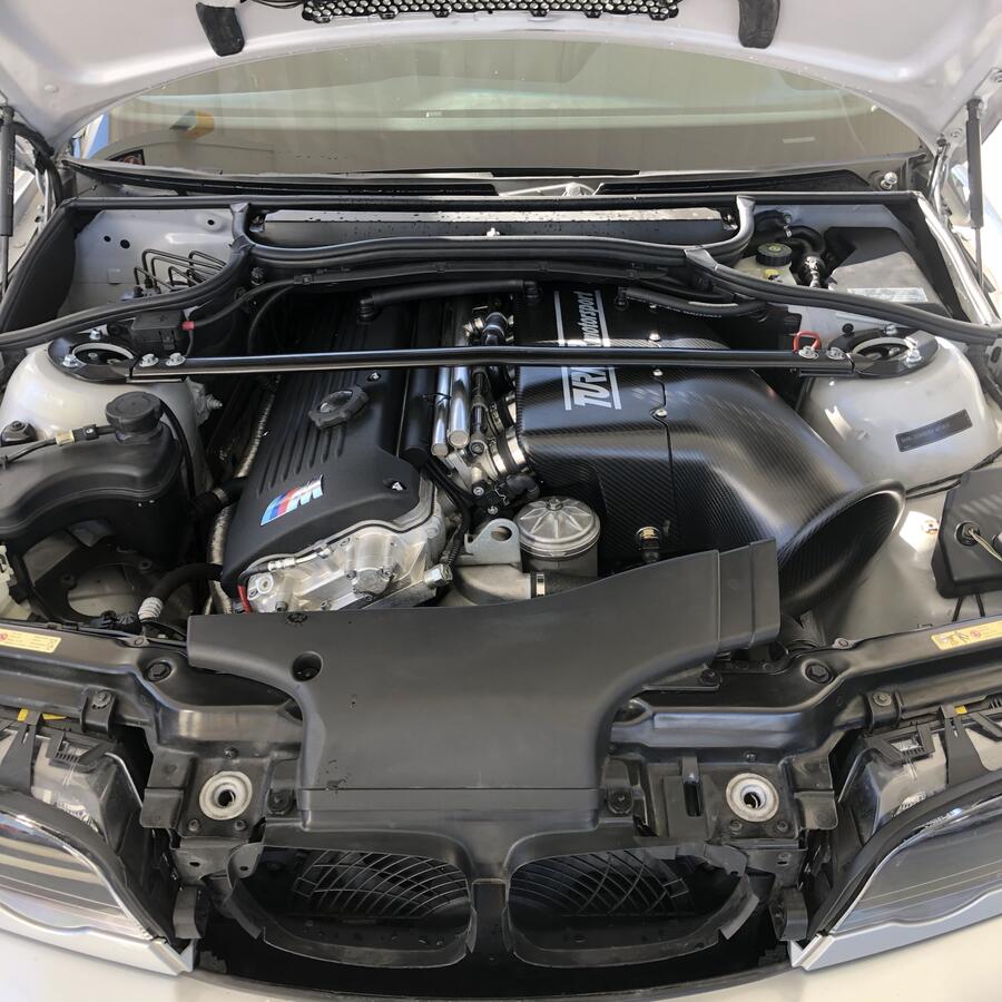

      Air box is in, yes it rubs on the strut bar. Dropped the car off at Lang Racing Development yesterday for Shrick 288/280 cams the tune and a corner balance and alignment. I was surprised at how well it ran without a tune, of course I just drove it mellow to get it to the shop. I’m really excited to see what it does on the dyno.

            Air box is in, yes it rubs on the strut bar..
            Well that's a bummer. I wonder if these issues are tolerances in the build of each car or just that TMS hasn't done well with precise manufacture of this product. You can bet they are getting these made in Tawain, like other ECS cf products. That alone doesn't mean they're terrible. But often doesn't help instill spec confidence.
            So issues so far are: Port breaks off, not just shipping. Clearance issue on the fresh air intake box/firewall. Slightly tall that it doesn't clear stock strut bar. If the first two issues have been redesigned and fixed the strut bar clearance can probably be fixed easily. Shims, or another brand bar. Another might be the Rogue Engineering replica Group N motor mount. These list actually lowering the engine 5mm from stock (granted existing mounts haven't dropped). I have genuine BMW Motorsport Group N motor mounts, they are a bit firmer, not sure how firm the the RE replicas are. But these really limit the engine rocking on torque and if your engine moves now it might be rubbing even more when throttle applied with stock mounts.

              I wonder if the clearance issues are tolerance, or rather, manufacturing variation. Karbonius and even Streamline users don't seem to have fitting issues, and some TMS boxes have been fine. maybe a side by side comparison is the only way to confirm this. I have a Karb in my Z4 and I have tons of space between the strut brace to the box.
                I’m thinking after the car comes back from Lange I’ll be able the get the lower mounts just right so that the strut bar isn’t an issue. I have Polly mounts so I’m not worried about the engine rocking and making more contact.
                Mine is the second batch with the new packing material but I think it’s version one of the box.
                it seems like the turner box might be bigger than the others, they definitely used all the room that’s there. Sure looks and sounds bad ass

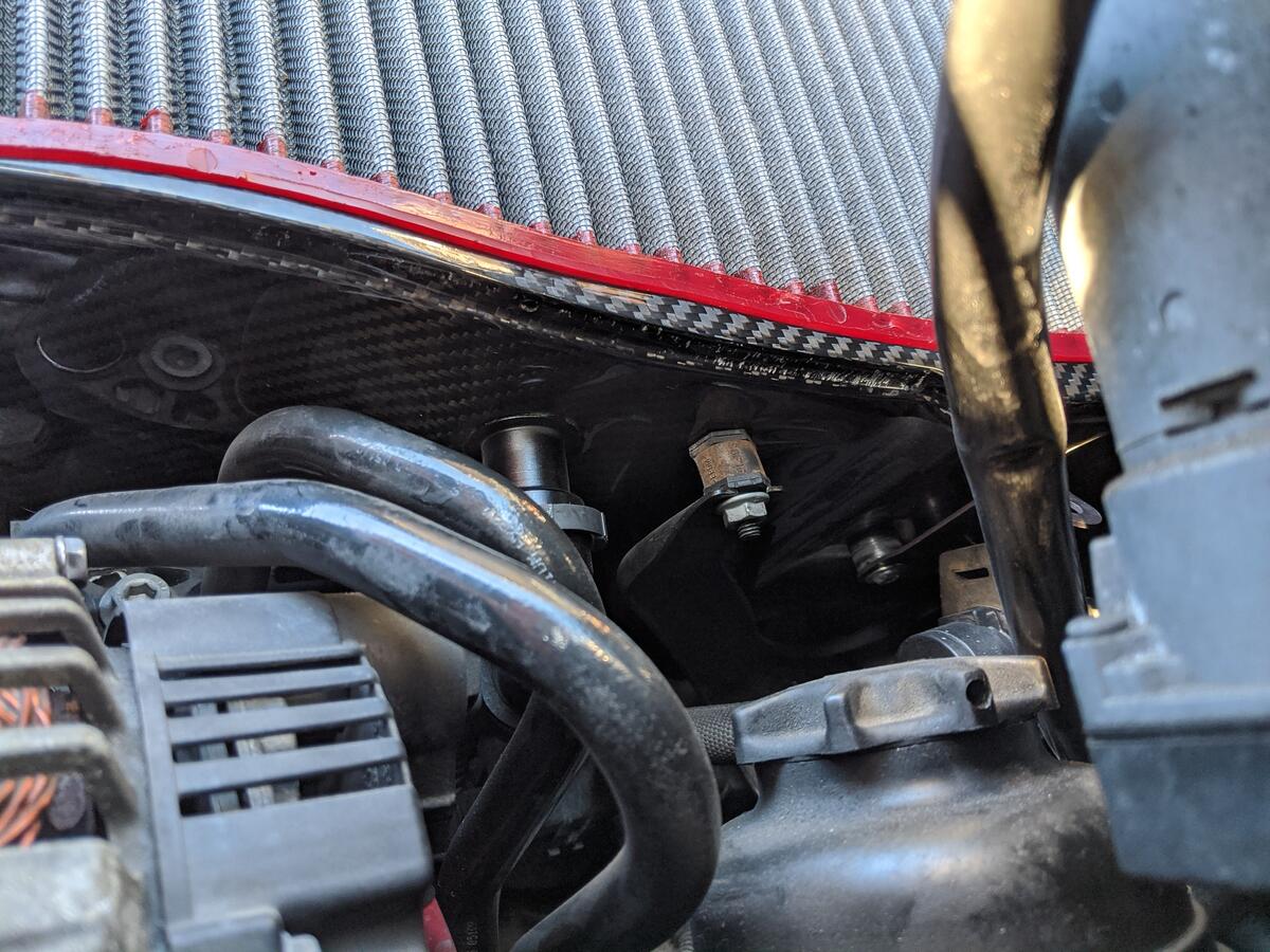

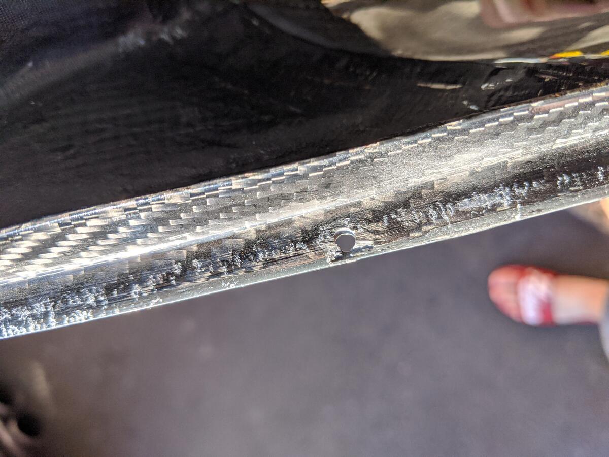

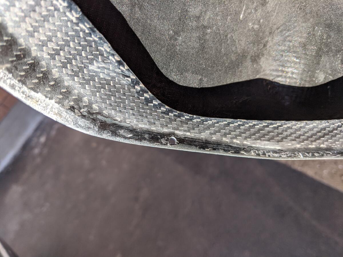

                      Bottom tabs have sheared off. Anyone else experience this?
                      EDIT: I've already contacted TURNER about a replacement due to the cabin air filter fitment, they were very helpful and receptive, will be getting a V2 once the are available. Yesterday when I was doing a bit of detail on the engine bay I decided to take the bell off to check it over and to my surprise it was very loose. So initially thought the little tabs have slipped off, but no they are gone. I'm sure I'm not the only one. I hope this is addressed in the V2.

                        Just checked mine. Same issue, the two little pins are gone and the bottom of my airbox is no longer pressing against the filter. Guess the vibrations cause them to fall out

                          Yep, mine too.

                              I will have to check on my V2 now that I have a good amount of miles on it, but we did not change the design of the pins/mounting of them. But we did change the bonding adhisive for them to address this issue.

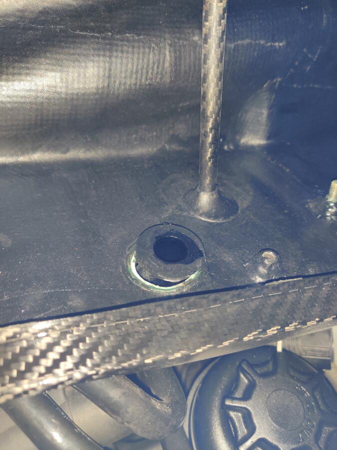

                                So i had a chance to take things apart today, and to my surprise, not only are the bottom pins missing, my ICV bung had completely been dislodged. Guess my car has been sucking unfiltered air for a while. Great.
                                Reached out to ECS already yesterday (originally bought from ECS), waiting to hear back. I've had enough issues with these bungs from the get go, and they keep coming back... Hoping Turner/ECS can assist.
