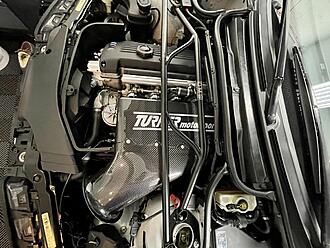

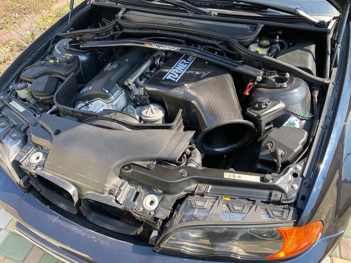

              I apologize in advance for the mistakes, I used a translator. Yesterday we finished the installation of the intake, everyone who says that there should be 2-3 hours, gentlemen, you are either dissembling, or did something wrong. The installation took us about 2 days or about 15 hours in general, we had to make a bracket for the SMG tank, since drilling the body is a very bad idea, the installation itself is not difficult, but a lot of parts had to be adjusted in place so that there would be no tensions ( I suspect because of this many have problems, there are some nozzles because of the curves of the mountings just constantly under tension), the transfer to the map took about an hour, and that is because how long it took to prescribe my own wine (inpa was broken).
              The photo is not yet the final installation, I really wanted to ride and did not take a photo, today I will try to shoot a video on board with sound, since the CSL intake and exhaust bank of Eisenman gave an incredible combination.

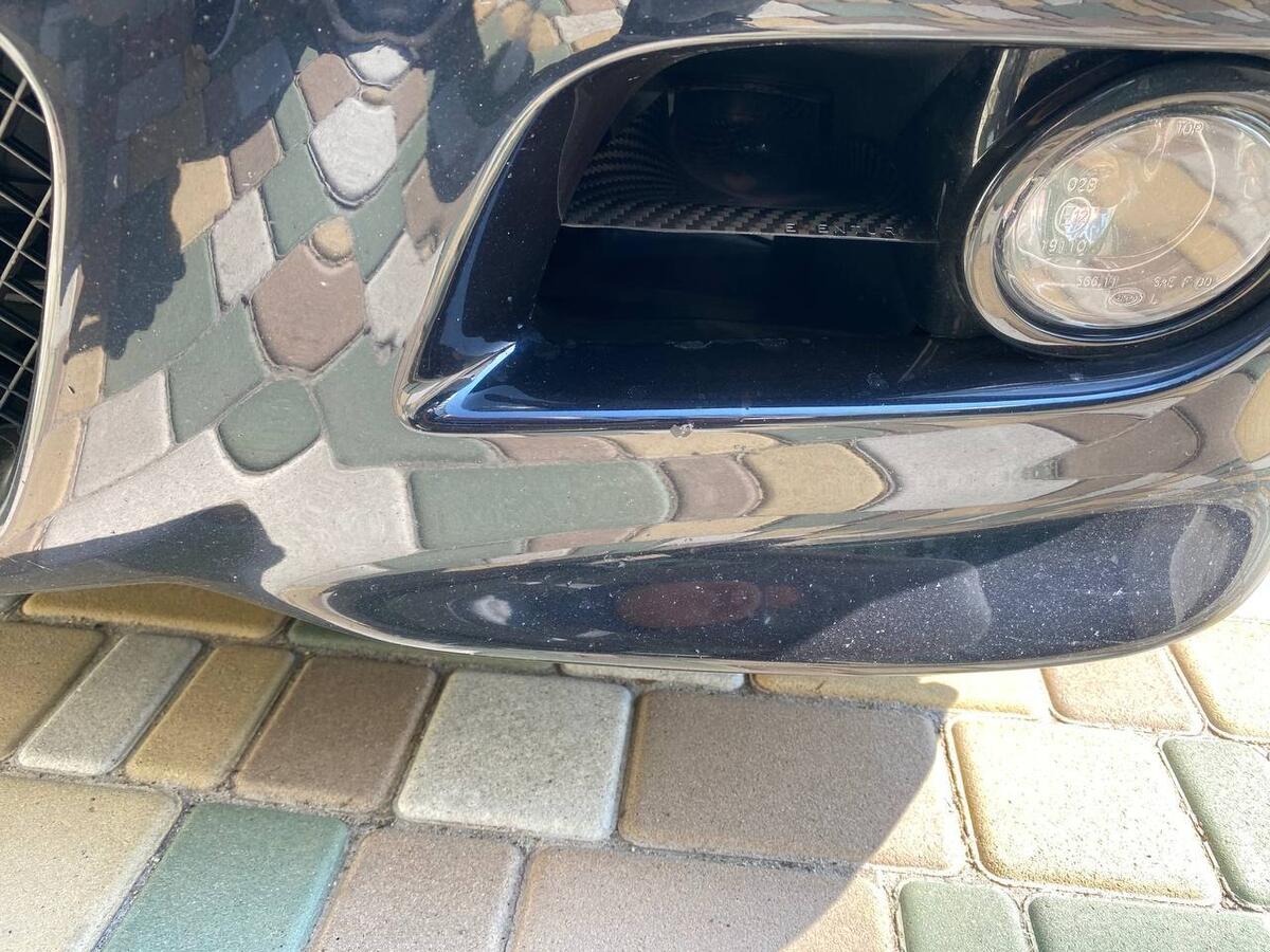

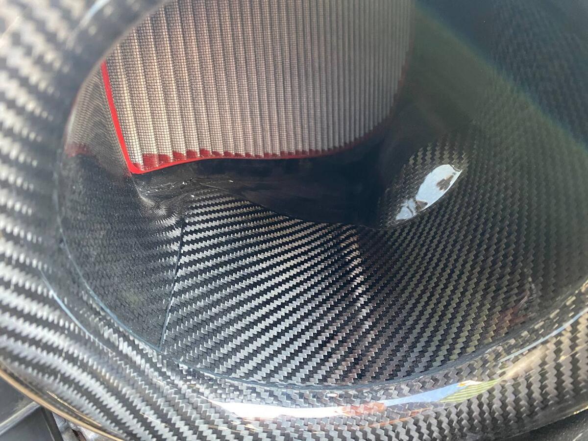

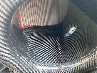

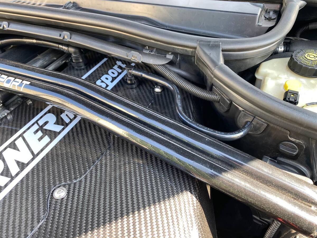

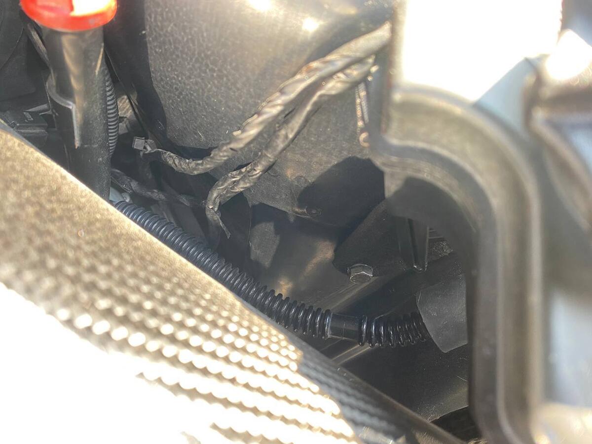

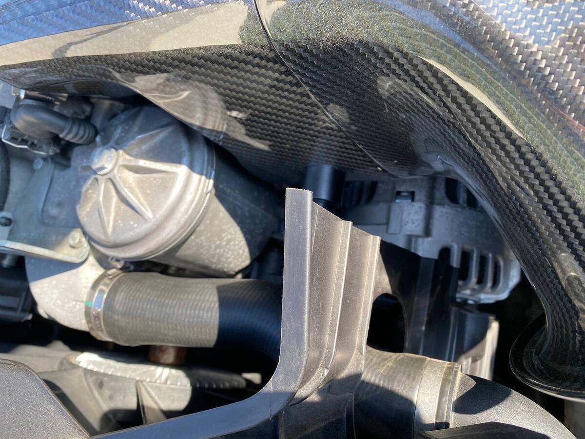

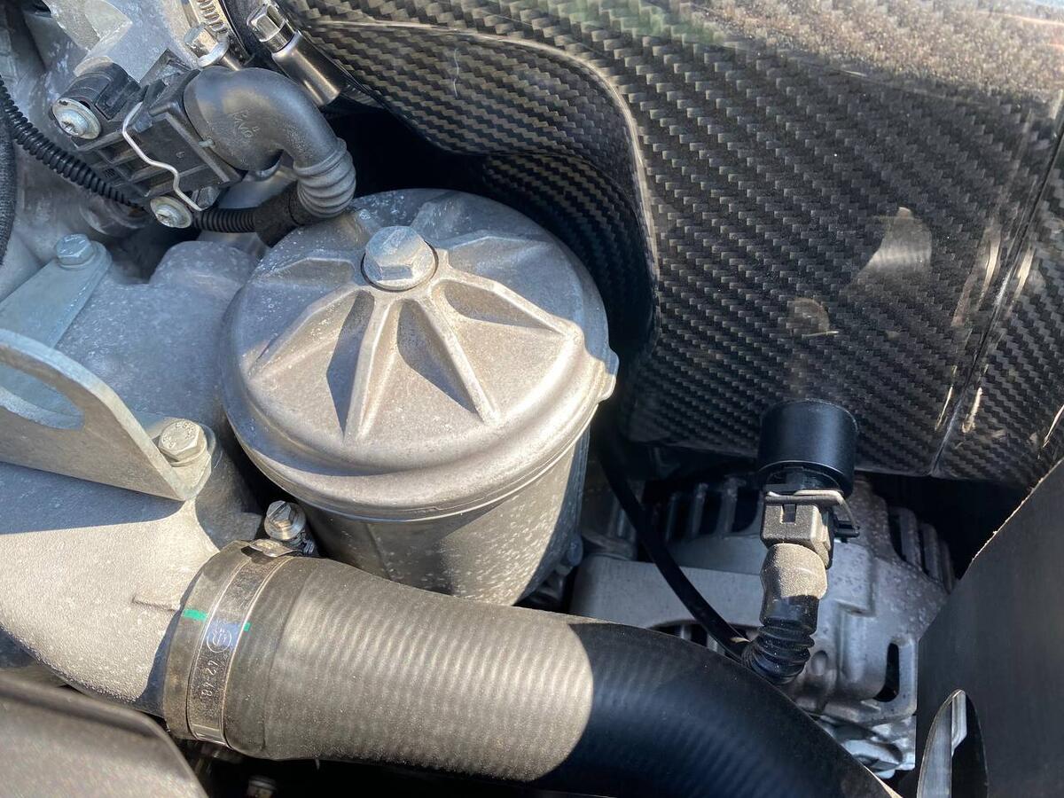

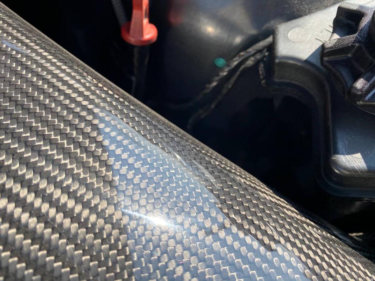

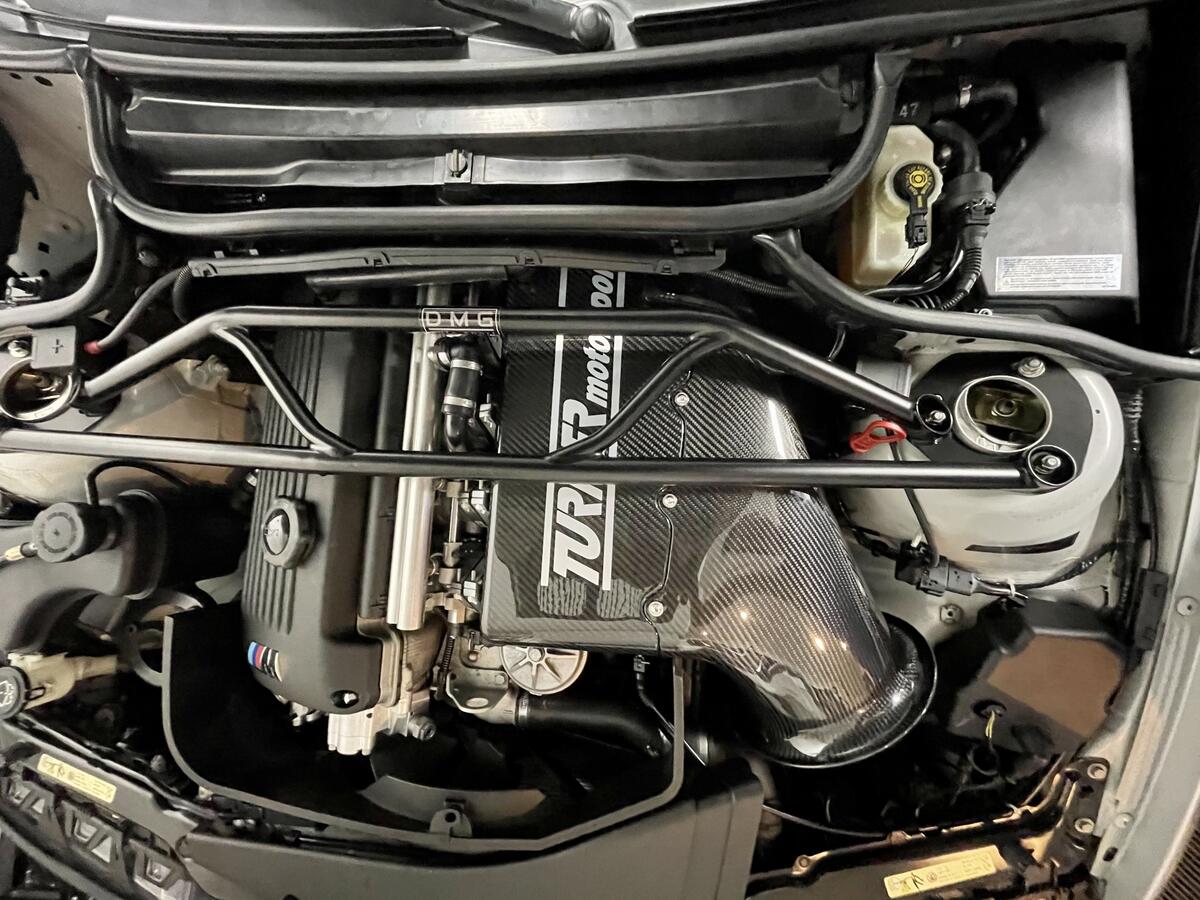

                      Made a little video and some photos of installed intake

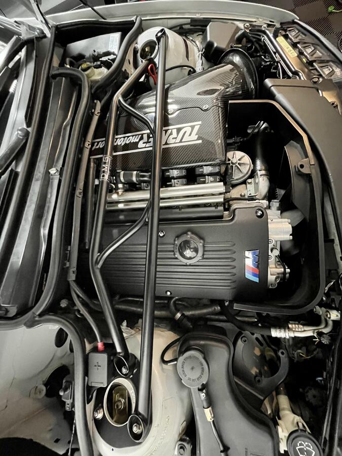

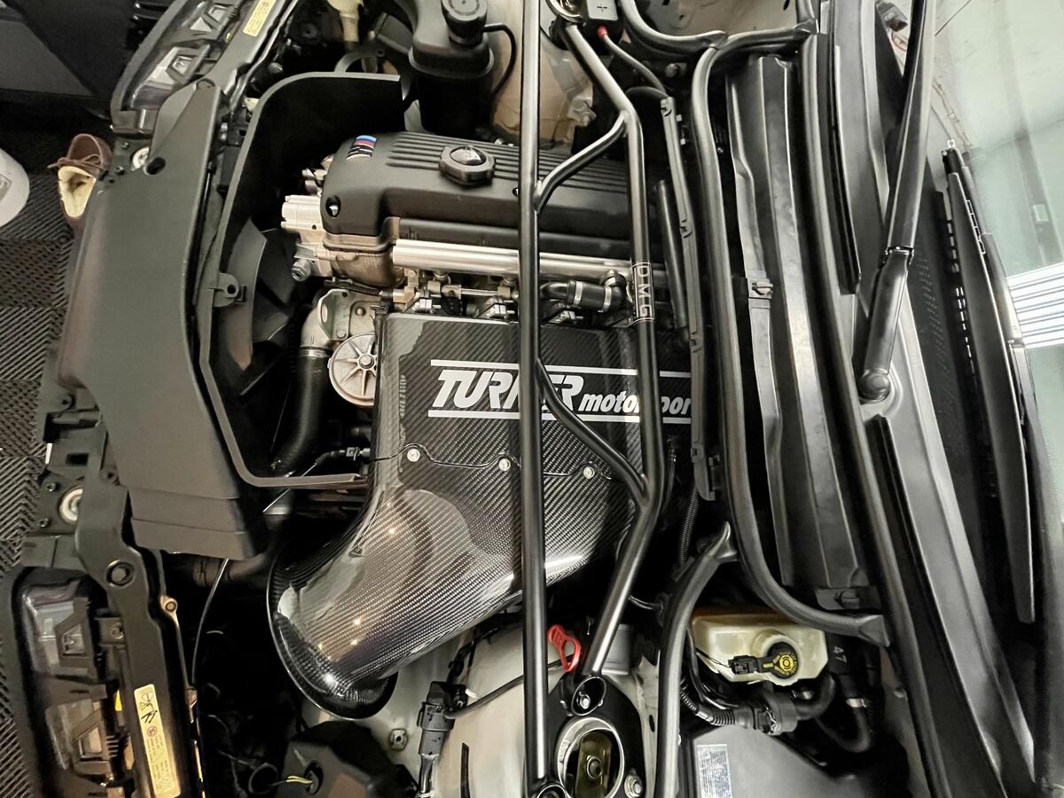

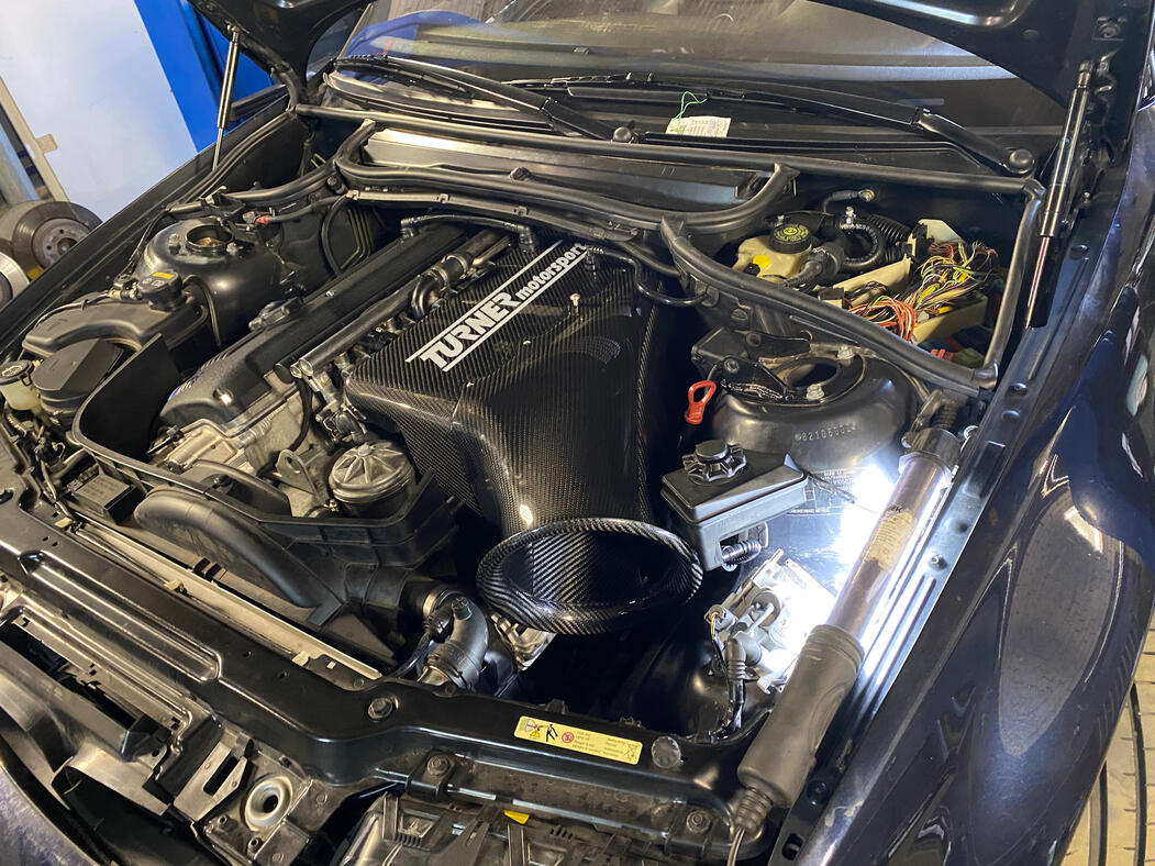

                          Round number two! Replacement air box installed, time will tell if the pins hold up. Fingers crossed.

                            I think I see some carbon fiber down in the brake duct area on this image, did you buy or make something to direct more fresh air towards the intake?
                              It's the scoop from an Eventuri intake.
