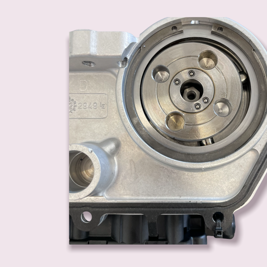

    If they did not remove the securing clip for the oil pump disc and left the VANOS unit completely stock, then there might be a problem with that VAC exhaust hub. Otherwise, it would be an installation issue like heinzboehmer said.
    In your picture, I cannot see the securing clip or washer for the VANOS oil pump disc. That is a strong clip that retains the ring that has now fallen out onto the exhaust hub.
    Haha touche
      #77
      These photos seem to show that the retaining ring that holds the outer race of the pump disc has popped out and the outer race is what he's moving with the pick?
      If so it seems possible that if the retaining clip wasn't seated properly that could have caused the rest of the destruction subsequently?
      It's been a while since I did mine but from memory that seems plausible no?
      I'm not sure what the term is for the part, but that is the ring that the four oil pump pistons push against and it rides on the needle bearings in the VANOS unit.
        #78
        Yeah agreed. If that retaining clip wasn't seated properly, or the oil pump pistons weren't seated properly then that could be the cause of this too. The “bearing” damage could be subsequent to that. All depends on exactly what OPs mechanic did/didn't disassemble.

          Update from the shop:
          So what happened is the piece in the upper right came out
          https://beisansystems.com/wp-content...mage075-14.jpg (https://beisansystems.com/wp-content...mage075-14.jpg)
          What is odd is the snap ring is still in place.
          All the needle bearings are out in the oil pan so we are going to need to flush the engine oil
          https://beisansystems.com/wp-content...mage082-13.jpg (https://beisansystems.com/wp-content...mage082-13.jpg)
          The Beisan vanos would work and we can flush out the oil pan.

            The snap ring isn't in place in the photos you posted earlier.
            Edit: unless it’s part of the needle bearing casing?

                  Not sure how that is physically possible if you look at how it is assembled -
                    To be honest, I don’t know what I am looking at

                      Exactly - something doesn't add up

                          This video explains the components and how they are assembled, skip to 8:40 -
