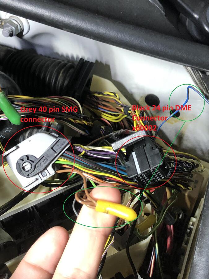

            For those who have done the wiring as mentioned in the original post (with gear position switch connected), it says, "Next connect the ground connector from the SMG ECU to the DME pin 20 at connector x60002 (24 pin black connector) next to the 9 pin power connector on the engine DME. Note that pin 20 on the DME is blank, and you will need to disassemble it and insert the wire with a female pin that will click into place."
            Is the original poster referring to the brown ground connector wires, circled in green, this photo:
Name:	clutch pin 2 to dme wiring connectors.JPG
            So I am suppose to connect any brown wire, circled in green, to the blue pin 20 wire at x60002 circled in green?
            Thanks in advance!
                  Thanks in advance!
                          Thanks in advance!
                          just re read your post, pin 20 should be blank in the Black DME plug. You should not have a wire to tap into. I took the pin out of the SMG ecu connector , yes the brown wires you have circled and then put it into the blank spot at pin 20 of the black DME plug.
