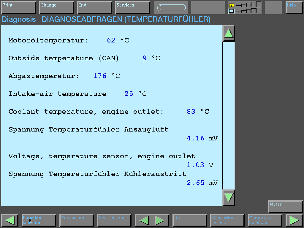

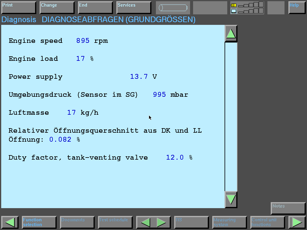

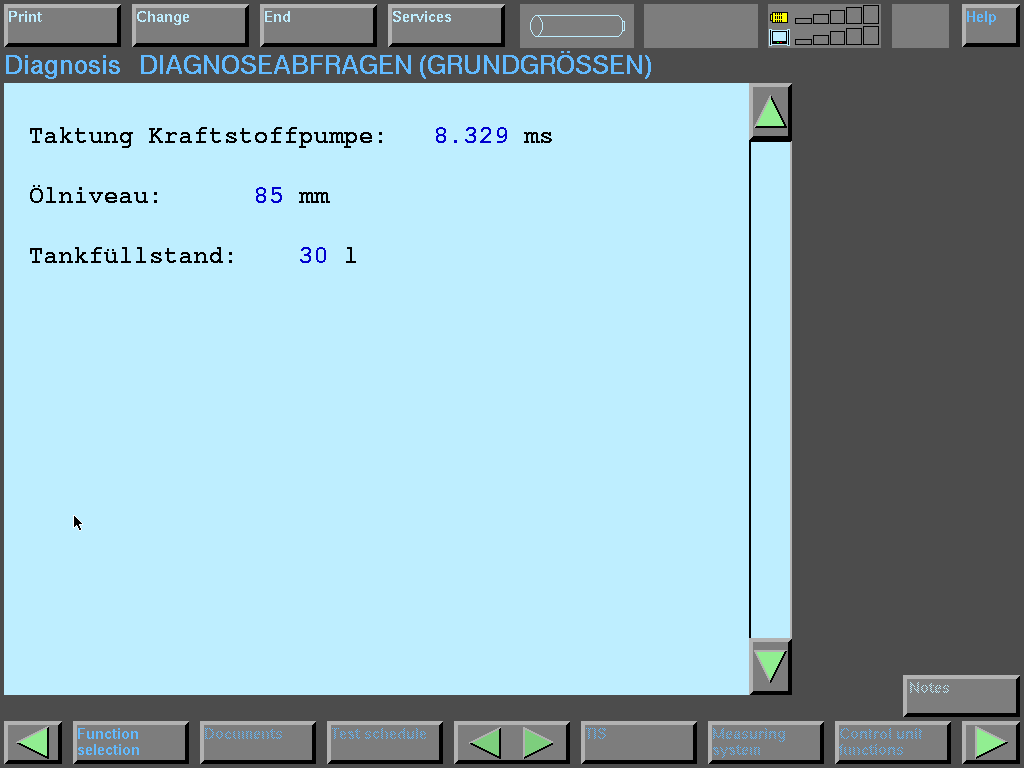

                            Would it be possible to have a dashboard in the app, to display useful and interesting values in a more readable format?
                            DIS has some interesting values. Temperature, pressures and voltages. It would be great to be able to view them at a glance. Especially oil level, since i never got it to display on the cluster :-)
                            Click image for larger version  Name:	DIS v57 Revtor-2024-11-25-14-59-27.png Views:	0 Size:	19.8 KB ID:	358163
Name:	DIS v57 Revtor-2024-11-25-14-56-29.png
