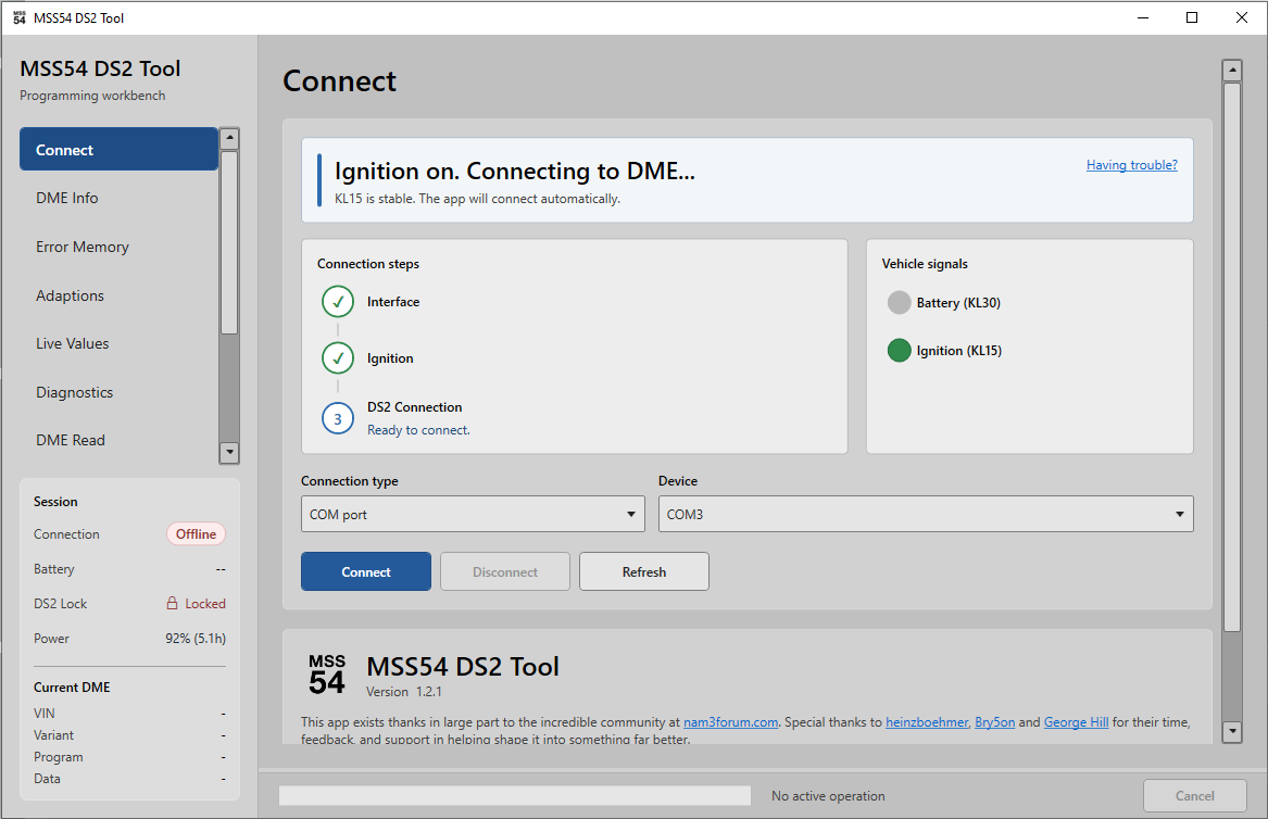

                      is it normal in 1.2.1 to show KL15 ignition on when i just have the application open but no USB cable connected?
                      i just downloaded and installed over previous version and launched 1.2.1 but saw the status shows KL15 ignition on

                        Weird. No it's not. Let me investigate. Are you running in a VM?
                        What happens if you close and reopen the app, it persists?
                        Edit: I don't seem to be able to reproduce this on my test machines. Is COM3 the COM port your cable is usually on? or a different / virtual COM port?
                          i just downloaded and installed 1.2.1 to my other laptop and i dont have anything installed driver wise or bmw tool wise other than this DS2 tool from today. when i run it, it shows nothing is connected as i would expect.
                          my bmw tool laptop which is a lenovo thinkpad, is not a VM and has many things installed along with previous FTDI drivers not the ones you provided but my D CAN USB is not plugged in when that issue happens. normally it show COM1 if it is plugged in.
                          not a huge deal for me but i will try different scenarios and see if i can nail that one down
                          for now seems to be an isolated environmental related issue specific to me

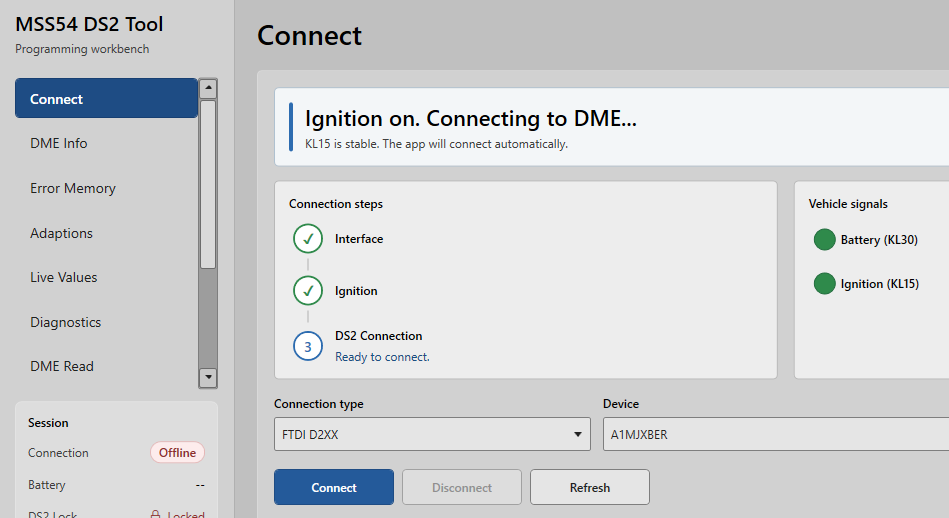

                            I'm not sure if i am helping but with the latest version of the tool and nothing connected to my laptop but with FTDI drivers loaded, KL30 and KL15 are not illuminated.
                            However, as soon as i plugged the USB end of the cable in the COM port but without the OBDII connector plugged into the car both KL30 and KL15 illuminated.
