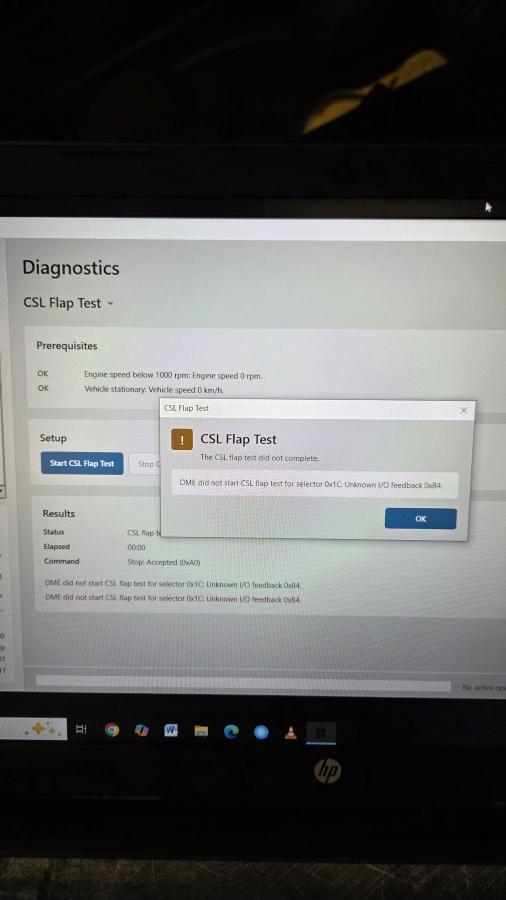

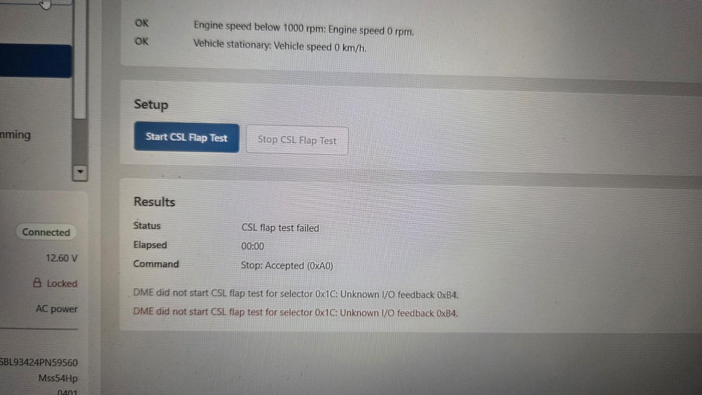

        I tried the CSL flap test with and without the engine running.
        Makes a somewhat loud buzzing sound for less than a second and produces this error message.

        Okay so you got that error because the conditions for the test were not met. The conditions that must be met are:
Name:	Screenshot 2026-05-31 at 4.48.07 PM.png
        b_diag is definitely !=0 because the app is responsible for setting diagnostic mode over DS2 and the app would have errored out earlier if it couldn't set this.
        N (engine speed) must be less that 1000rpm.
        bit 6 of gks_ed must be 0. Bit 6 identifies whether there are any current (active) CSL flap errors in error memory.
        If you're able to validate you were doing the test with the engine not running, or with it at warm idle less than 1000rpm, and also check error memory and see if you have any CSL flap (GKS) errors would be the next step I think.

          Don't suppose you happen to have the DTC for the ebox fan disabled? That could also cause what you're seeing with the test not being able to run.

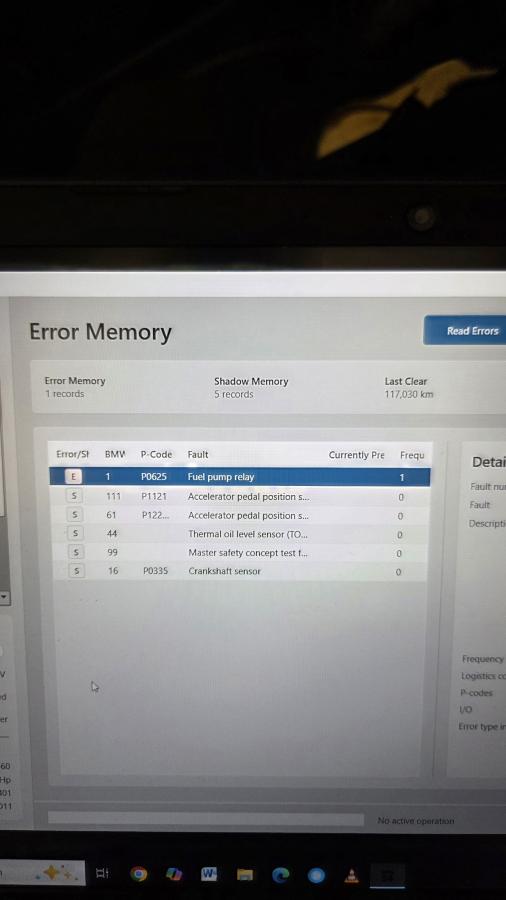

            Interesting, I did have these codes, but cleared them before doing the test, and none were hard faults. I'll give it another shot just to be certain.
            A few months ago I had cracks in my strut tower welded, I removed the DME and also de-pinned all wiring associated with the CSL snorkel as to have the wiring out of the way.
            I have since driven the car and all seems well with the flap but this indeed could be a contributing factor as to why the test didn't run.
            I'll try to sort this out and report back.

              Ah interesting. I'm pretty sure that if you'd cleared them first and they weren't hard faults then it shouldn't have blocked the running of the test, I am fairly sure that the bit 6 in GKS_ED will only be set if the code is active/hard.

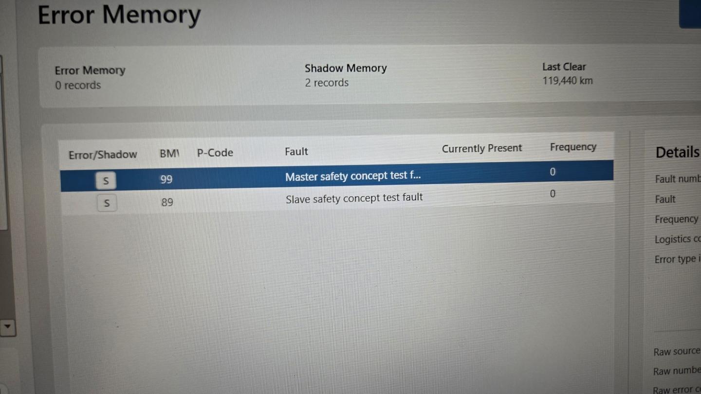

                    I tried once more and had the same type of almost electrical arcing noise for a moment and incomplete test.
                    These shadow errors are indeed now hard faults.
                    I'll explore further tomorrow, I'd sure love to get this test working, must be something with my wiring, odd.

                      With the caveat that I haven't experienced it myself, if you watch YouTube videos of the flap test running that electrical arcing noise seems to be a normal part of the process as far as I can tell.
                      Re shadow codes 99 and 89, they are normal/expected. To check that the error reporting system is working correctly the DME intentionally triggers those two codes on a regular basis as a test. You can disregard them. I've included them for completeness, but you're the second person that's brought this up, I wonder if maybe better for the app to suppress these two codes (or at least note that they are expected/nothing to be concerned about)
                          This is the noise, that makes me feel better as does your explanation of the shadow codes.

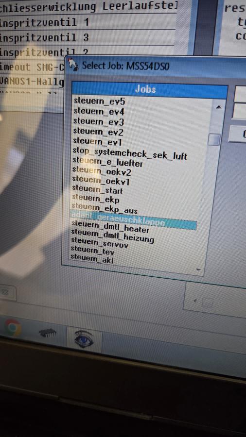

                              I did get the flap to activate using the pictured command in tool32.
                              It "buzzes" for ~4 seconds, stops, I command it again and the flap opens/shuts, same as the video I previously linked. I don't know if that person had to command it twice as I did however.
                              I wonder if that command is finding the stop points, as "adapt" is in the title?

                                Okay great thank you so much - this is it. The test command does indeed need to be sent twice. Found a video on YouTube as well that confirms this. I'll make a fix for this and get it released. Thank you so much for your help with this!!!
