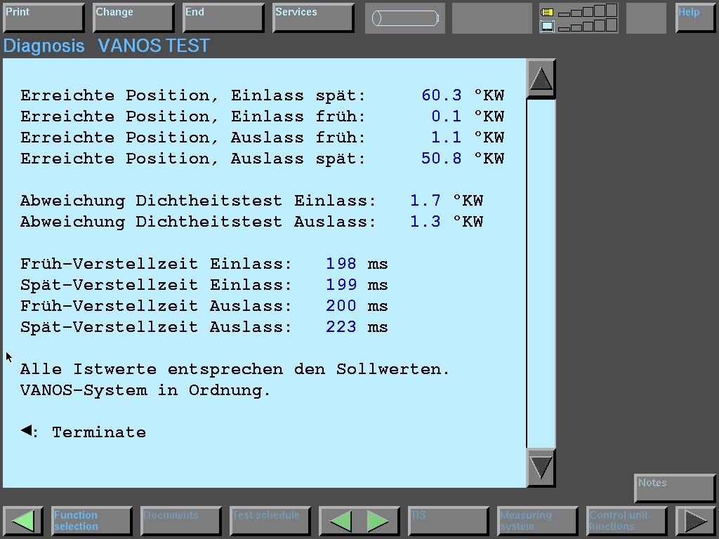

          karter16 there was a thread on M3F where a few people posted their VANOS test results. On healthy units, a fast response was around 190-225ms. Between 250-300ms was considered average to slower and over 300ms was considered slow. IIRC, almost all VANOS tests in that thread were below 300ms.
          Thanks for this I knew that we'd collectively arrived at some conclusions but couldn't remember what they were!

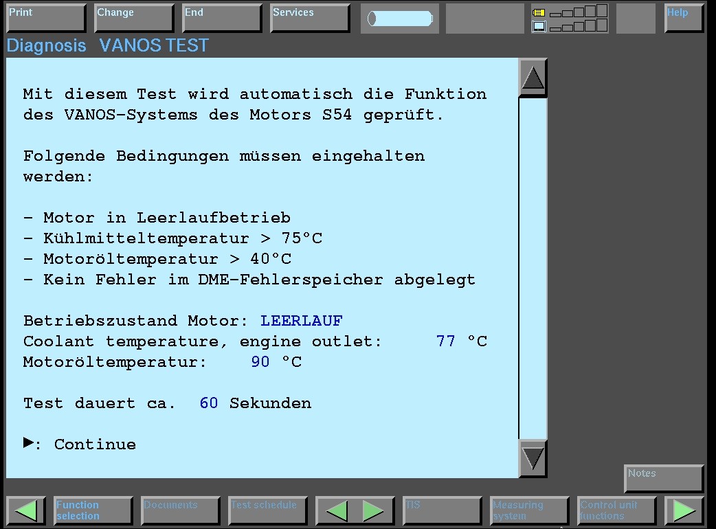

                Stop the presses. The DIS VANOS test prerequisites are:
                Engine running at idle
                Coolant temp > 75°C
                Oil temp > 40°C.
                No errors in the DME - I don't think that is very useful. Perhaps an override for that, for those of us who do not want to clear the fault memory to run the VANOS test?

                  Here are some DIS VANOS test reference results i got back in December 2024:
                  Click image for larger version  Name:	DIS v57 Revtor-2024-11-25-15-04-31.png Views:	0 Size:	23.9 KB ID:	356954
                    #99

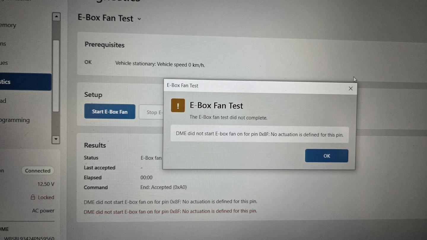

                          Also tried the ebox fan and got this:

                            huh interesting. works fine for me. although that's the error message I get if I try the DMTL test (which is not installed on my car). I wonder if not all cars handle the e-box fan in the same way?
                              I'll see if there if maybe ISTA can activate it, I may have some type of fan or wiring issue as well for all I know.
                              Nice program though, very streamlined!
                                Coolant temp > 75°C
                                Oil temp > 40°C.

                                nice one! I don't know where I got 80 degrees from then!? could have sworn that's what it was for ISTA when I checked, but checked again and it's 75 there too. Will amend. Yeah I decided the no errors in the DME condition wasn't worth doing, especially given people are probably running these tests when diagnosing an issue, it didn't seem like a realistic condition. I get what they're saying in that if there's an issue with the module being tested the test won't be successful, but that's kinda the point haha.
