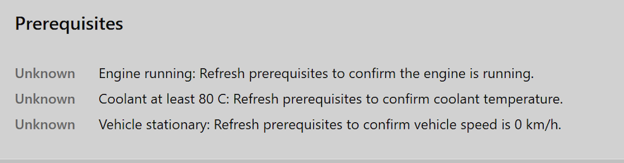

      Run on a not-very-warm car so don't worry too much about the actual values.
      IIRC, DIS doesn't let you run the test unless the engine is past some temp threshold. Maybe worth adding a similar check to your test?
      Otherwise someone will inevitable run it on a cold engine and misinterpret the results.
        #78
        hahaha correct - I actually built in the check to begin with, and intentionally disabled it so that I could run it for testing purposes, it's back in force now :-)

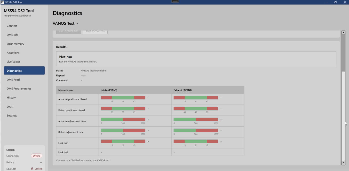

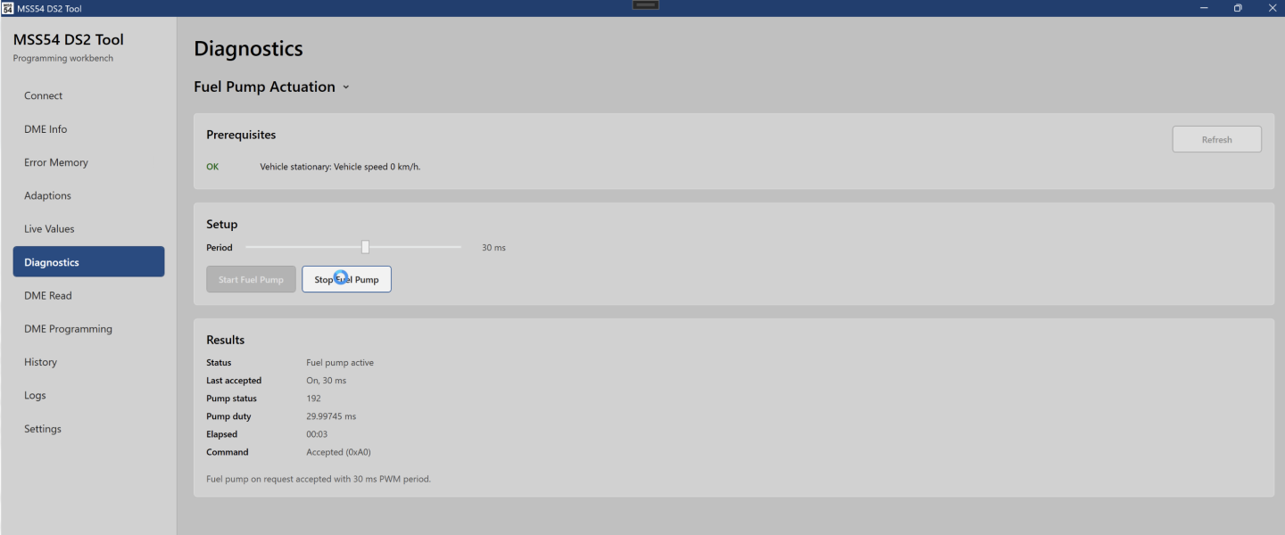

            Version 1.2 is now available and supports the following diagnostic functions:
            • CSL Snorkel Flap test
            • DMTL Leakage test
            • E-Box Fan test
            • Electric Fan PWM test
            • Electronic Throttle Control
            • Fuel Pump Actuation
            • Idle Speed Control
            • Rough Running / Misfire Detection
            • Suction Jet Pump test
            • VANOS test
            Disclaimer: I do not have a CSL snorkel, and I have a Euro car so don't have the DMTL system. The tests are executed in the same way DIS/INPA does, but I'd greatly appreciate someone testing and confirming that these function as they expect.
            The other functions are tested and confirmed to work.
            Second Disclaimer: I'm not actually super familiar with these tests, so if anyone has any ideas about how to better present the data, etc. I'm all ears! (One thing I do think could be a good idea is to have an "amber" region on the VANOS test colour bars that are the tighter, community agreed, metrics that are ideal. the standard ranges ISTA/INPA/DIS assess against for what's "ok" is quite wide)
            Sample screenshots:

              Thank you for the tests. Unfortunately i do not have the wiring in for the CSL Flap test.
              I am running one of Anri's 70°C thermostats. So even after some spirited driving, the motor temperature once i had parked on the driveway was an annoying 79°C, just below the VANOS test's 80°C threshold. So i turned the A/C on and performed an engine fan test at 10% for a little while to raise the engine temperature.
              Would it be possible to display TMOT in the Engine Fan Test?
              I did think about requesting a temp override for the VANOS test but that would skew the community's VANOS test results.
              The VANOS test amber zone sounds like a great idea.
              Are the test results recorded in any of the logs?

                              karter16 there was a thread on M3F where a few people posted their VANOS test results. On healthy units, a fast response was around 190-225ms. Between 250-300ms was considered average to slower and over 300ms was considered slow. IIRC, almost all VANOS tests in that thread were below 300ms.
