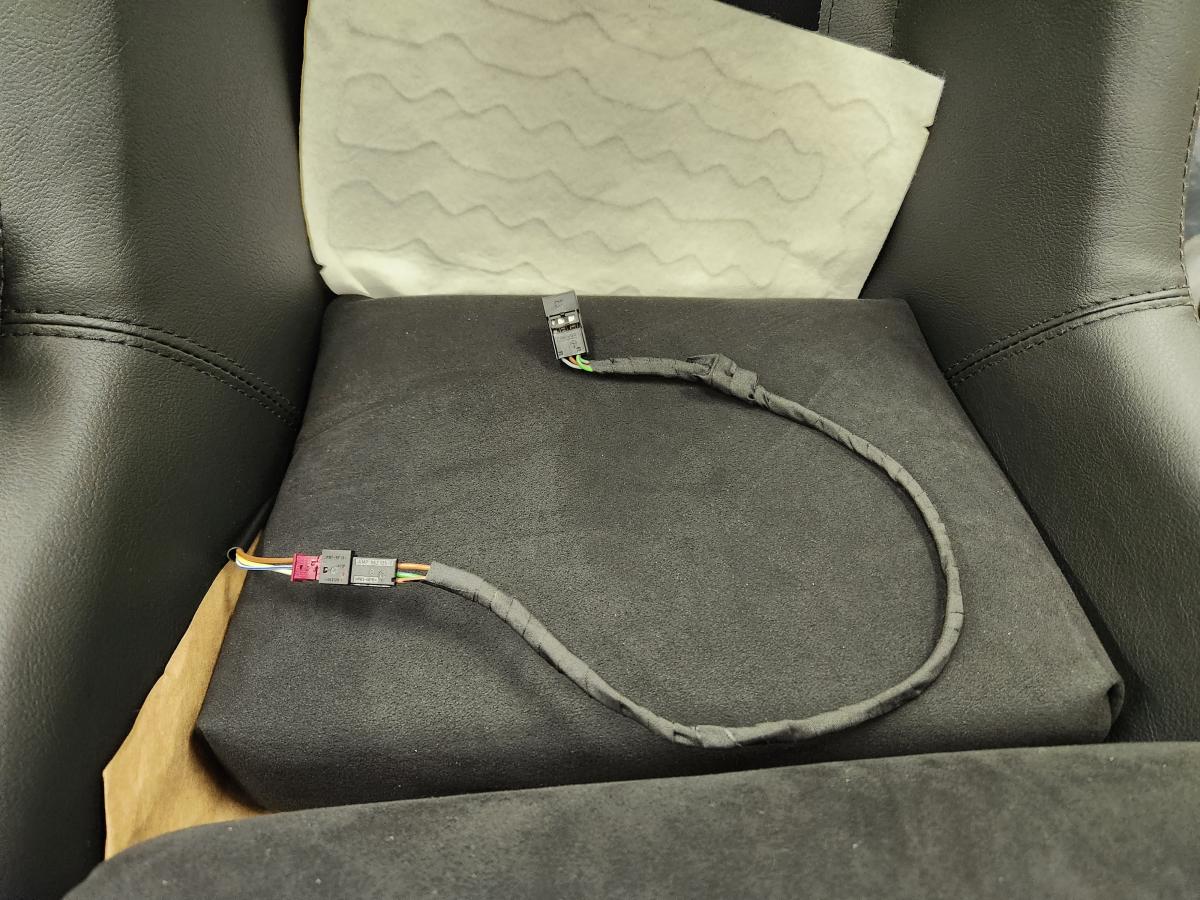

                    Finally got some seat heat action that works pretty well, a factory E39 M5 mat provides heat to the bottom and lower back. The great thing is the connector on the M5 seat heat will fit a stock E46 harness with one little tab shaved off.
                    Added a third pin to what was a 2 pin connector and stuffed the seat heats into the cushion, no upholstery work required for this which is awesome.
