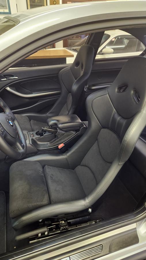

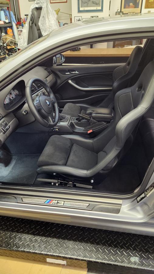

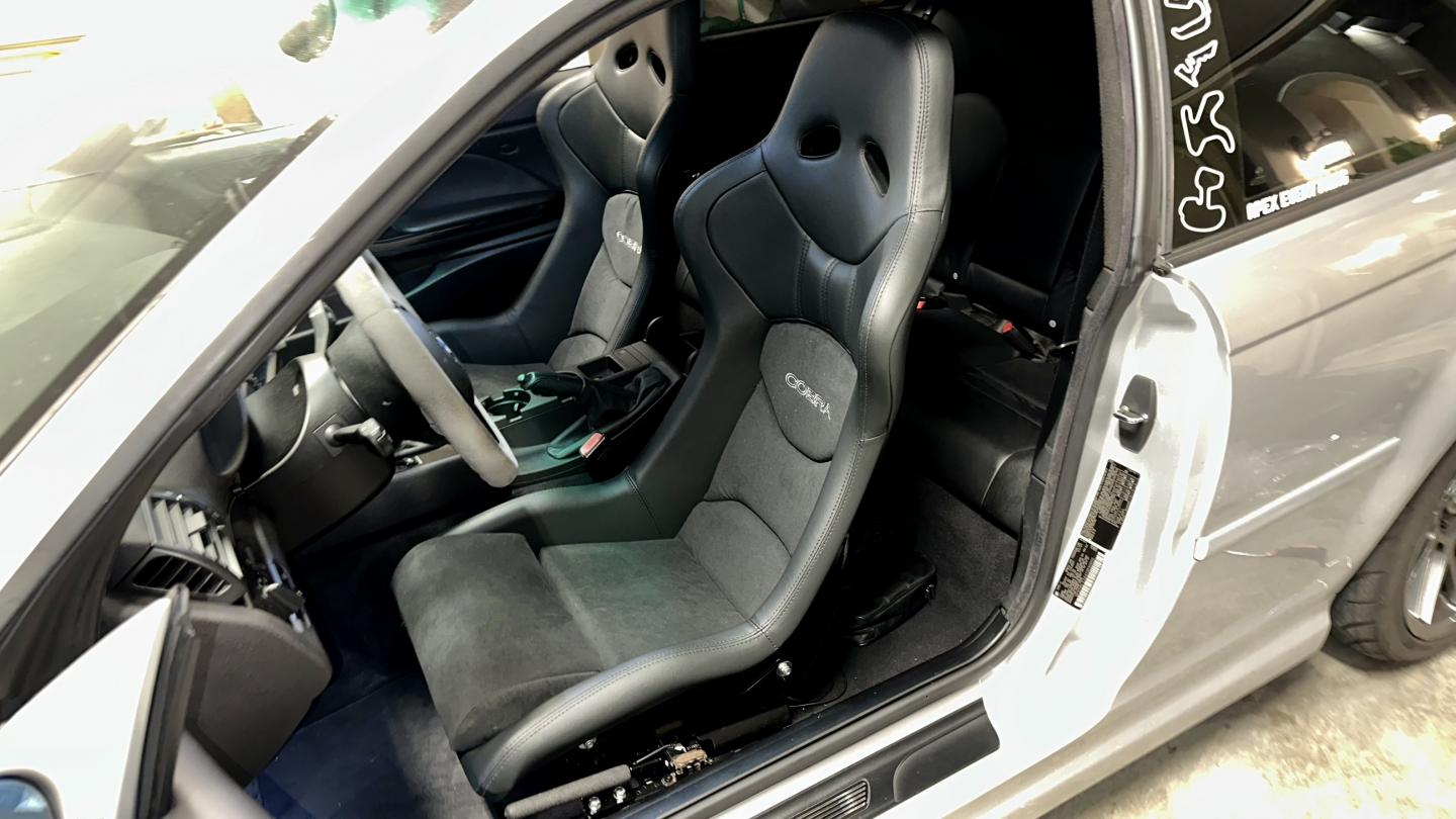

    Cobra seats installed with seat heats, glad I went a bit further to install the heating pads.
    Only complaint is the reclined posting sits me too low and the upright postion is a bit uncomfortable. I added as much padding in the seat cusion as I could fit to sit up higher. I suppose it is what it is.
    I may contact Brey Krause and see if I can get some brackets without seat mount holes drilled and then I could situate the seat to my liking.

      Looks great, may I ask how tall you are?
        Thanks, I am 5'10", I guess about average height, not tall enough for these in the E46 apparently.
        Have a set in a Porsche and I sit up higher but thats not a direct comparison.

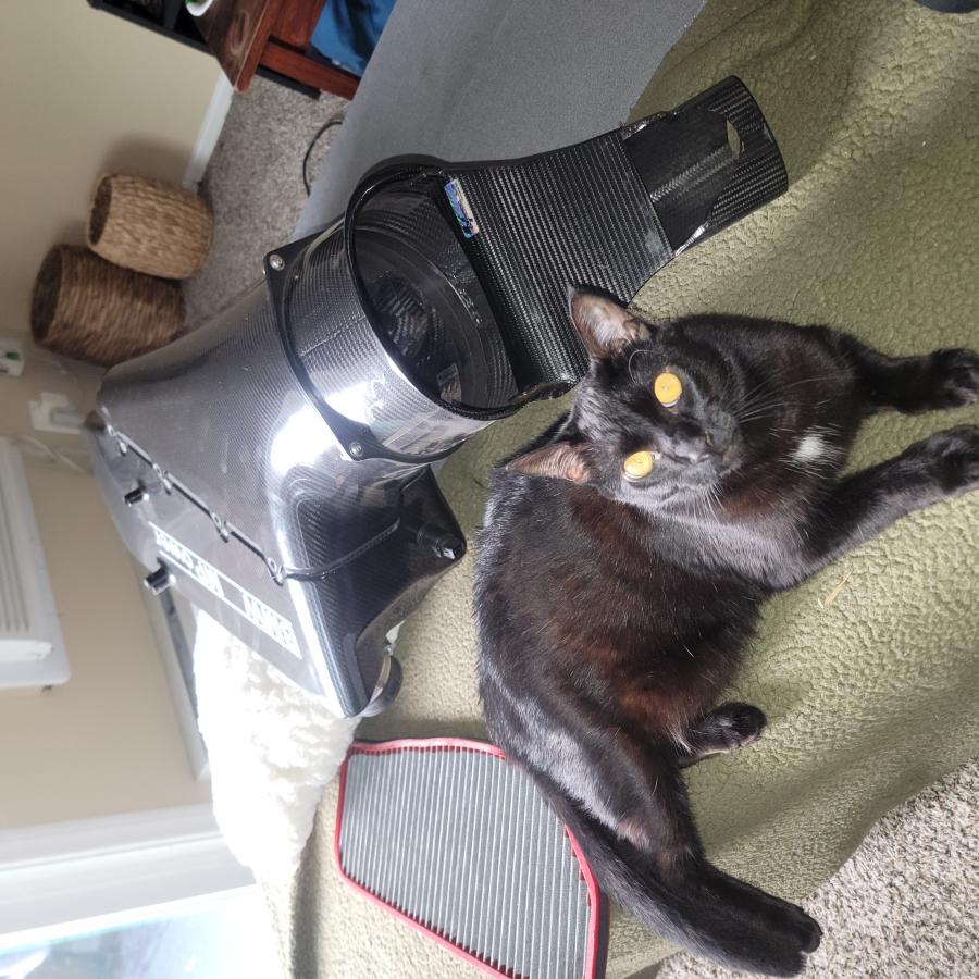

            Bought it another companion!

              Badass. Are those intake ducts replacing the front reflectors?

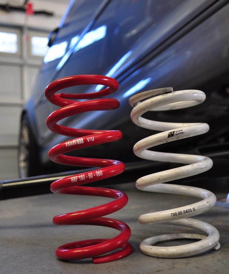

                Despite being pretty happy with 7" 325lb front springs (bottomed out on GC perch, they went down to 13.6"), I had moved up to 400lb (6.25" tck), but realized it was too much, and ride height was 13.37". Got around to going back down, this time to 180mm (7.08") 60N/mm (342.6lb) H&R coils. Drop in rate allowed me to go back to medium position on hotchkis bar without the understeer I was previously experiencing with the 400lbs springs. Even on full soft on the MCS, car feels so great. Hit the canyons yesterday and car just gripped so damn well. Went up to a true 13.5" up front (from 13 & 3/8") which helps, but the 550lb rear springs at 13 & 1/8" ride height still have me scraping the ground on some of the dips in the faster sections. Need to go to 600lb + in the rear soon.

                  They are, but they don’t really do anything besides throw air under the hood. Planning on replacing with the stock pieces. Parts like those and maintenance for this thing are unbelievably cheap, like 20% of the price of equivalent BMW stuff 😂
                      Click image for larger version Name:	HR343lb (22).jpg Views:	16 Size:	66.4 KB ID:	204786
                      I ordered Eibach 400 lb/in springs (6.69”) to pair with the 700 lb/in springs in the rear after going thru your journal. Now I’m worried I won’t be happy with the result. 😅

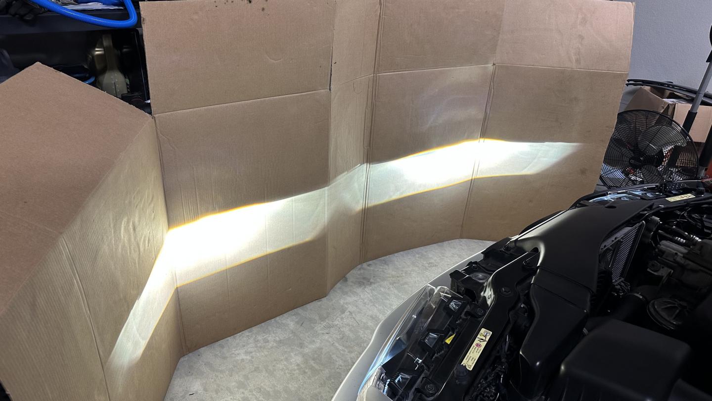

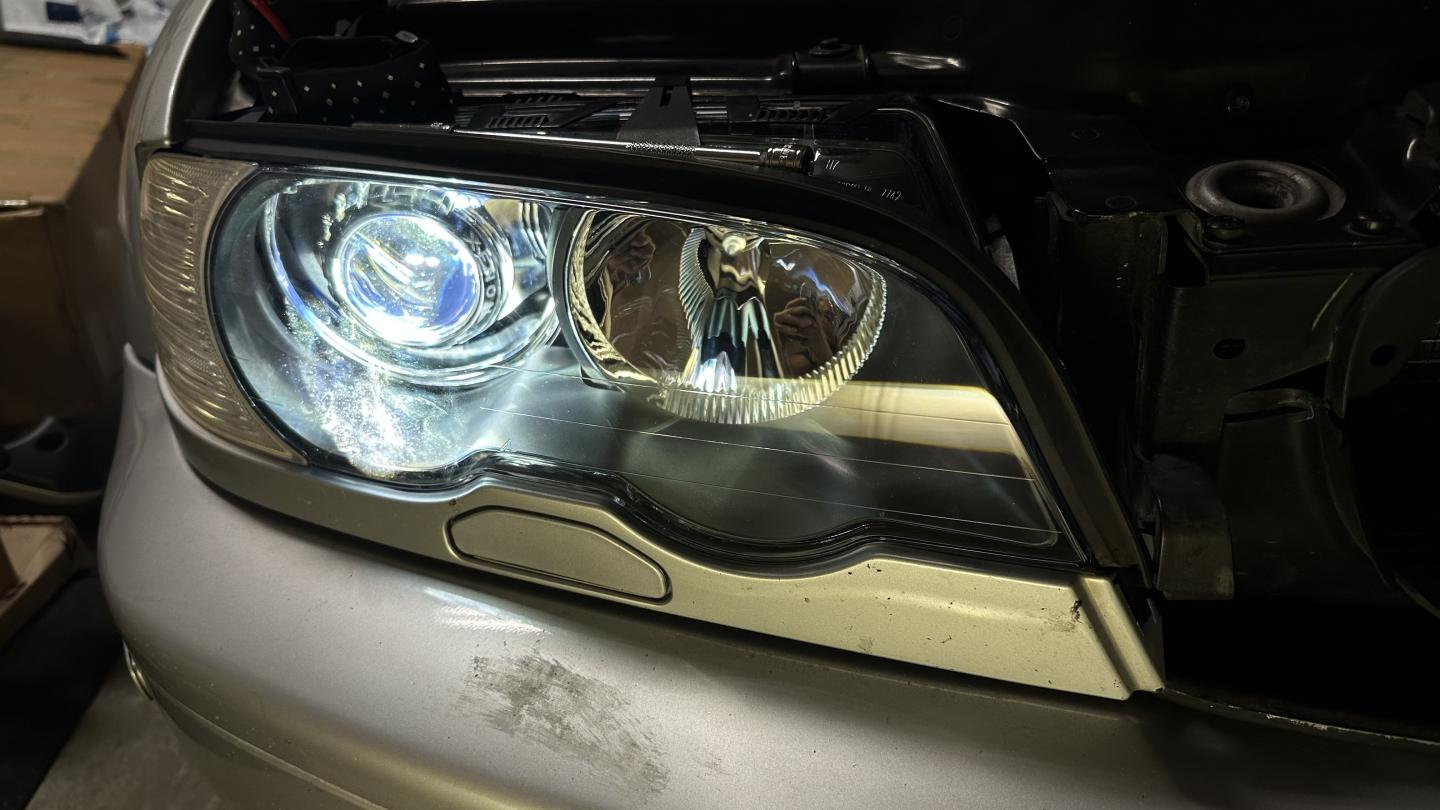

                        Installed Nogaros on manual sliders. So glad I found a set with black stitching - looks great. Also upgraded the OE single xenon projectors to Morimoto Mini projectors. I get quad high beams now when the low beams are on, which is great for my night driving needs.

                          I’m also looking to get the Morimoto projector upgrade. Did you do the upgrade or send them in? Also was it a major night driving upgrade over the stock Xenon when just using the low beams?
                            Your car might be a little heavier than mine (I've deleted a lot) plus 400lb will go much better with 700lb than my 550 or even the 600lb/616(11kg) I plan to run next.

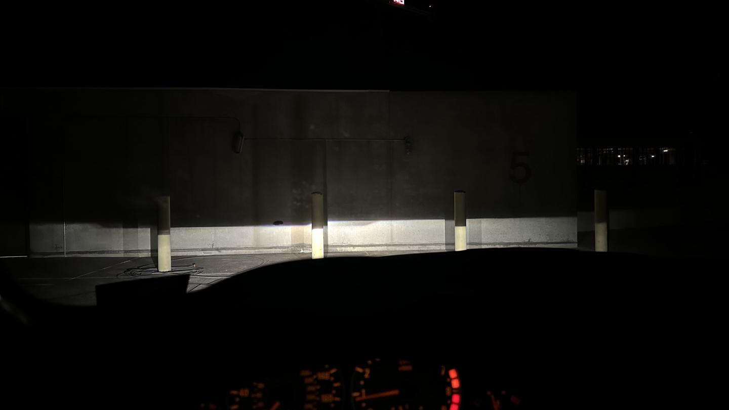

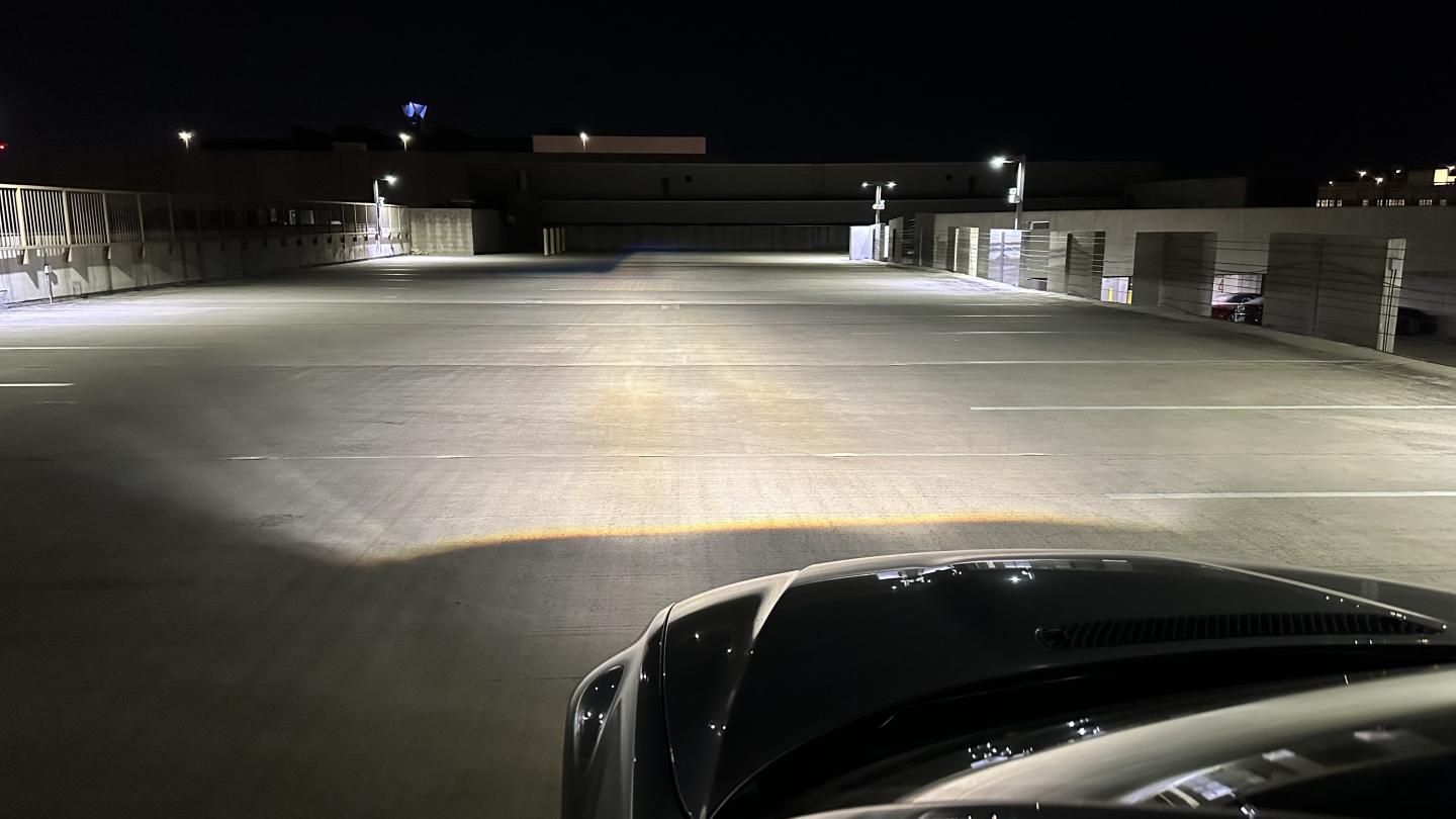

                              I aimed the headlights properly last night. Huge upgrade over the stock single xenons, as well as the bi-xenons on my 05. The quad high beams are insane.
                              I DIY’d, but if I could go back I would pay the $300 or whatever to have Lightwerkz install them.
                              Low Beam

                              High beam
                                Did you say your low beam is now replaced with quad highs? So the lighting you're showing is the minimum lighting amount and it'll get even brighter with high beams turned on?
