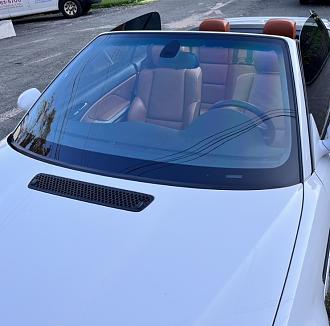

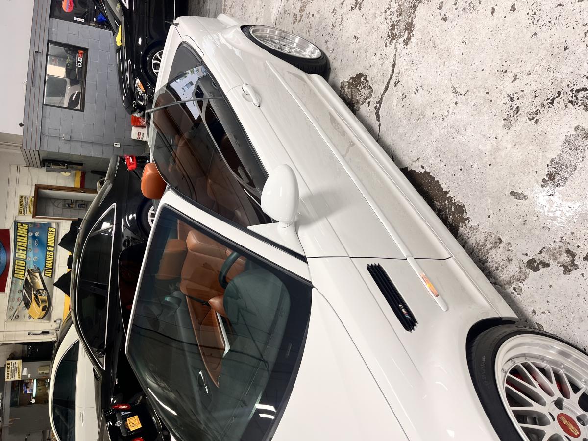

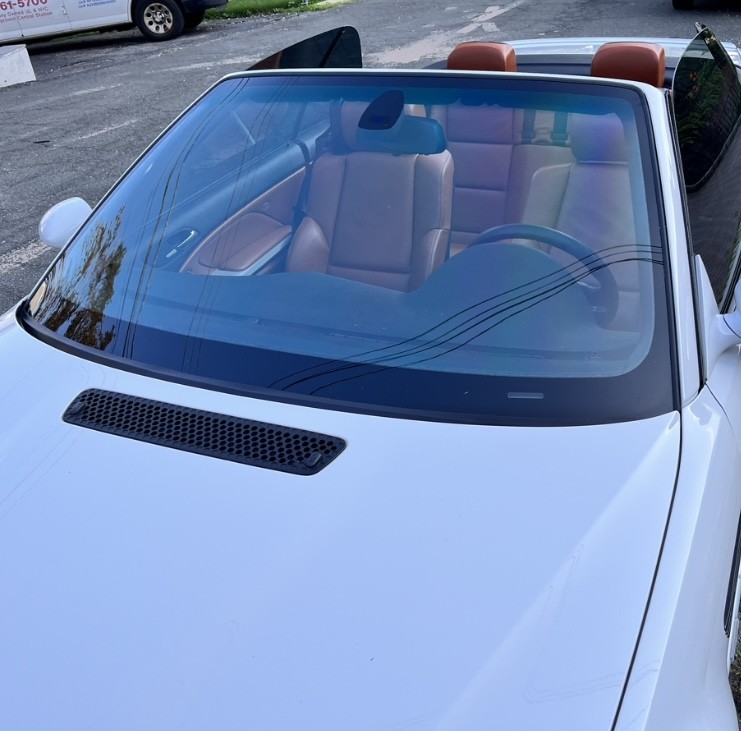

    And here is my custom Euro cats version installed
      I know most aren’t a fan of window film, but I decided to have Xpel XR prime installed. The glare from these modern day SUVs is completely unforgiving. So at night I like to roll my windows up even when the top is down.
      I am also impressed with the heat rejection. The temps today were near 90 and the sun was strong!
      The specs are:
      20% XR all around
      80% Xpel blue complete windshield.
      edit - the wipers were removed by me for new oem windshield installation and film prep.

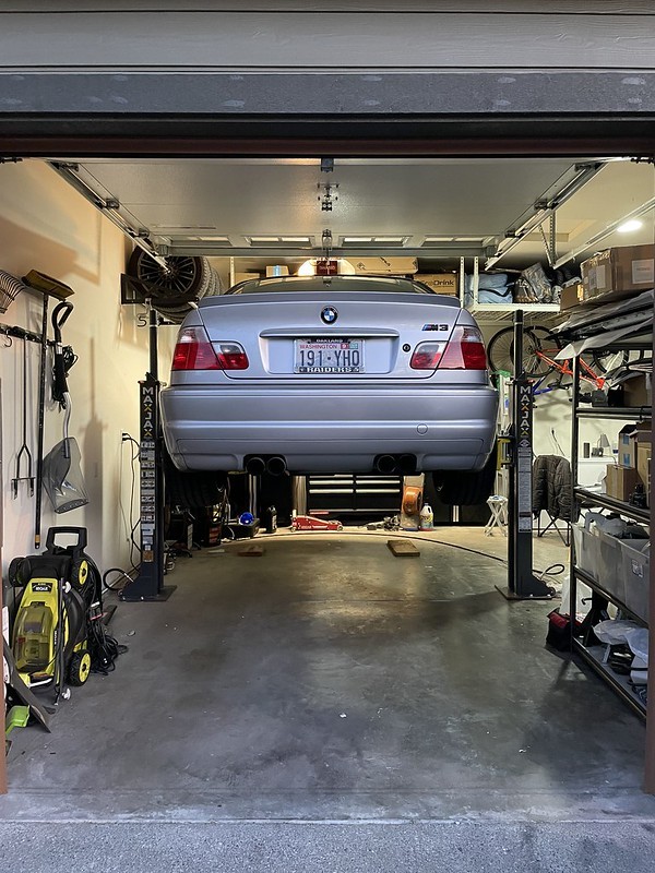

        Finally installed my Maxjax

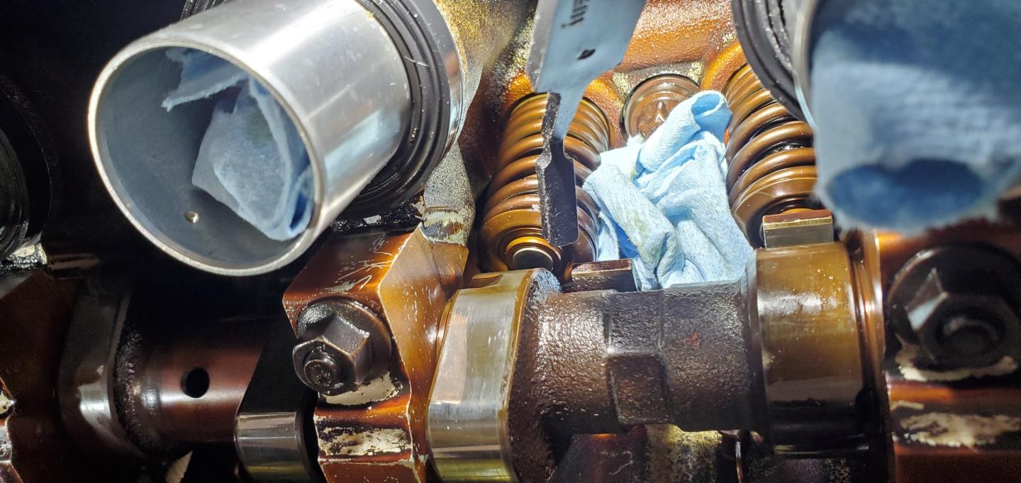

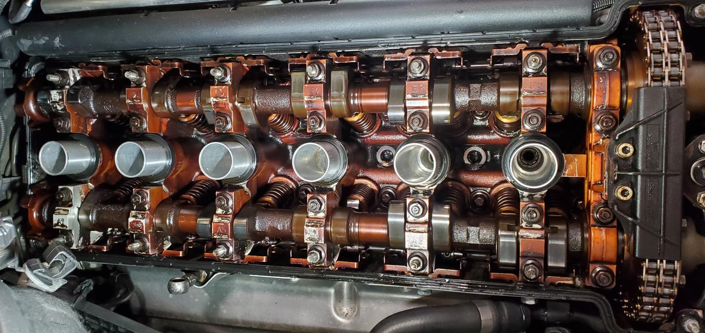

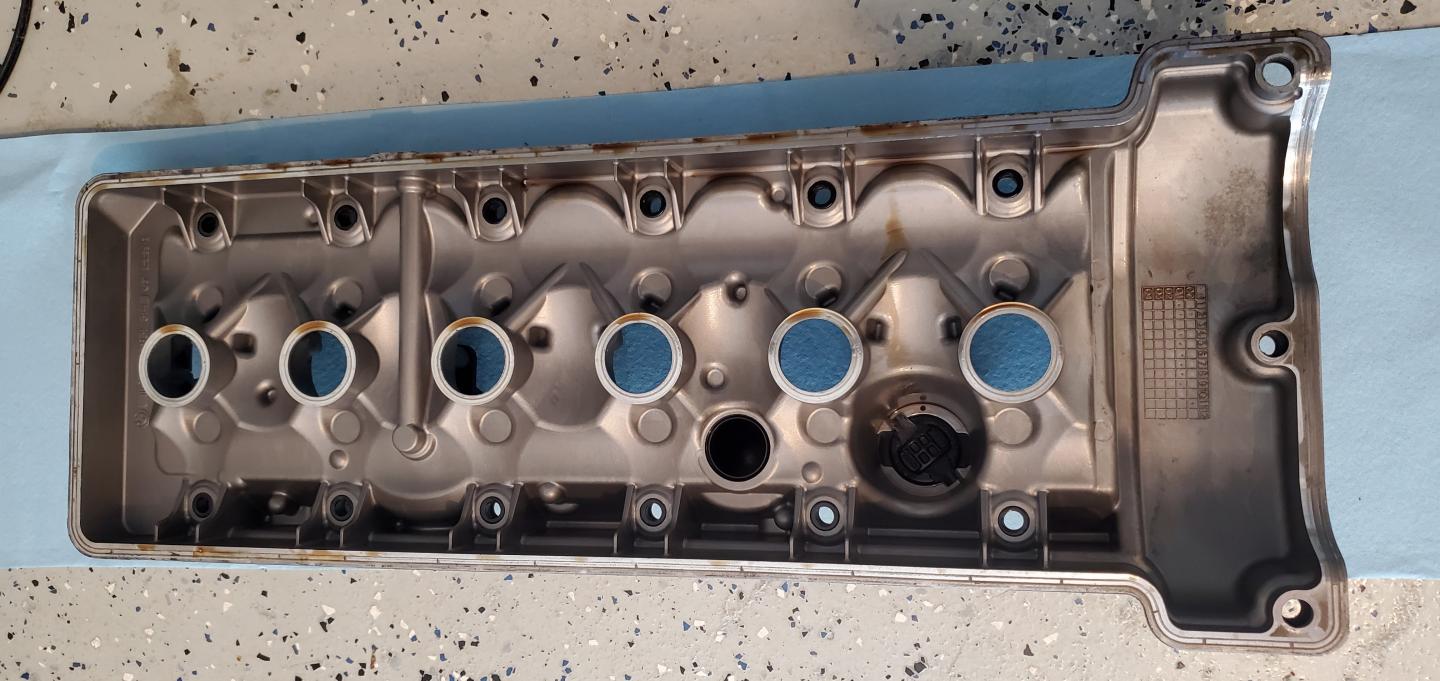

          Valve clearance check and adjustment yesterday. The engine has 172,xxx miles on it. Been a minute since I've done a valve clearance check.

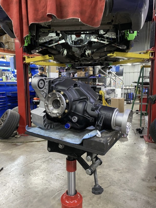

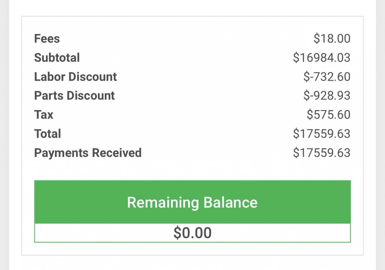

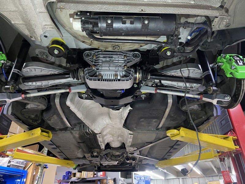

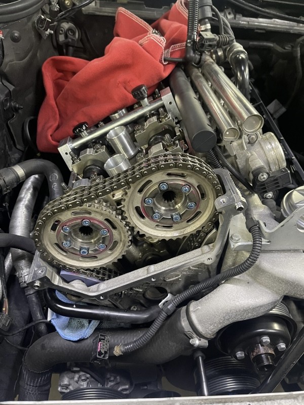

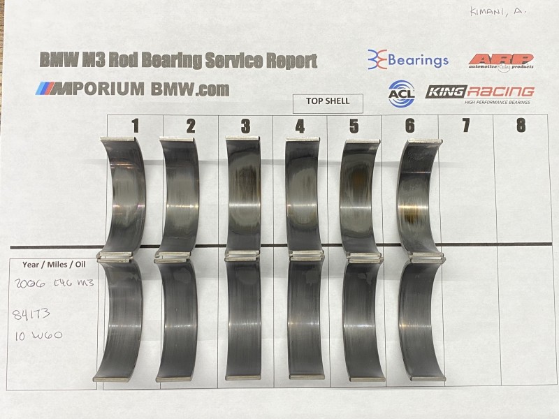

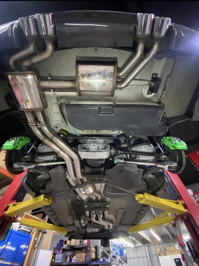

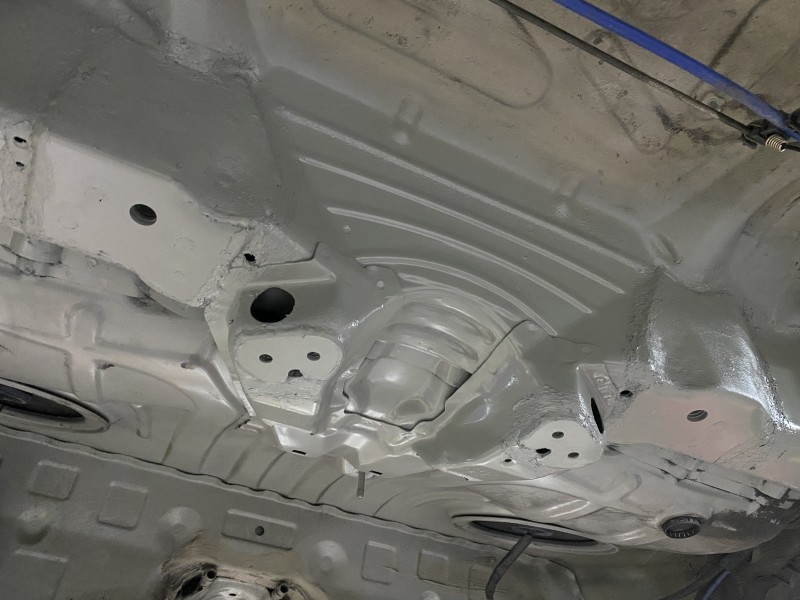

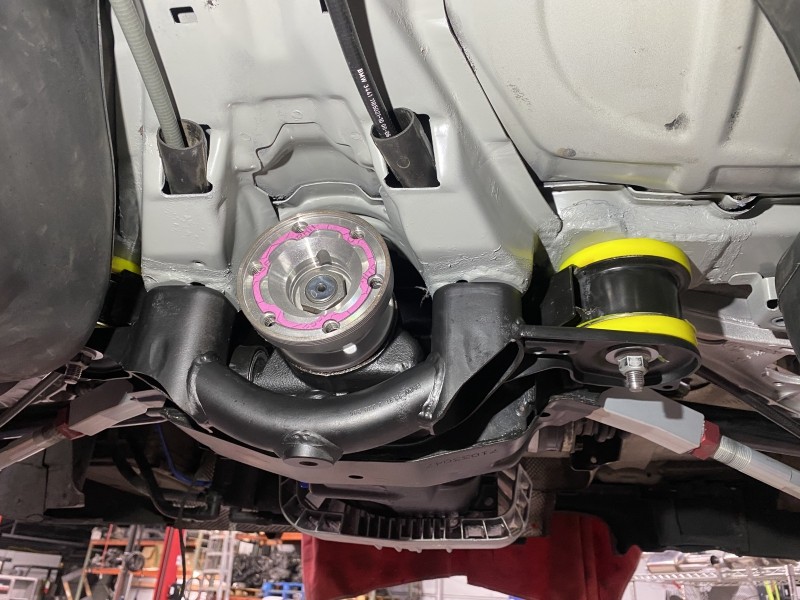

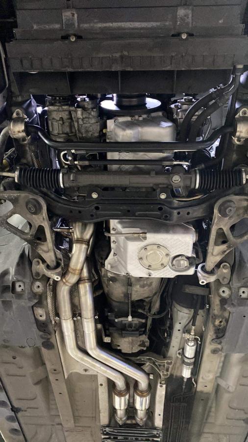

              I kinda went all in 😅
              big 3 and everything around it

                Yes indeed you did... good to see someone still rocking the Borla (EDIT: apparently not, I stand corrected).

                    Talking about exhaust? It’s the supersprint race (full headers to sec3 are SS 63.5)

                      I notice you're running both resonated sections. I started off just running the resonated section 2, and I ordered the resonated section 1 last night. I was planning to run the straight section 2 with it though... do you have any sound clips?

                        I would imagine with the 63.5mm system that section 1 is catted and not resonated right? I wasn't aware that SS made a 63.5mm resonated section 1, that would be cool though.
                        I too would love to hear the sound it makes, sometimes I want to take off the quiet Scorza Sec.3 in favor of an SS Race just to see if I can get more "quality" volume, but in a good way, my car is very quiet exhaust-wise, but you do hear the airbox better.
                          044012 is the straight section 1
                          044022​ is the resonated section 1
                          044002 is the catted section 1
                          These are all 63.5mm and will fit to the 044001 header​

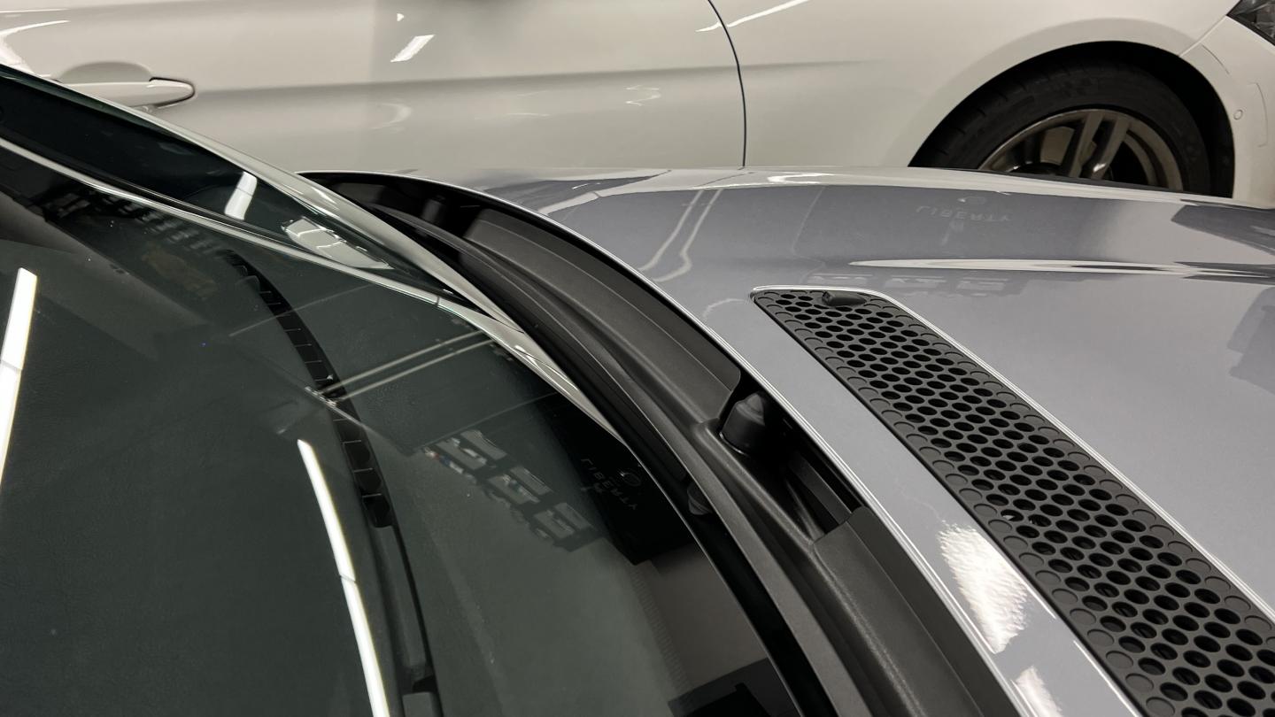

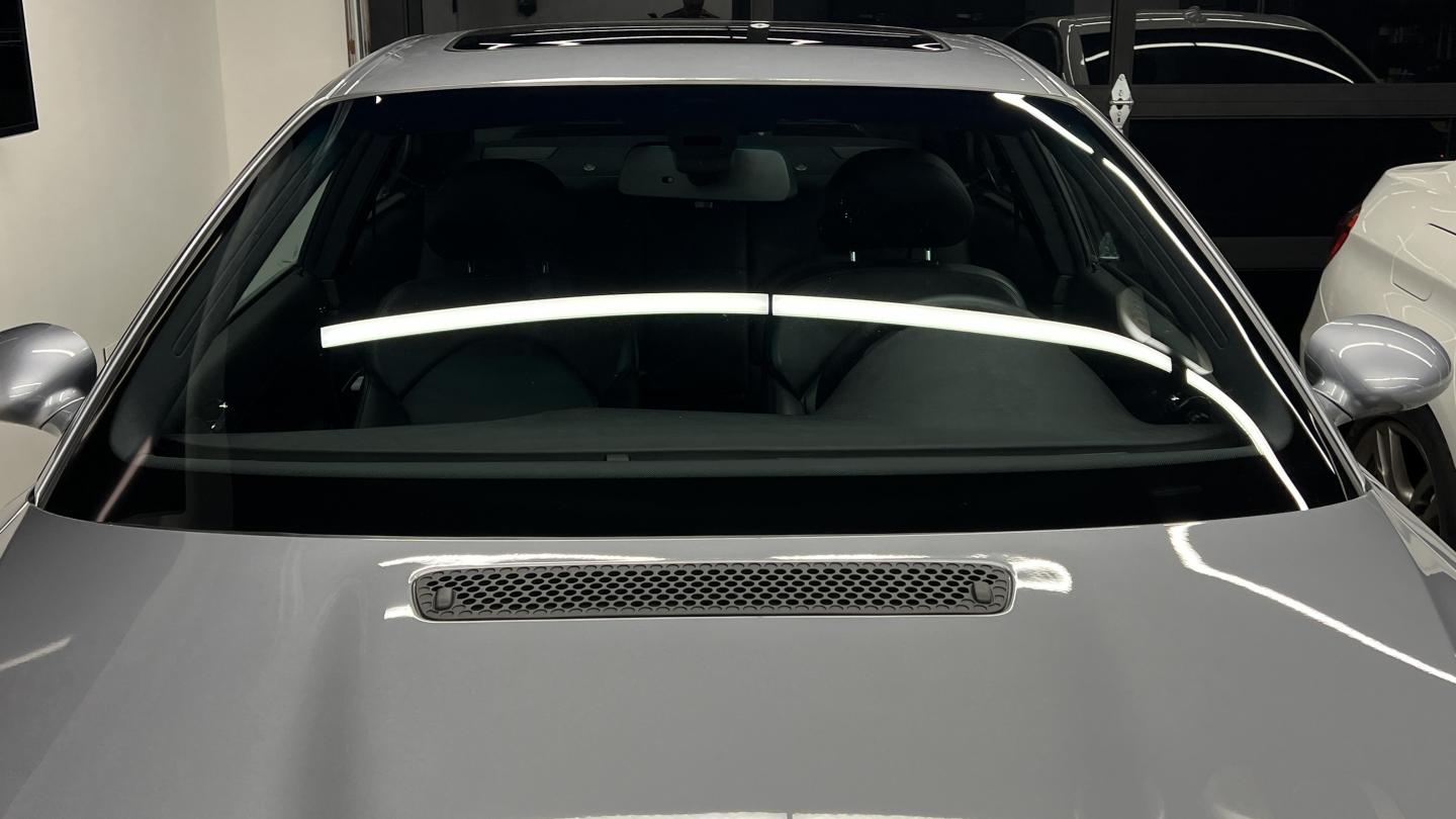

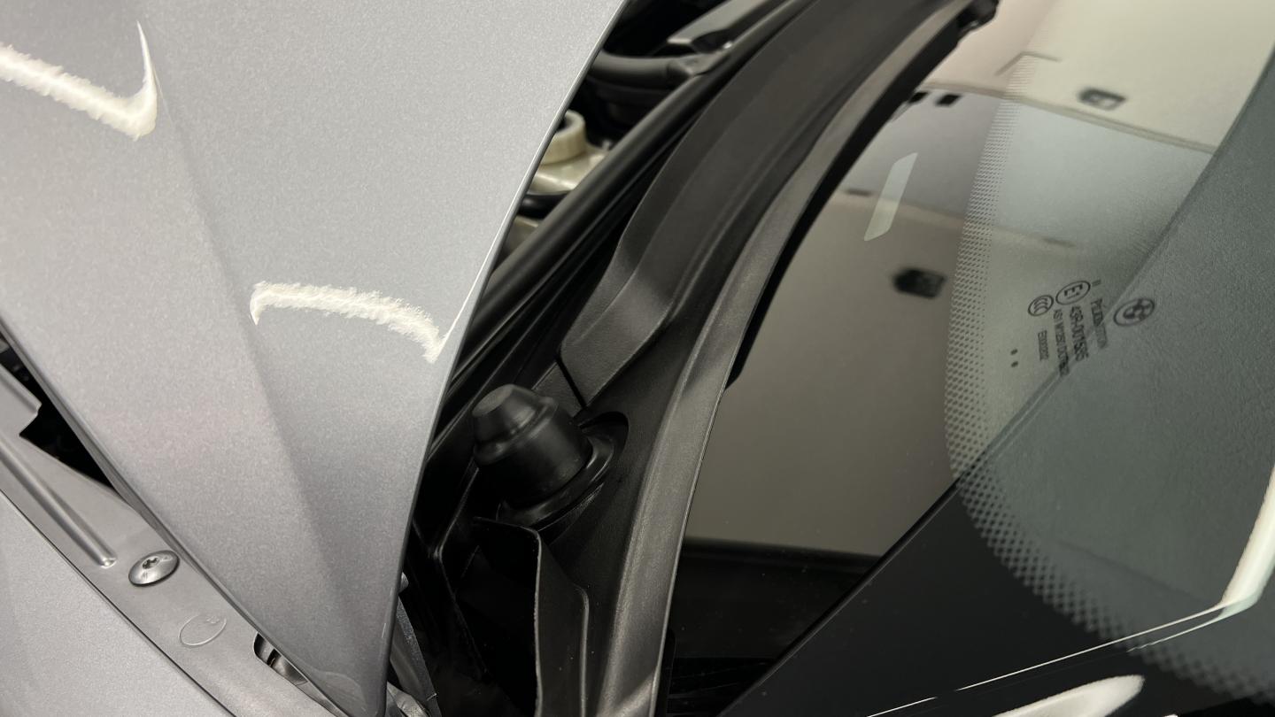

                            Windshield wiper delete + threaded wiper delete caps.

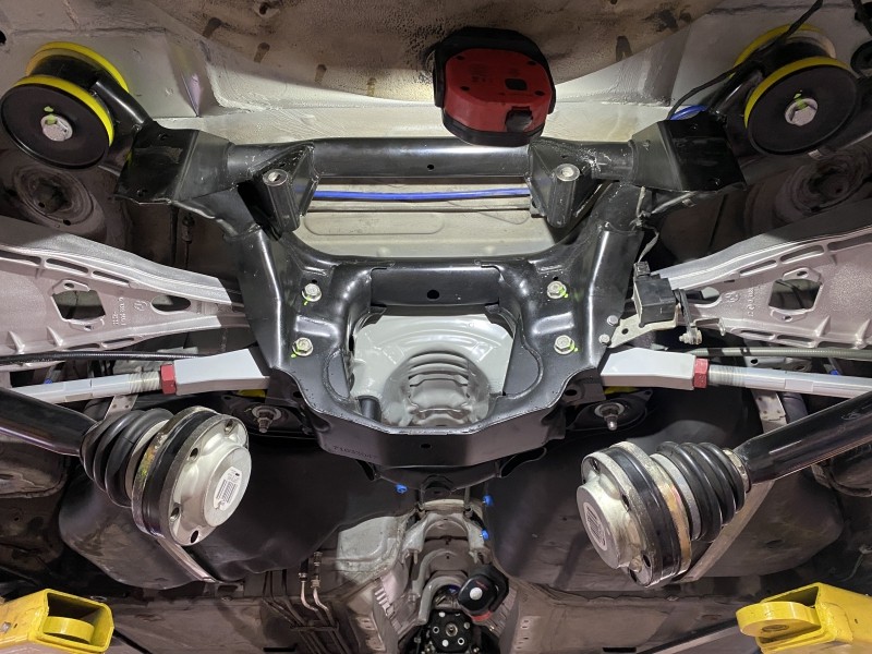

                                Are the bearing at 84K miles? Look not bad.
                                I would not be happy to see the heavy output shafts loading on the CV joint balls and can cause dinted surfaces and noise. They should be supported.
