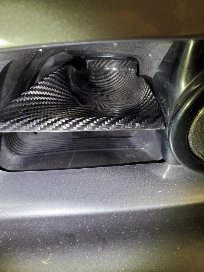

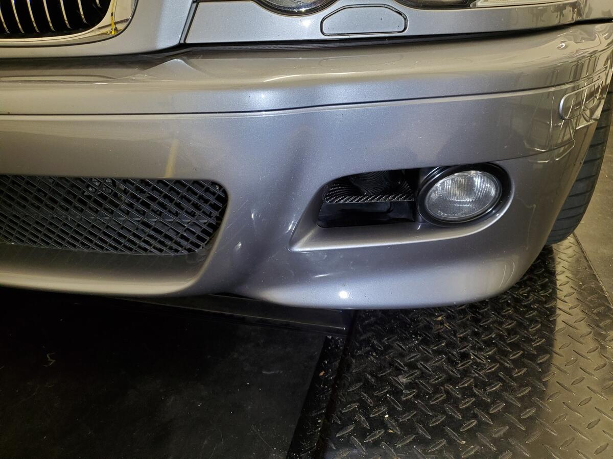

    Popped in the Eventuri scoop to hopefully lower the intake air temps a but, looks as though it should do its job.

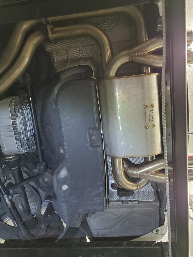

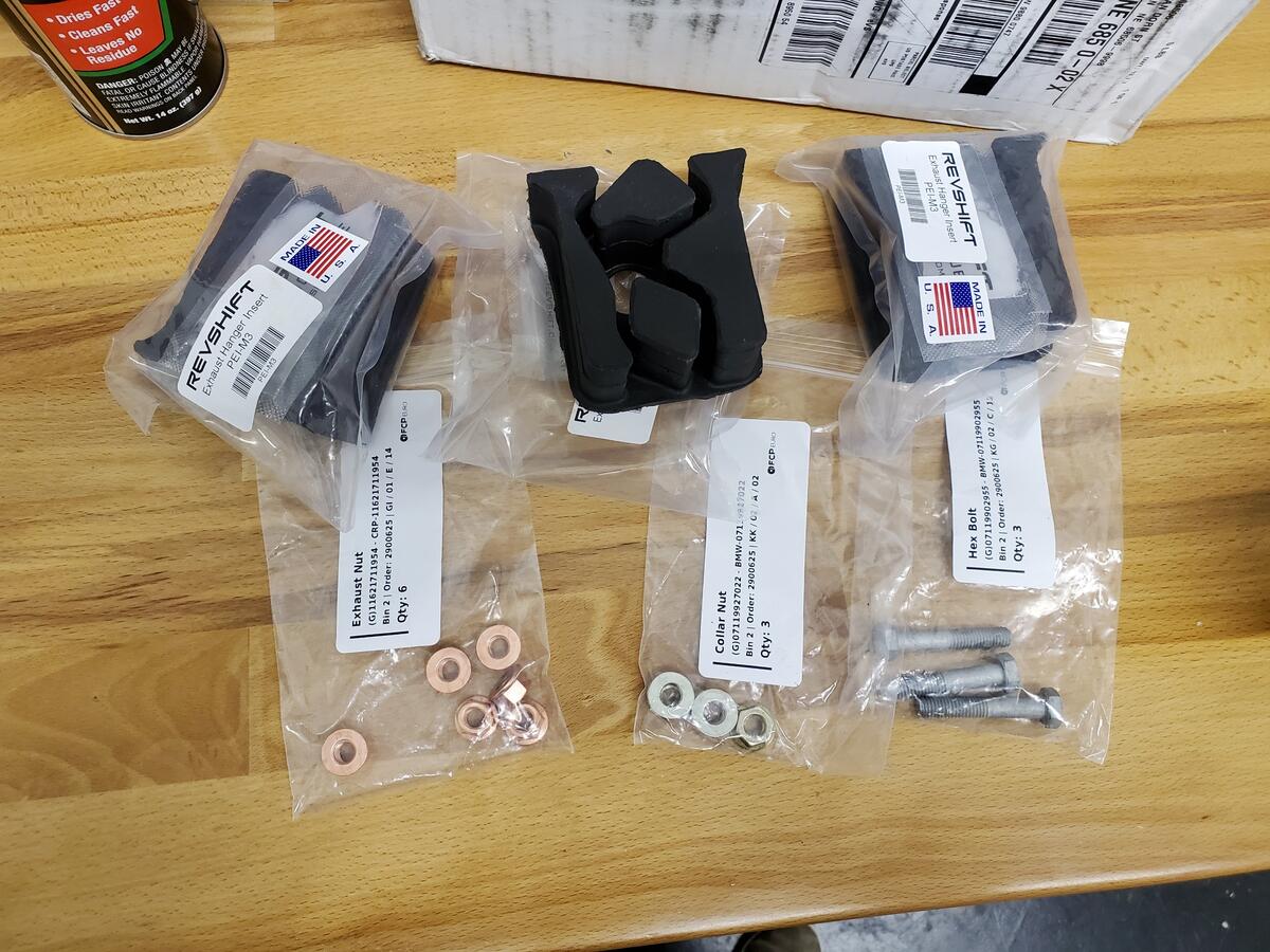

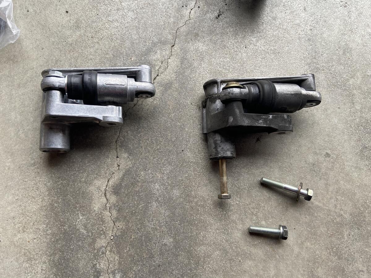

    Also am out here in the garge about midnight bored, going to install these Revshift muffler hanger inserts as my muffler keep banging into the black plastic box directly in front of it, by the way...what's this box for?
    The SCZA muffler is extremely close to the "black box"/heatshield so anything short of solid hangers likely won't stop it from contact.
    I may end up placing some sort of heat resistant material between "black box" and muffler if this doesn't help. New hardware as well, always a good thing.
    What's in the box??

      What's in the box??
      evap charcoal canister

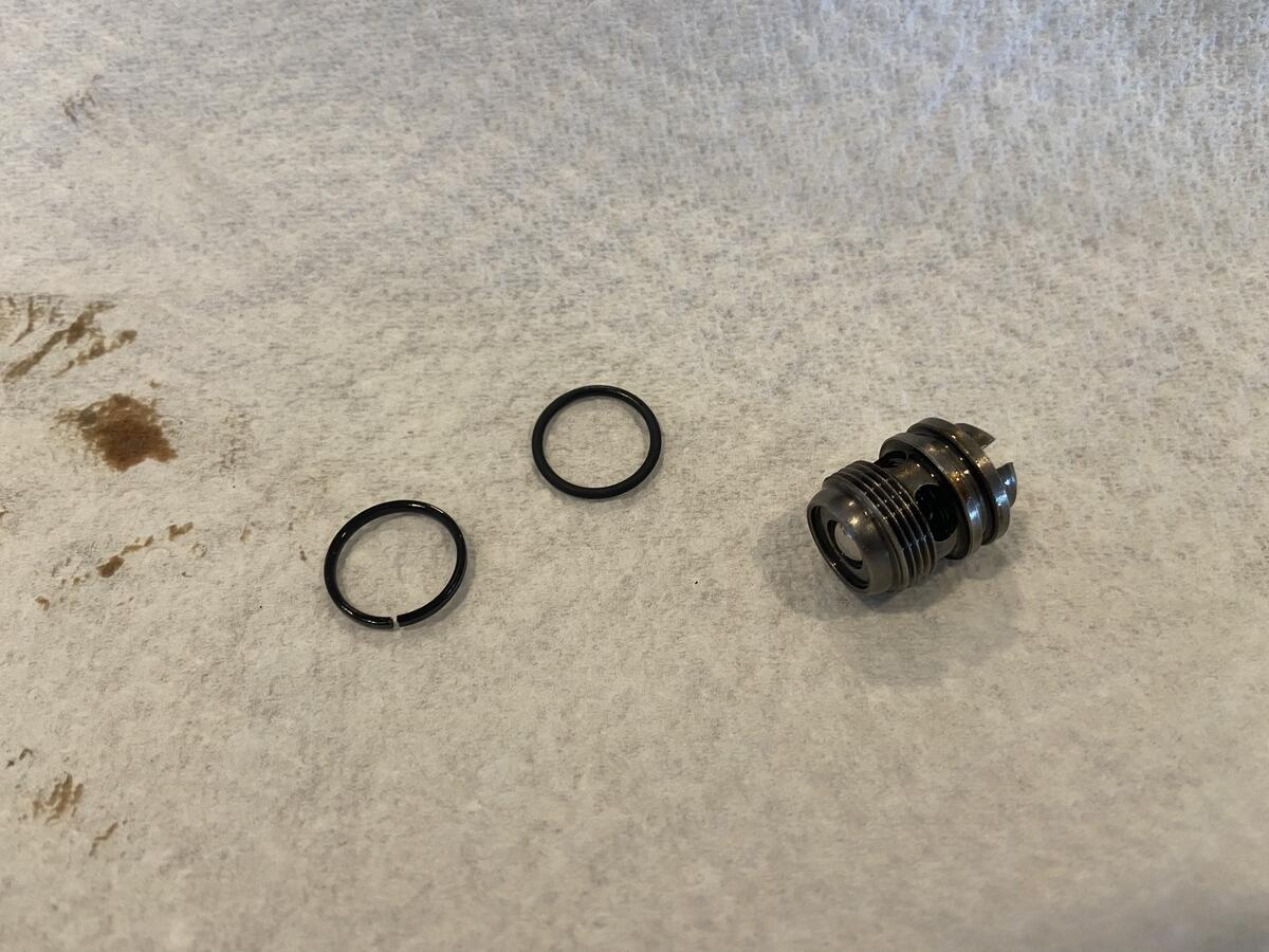

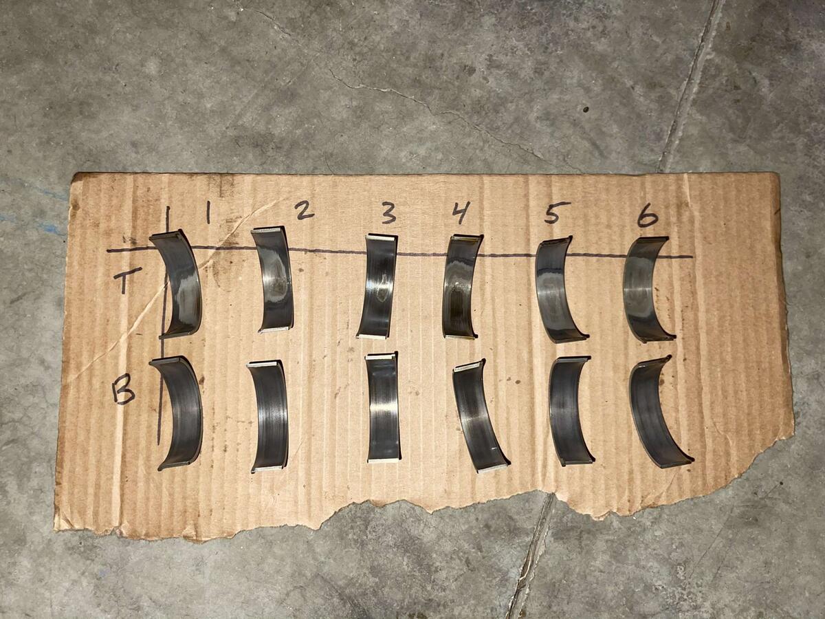

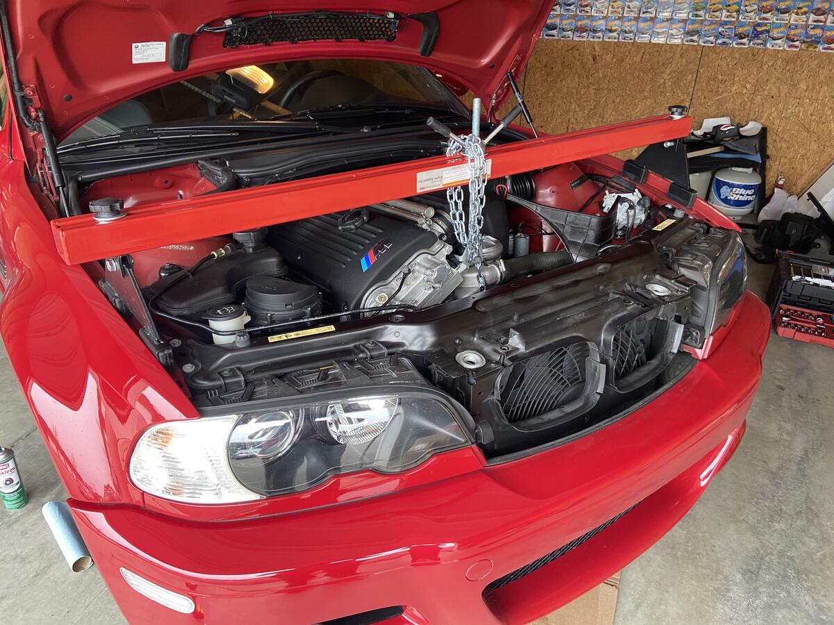

            It was rod bearing weekend for me. Which also included a transmission fluid change, new motor mounts, steering guibo, CPV o-ring, and new belts and tensioners.
              I have found that my system lengthens at operating temp so perhaps check underneath after driving - that may alleviate some concern. Of course if you have rubbing noise then I can understand the need to address immediately.
                Those Revshift inserts are a great idea but once inserted don't allow the hangers to fit in their metal holders unless you bend them up, alot.
                I cut up one of the Revshift inserts and used a portion of it on the passenger side hanger and this was fortunately enough to keep the muffler from contacting the evap. cannister.

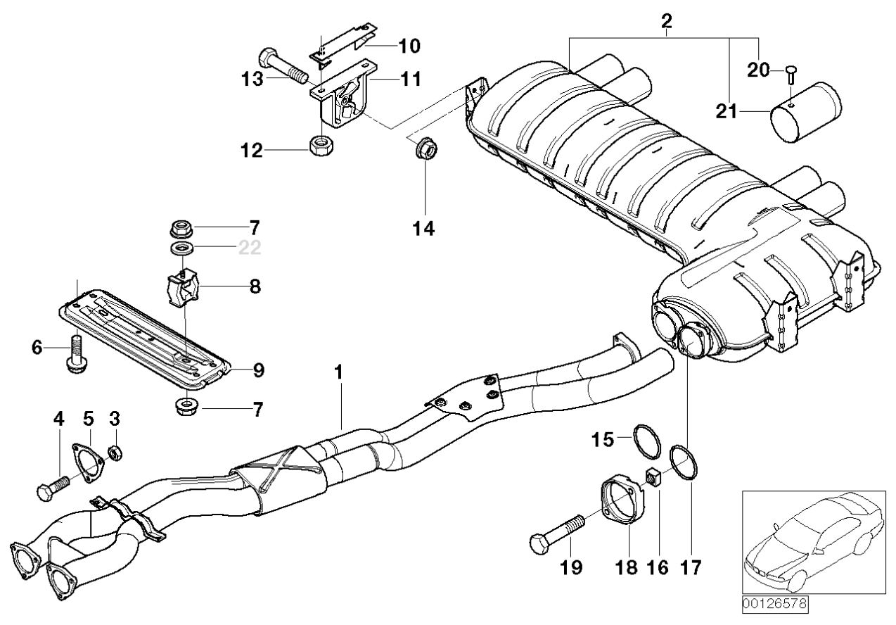

                    You sure the hangers are facing the right direction? The "k" is supposed to face the rear of the car, just like it's shown on realoem.
                      Click image for larger version  Name:	Screen Shot 2021-04-27 at 10.05.07 AM.png Views:	0 Size:	118.8 KB ID:	101400
                      Yea, the issue is the aftermarket muffler being a bit off. The Revshift inserts go in but make the topmost portion of the hanger much thicker so it won't fit into the metal bracket correctly, at least in my case.

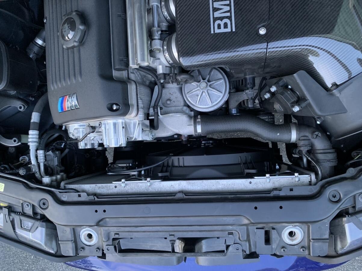

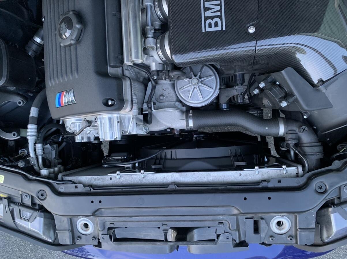

                            Spal 2082 install and put the front bumper back on. Easy job without removing the radiator if you have a helper.
