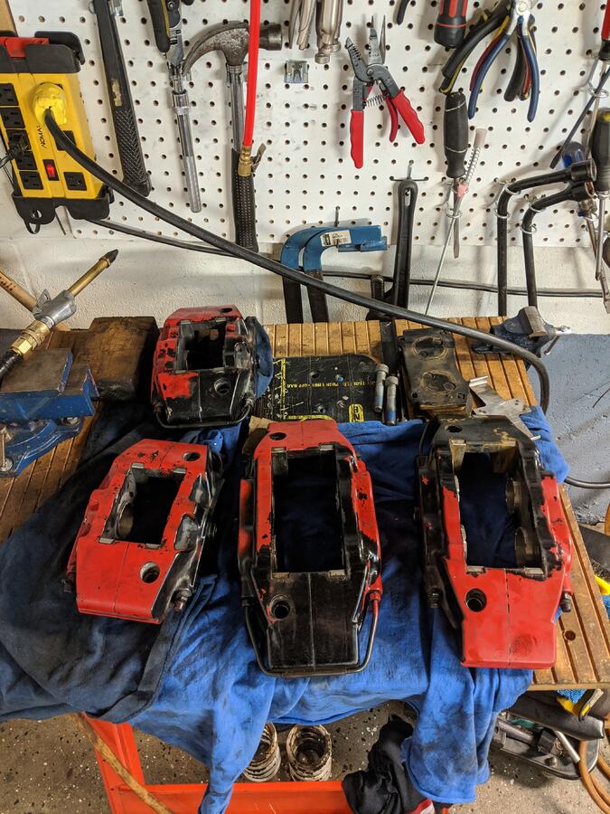

    What’s up with the 2 brake caliers?

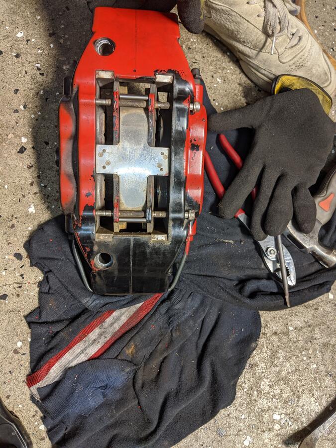

      All calipers off to get rebuilt. Dunno what color to go still, torn between yellow and a nice graphite/silver anodized look.
          Hydraulic ebrake
                  Both color options look great on SG, yellow will pop more if that's what your going for.

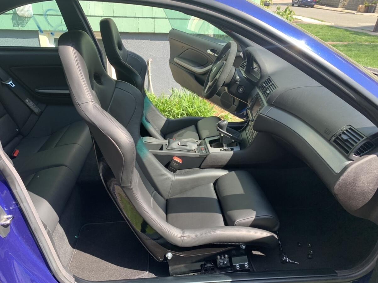

                          Take some pics of the Cobras installed if you don't mind, I really like these seats I recently put in a 996.
                          Do you simply retain the factory power sliders and then it just a matter of BK brackets for the Cobra's or is there more to it?
                          Also, I inquired about HMS installing seat heats and they said they no longer offer this. They told me to either swap my seats heats from my factory seats or buy a generic heat seat of some form and make the correct connection for it.
                            Went with a hot yellow and black lettering for the racingbrake logo. Bitch to clean but I always clean so...

                              That’s too bad about the seat heaters, that was key for me .. when I was looking into it I didn’t see any way to use an aftermarket one with the center console three setting button. You need some kind of thermistor temperature sensor as a third signal from one of the heaters so the controller knows how to switch them. Probably could salvage yours if you don’t care about keeping factory seats intact.
                              I did opt to use my original sliders and the bk brackets that bolt up to them, and made the wiring harness out of used ones.
                              This is the only pic I have at the moment ,..
