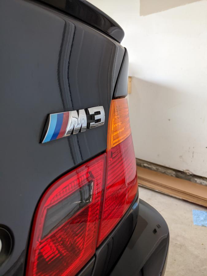

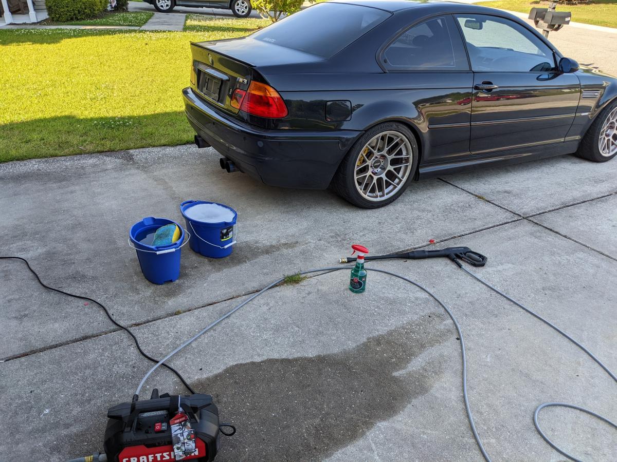

      washing her for her 21st. wash, dry, claybar, compound, surface prep, and ceramic wax.
      2nd pic is after claybar. hope to get some good pictures this weekend at a local spot.

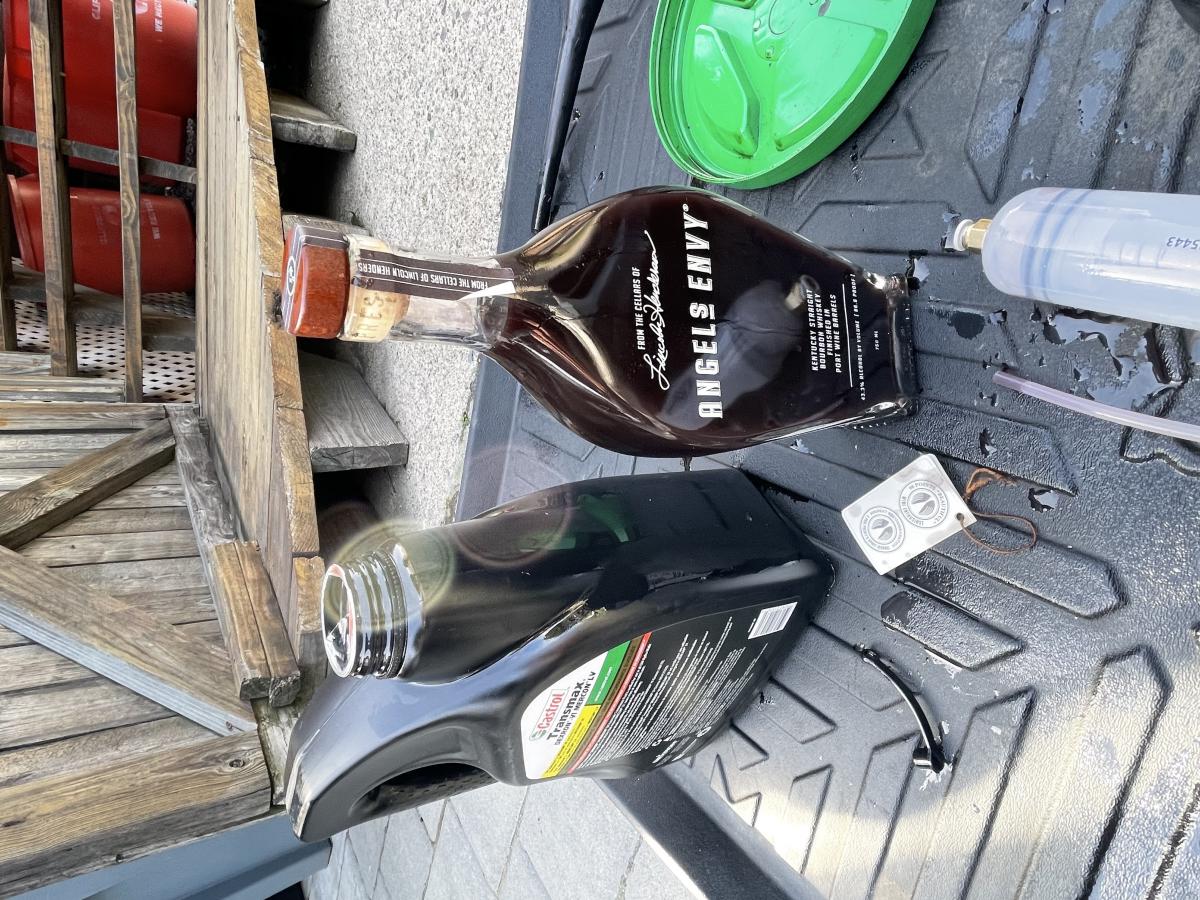

            I don’t think coolant should be this color 😂 Let the flush begin!
            Lol. This was my power steering fluid that i extracted after 5 cycles of flushing.

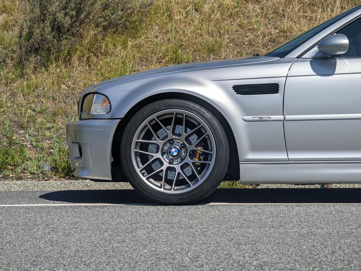

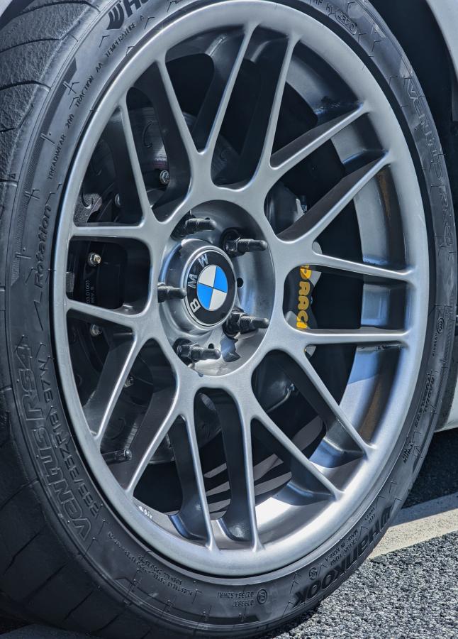

              Essex AP Racing BBK + Refreshed OEM rears and....Diffsonline 4.1

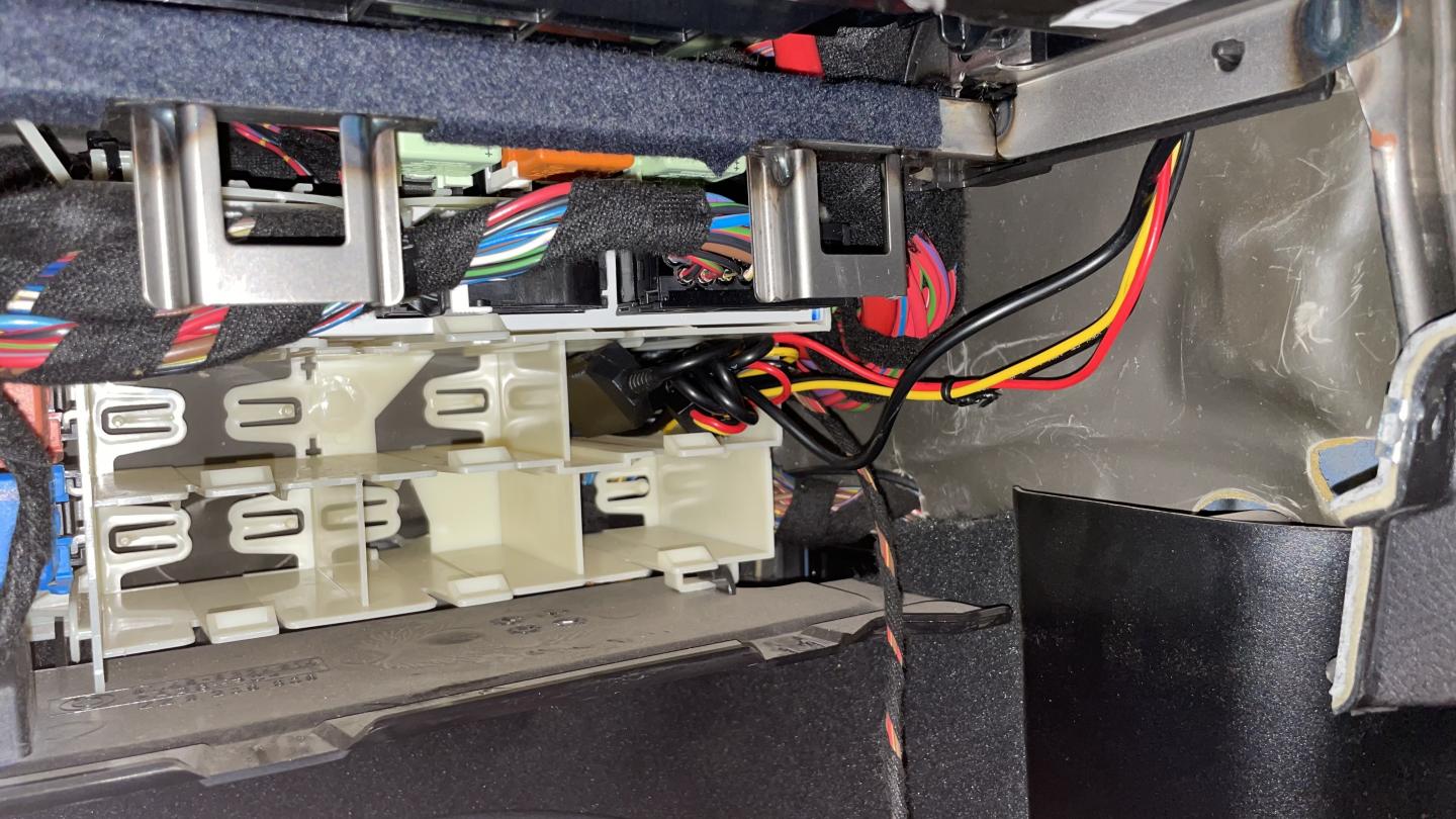

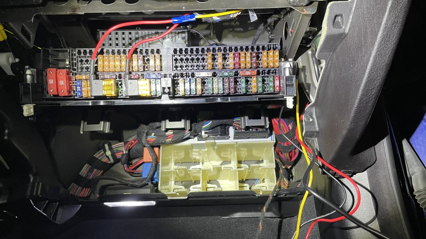

                Finally got around to hardwiring the car for a dashcam after putting it off for months.
                Click image for larger version  Name:	D4F40557-1D5F-4C02-97B5-47B3CC7AFA88.jpg Views:	0 Size:	208.3 KB ID:	164877 Click image for larger version  Name:	3A1A8F22-1F9E-4D25-BDAD-A9433FA9EFEB.jpg Views:	0 Size:	152.9 KB ID:	164878 Click image for larger version  Name:	110B5BF8-2B88-4B64-A08F-4FE275B6FBA4.jpg Views:	0 Size:	191.2 KB ID:	164879
                    I think I did something wrong bc my car's battery drained overnight. I really am not fit for electrical work.
                      Could something be triggering your camera constantly so it's always on?
                        I initially tapped the constant power to the cigarette lighter and accessory/ignition on power to the radio. Now I’m using front window (fuse 48) for constant power and heater (fuse 28) for accessory power. Will see if that works.

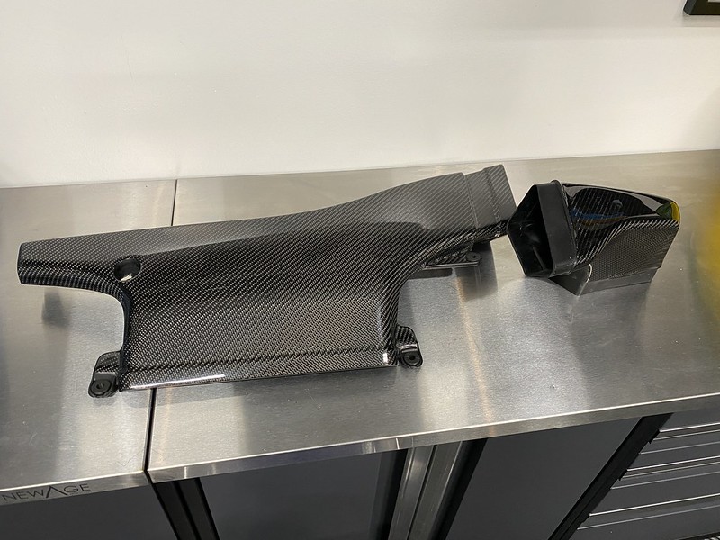

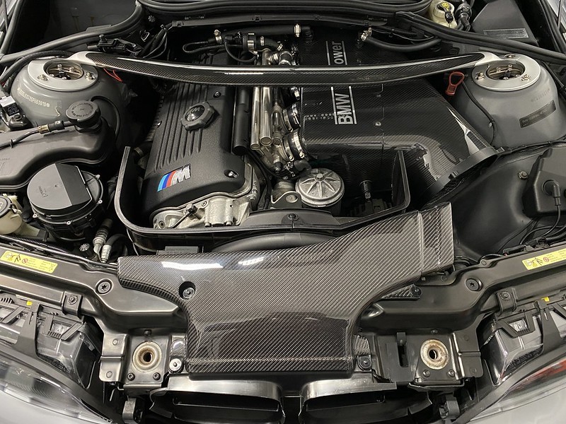

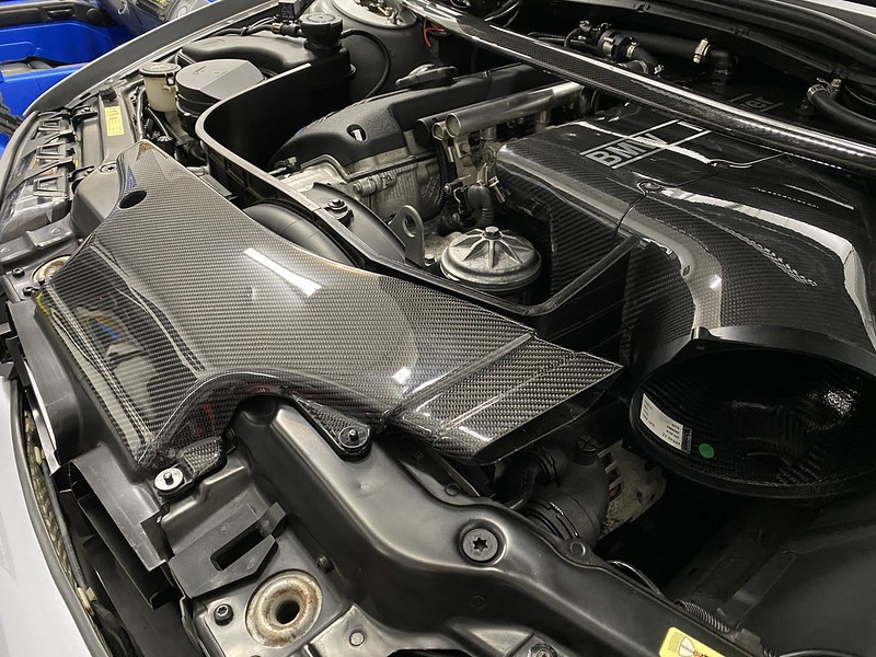

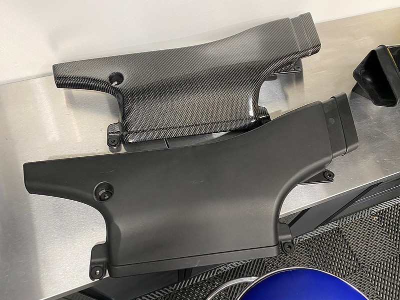

                          Installed yet more carbon fiber in the engine bay:

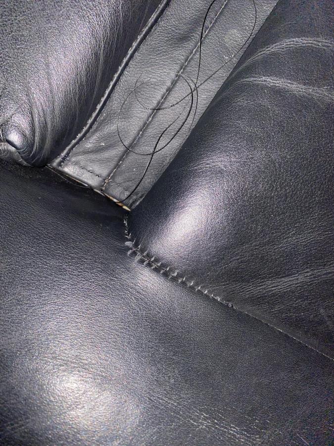

                                I restitched where a seam between leather panels had popped at the front left of the driver's seat. Results are not perfect, but far better than a popped seam. Next up comes restitching where it popped at the top of the left side bolster on the back portion of the driver's seat.
                                If your seams have popped like mine and you want to do the repair, buy a couple of curved quilting needles and some upholstery thread (then double it up.) I bent the tip of the quilting needle I used in a little more.
