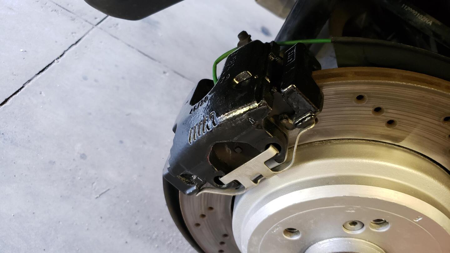

    Swapped out my PFC08 pads in the front after about 8 days on them. Surprised they didn't last longer, but this warping of the pads was a bit concerning. I'll be upgrading soon to an AP kit.

      Looks like some uneven wear. Time for a caliper refresh?

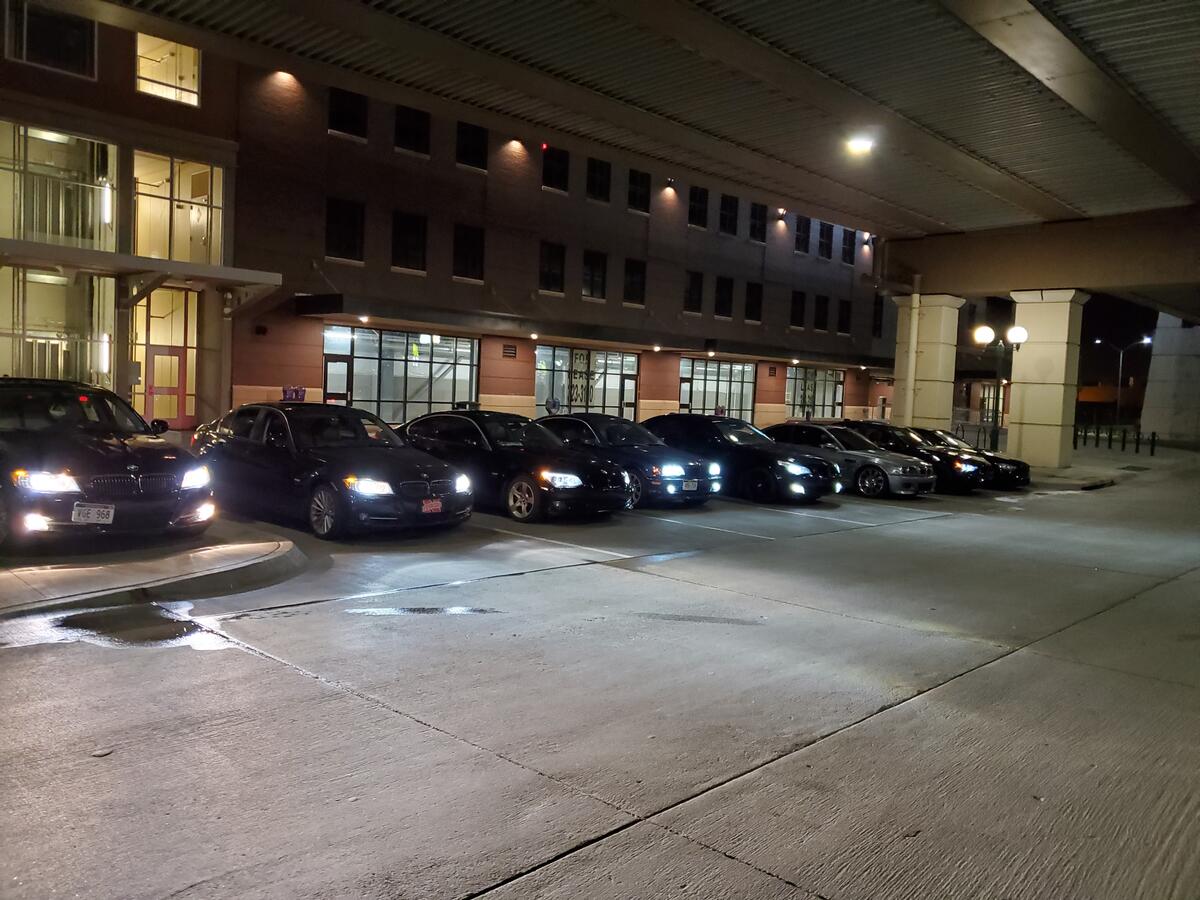

        Drove the shit out of it with the bimmer guys in Nebraska! I was the only E46 M3, man....

              yeah the calipers were totally toast. thankfully, i'm upgrading.

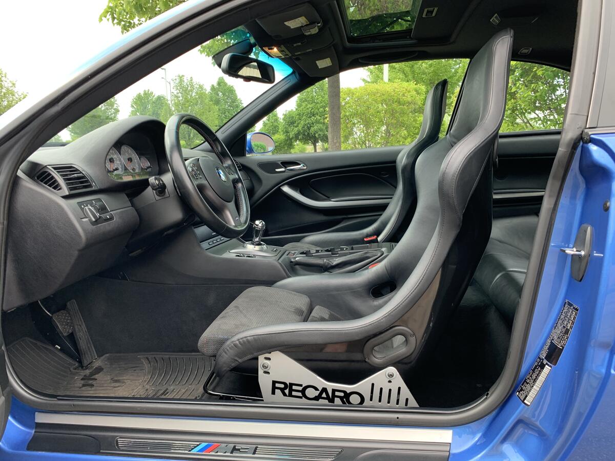

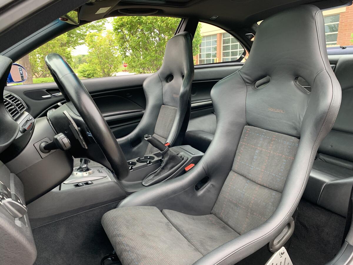

                            Ok, this is really weird. I bought a used set of Recaro Pole Positions and installed them in my car today. Came here to share. Pretty sure they're the exact seats from your picture. 🤯
                            That being said, I am enjoying the new seats! Really changes the driving experience!

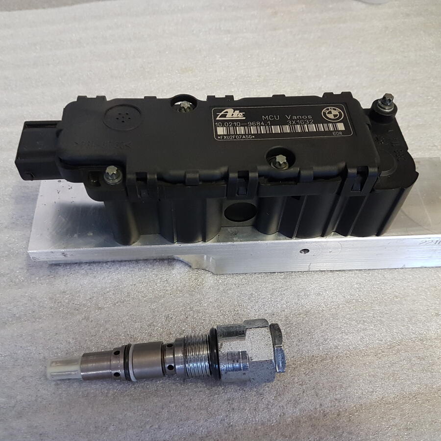

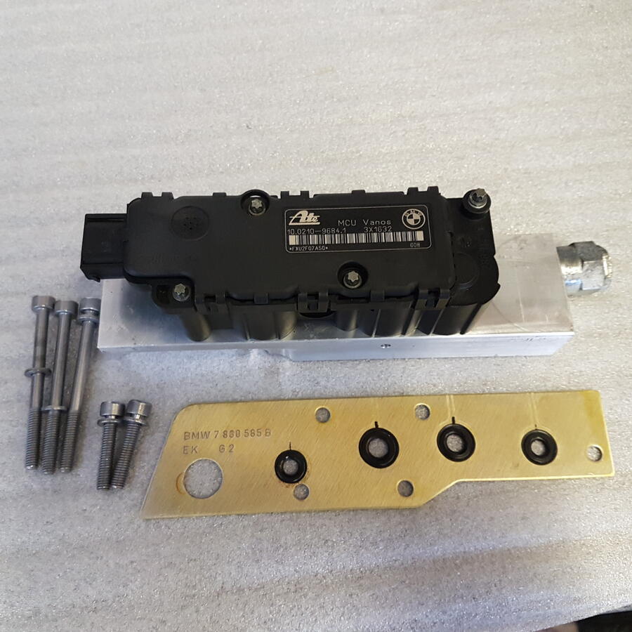

                                Did some basic checks and maintenance on the Vanos. Both exhaust hubs tabs are still there 😅, and looked to be in really good condition with no visible wear marks on tabs or oil pump disk. Also checked valve clearances. I changed the seals and filter in the Vanos pressure regulator and also fitted new solenoid body bolts. I bought the Beisan seal repair kit but the original seals were still soft and very flexible, so I decided not to change them at this stage
