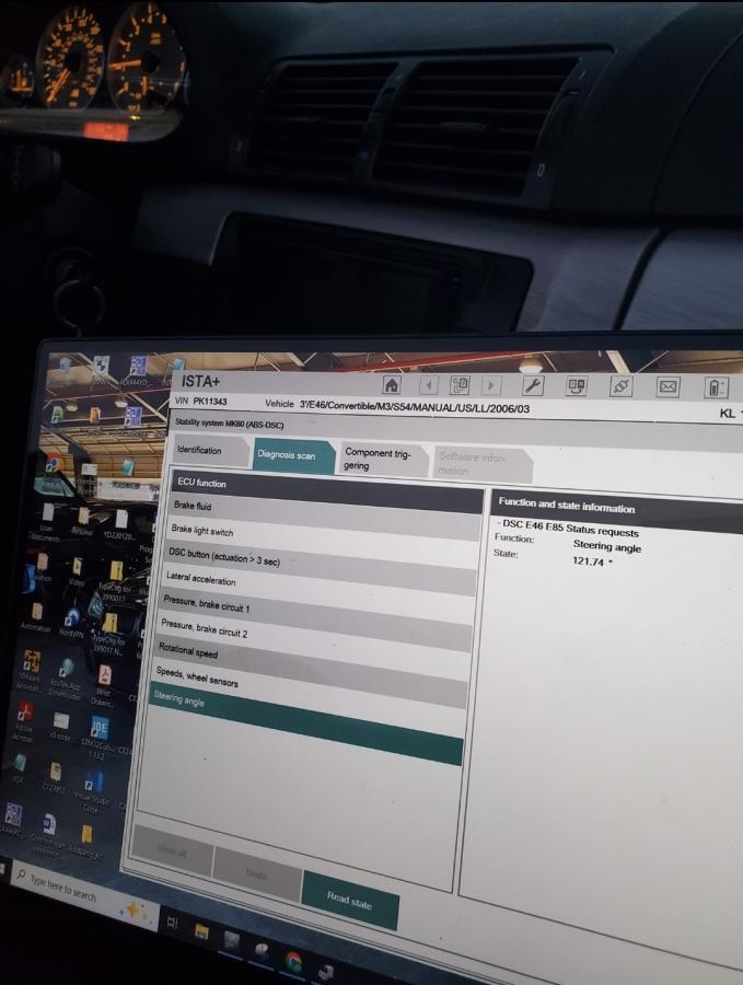

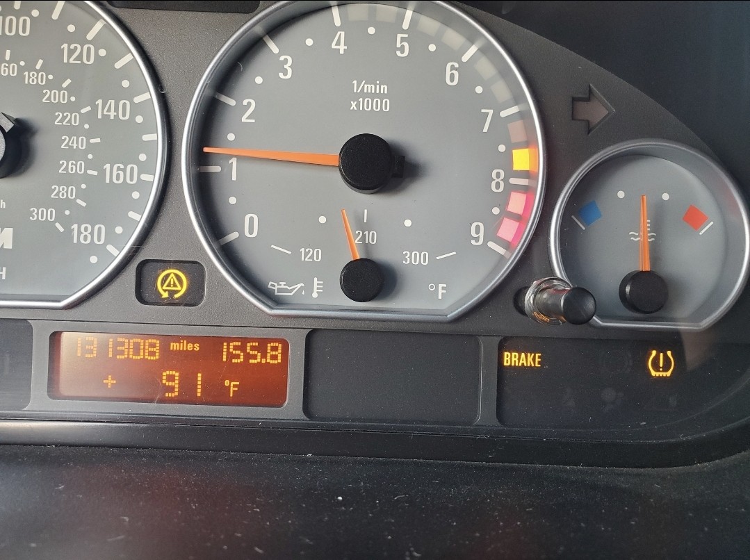

    Changed out my steering Rack and the steering angle sensor was off, had to reset last night: Click image for larger version
        Can you elaborate please? I'm looking to swap to a 712 and investigating if I'll have issues. What is your configuration?

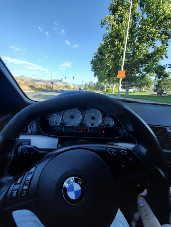

            Nothing significant, steering racks are plug and play and may need an alignment afterwards. I just popped in a donor rack while mine was being rebuilt which caused my steering wheel to angle to the left a couple of degrees while the car was going straight. This caused the steering angle sensor to go off causing the car to think: 'how can the car have the wheel turned but all wheels are rotating at the same speed'. A simple alignment would resolve it and get rid of the lights but since i'm putting another rack back in, would be a waste of money. When the rebuilt rack goes back on, i'll center the steering wheel and zero out the sensor and then go in for a proper alignment.
            TL;DR - lazy to do an alignment, hit reset on the dash lights.
            Click image for larger version  Name:	image.png Views:	0 Size:	910.3 KB ID:	269161​

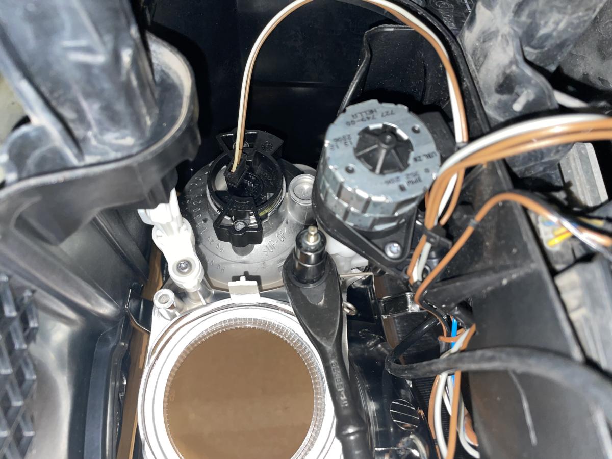

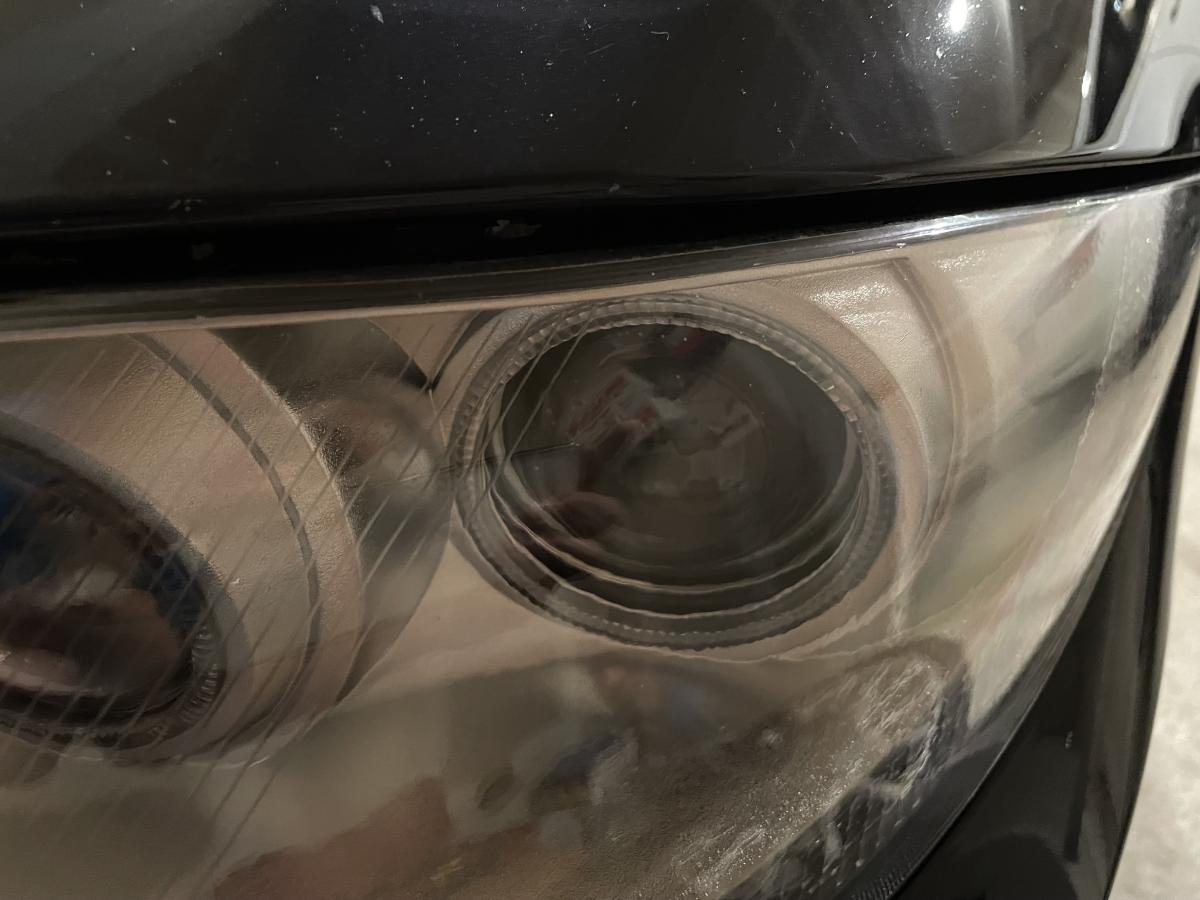

                    I replaced the OE xenon projectors for Evo XR 2.0. Still need to drive at night to see how much of an improvement they are

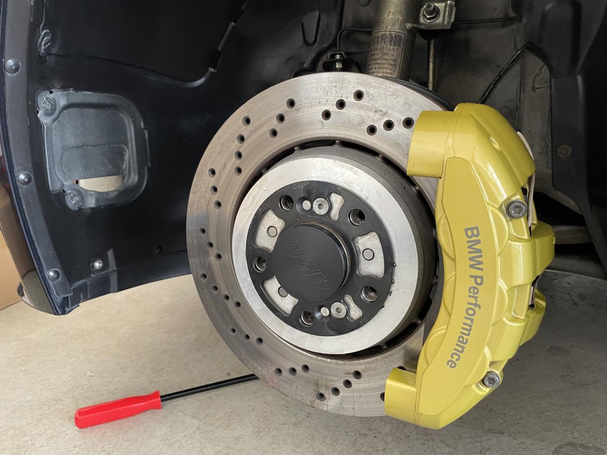

                    I took the chance to clean the wheel wells, Oh, and added a bit of camber as my wheels where rubbing the liners a bit.
                    Click image for larger version  Name:	IMG_0696.jpg Views:	0 Size:	132.6 KB ID:	269280
                    Click image for larger version  Name:	IMG_0743.jpg Views:	0 Size:	126.9 KB ID:	269281
                    the Z4M uses the knuckles from E36, so adding camber is easy. I have the camber kit from Turner which has 3 settings (washers) I went from 1 to 2. I will miss the quasi flush look, but will save me from buying liners which are expensive and mine are new

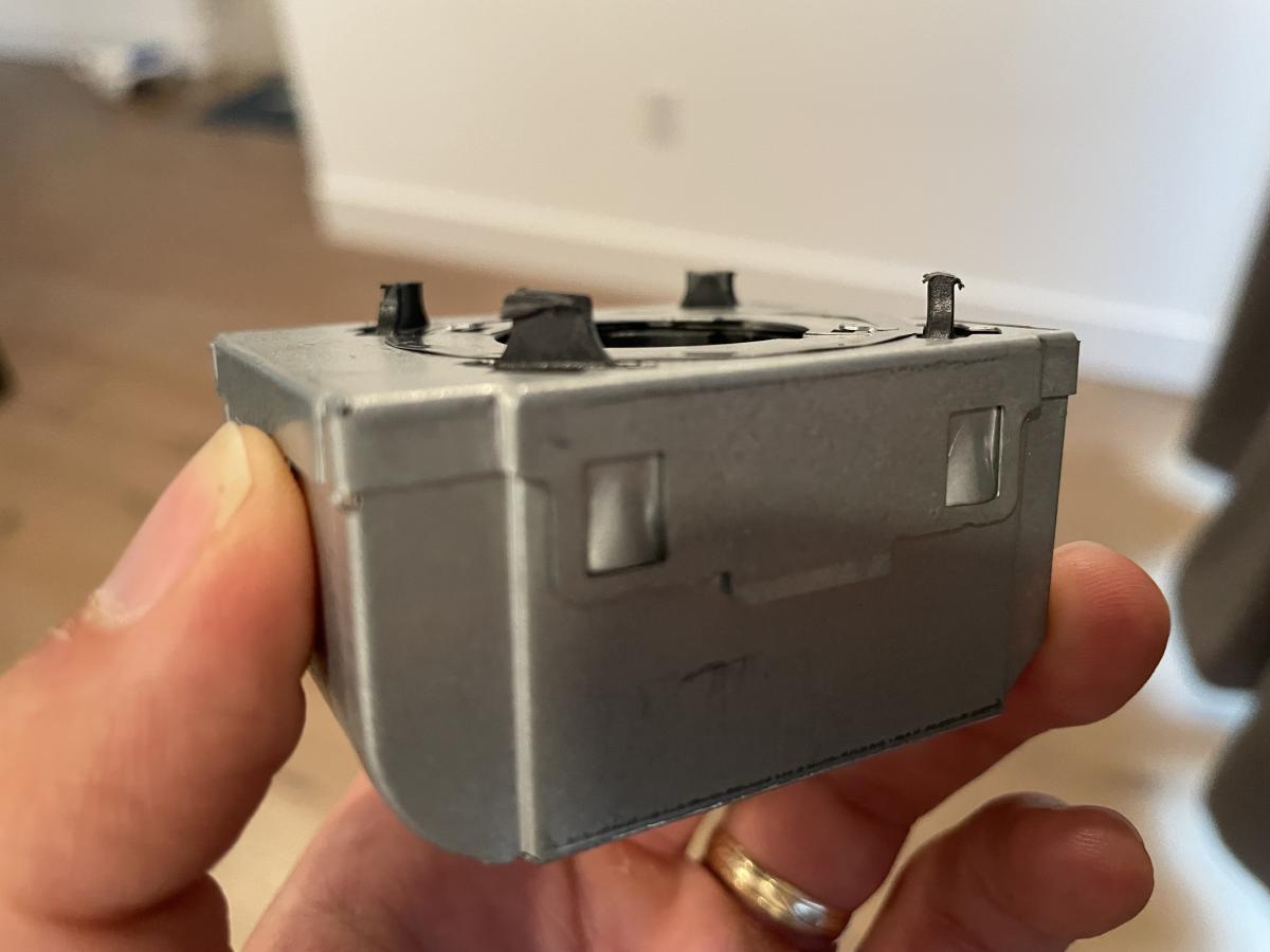

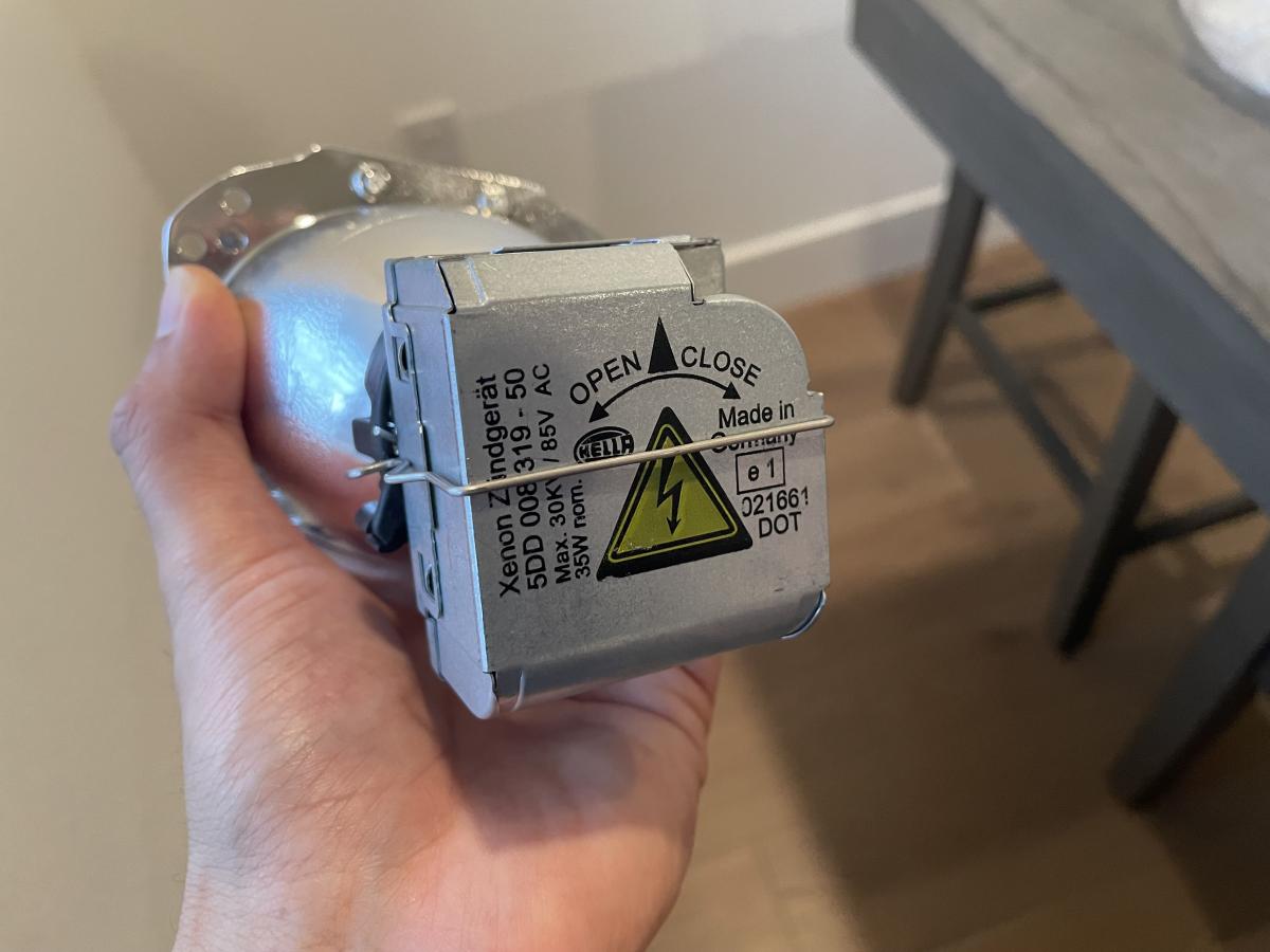

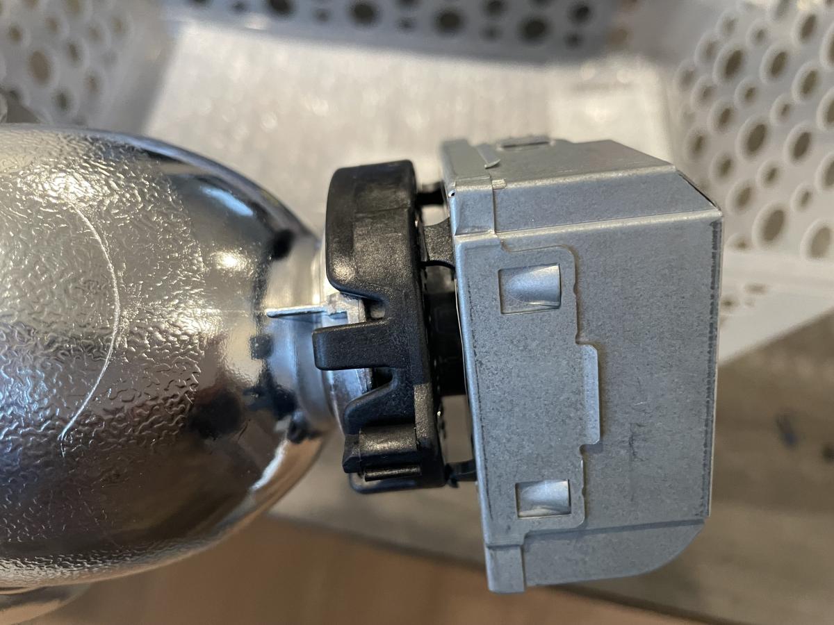

                    I also modified the igniter so it could be used with the Morimoto projector.
                    Click image for larger version  Name:	IMG_0706.jpg Views:	0 Size:	61.5 KB ID:	269282
                    Click image for larger version  Name:	IMG_0708.jpg Views:	0 Size:	124.1 KB ID:	269284
                    I was able to reuse the wire retainer so it is properly secured.

                    I will miss my etched lenses.
