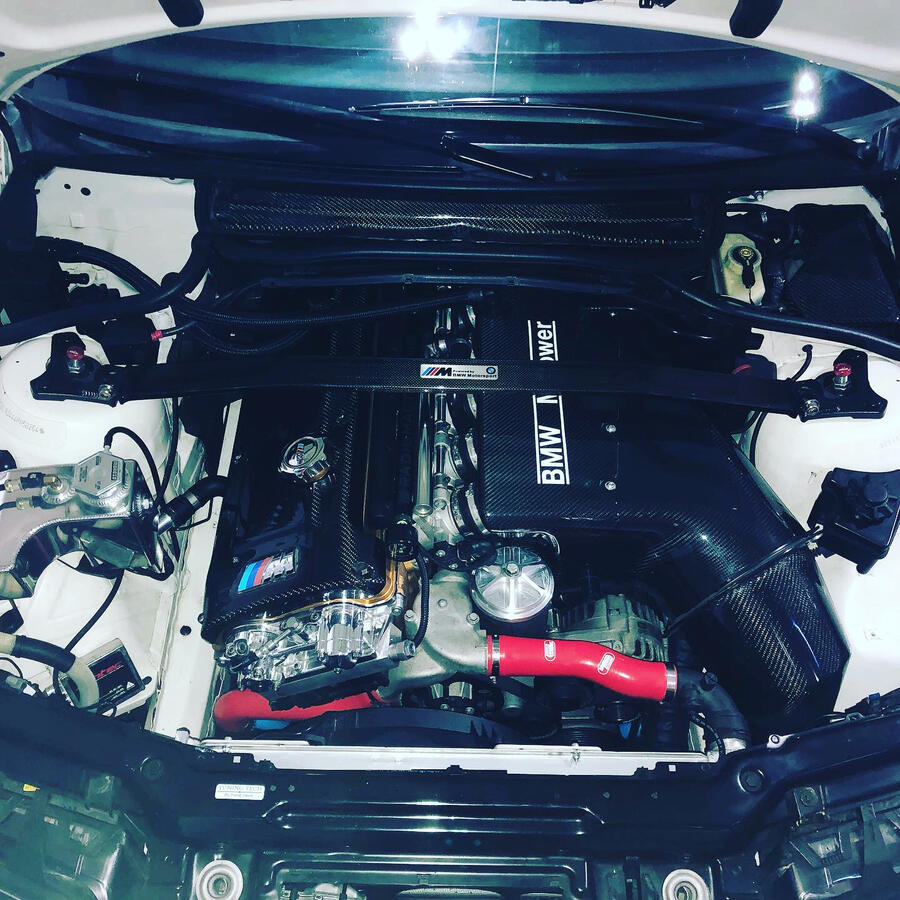

    Originally posted by stash1 View Post
    Looks Great! What strut bar is that?
    Evolve Eventuri
      It all looks very fancy and then you look at the snorkel that doesn't fit 🤨
        Nice to see the unused stock intake over the radiator removed.
        why do people leave it on ?
        Where did you get
        the "M" oil fill cap ?
        2004 M3 Mystic Blue
          CSL has it so I left it on my car.
            Thanx man, I couldn’t tell you if I knew...got it from a buddy in Canada.
              Click image for larger version  Name:	9B0AF883-14A0-4044-91F8-5248B7DF7313.jpeg Views:	0 Size:	160.3 KB ID:	31628
              Lol, it fits fine...it was detached for dyno testing previously & I just hadn’t gotten around to reattaching it yet.
                Where did you get
                Not sure if directed towards me, but dunno...it just looks like an appendix at that point—as in unnecessary. Ehhh, I hate to admit to it, but I believe that it was an EBay purchase.

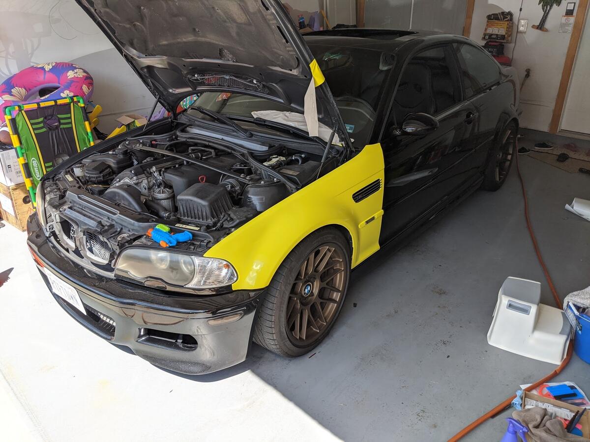

                  Wrapped a fender to get a feel of the difficulty. It's 3M 2080, Lucid Yellow.
                    And how was it?

                      Wrapping a fender is a good warm up but wrapping the front bumper or even something like the side view mirrors can be incredibly difficult. It takes a lot of patience and trial and error to get it right.

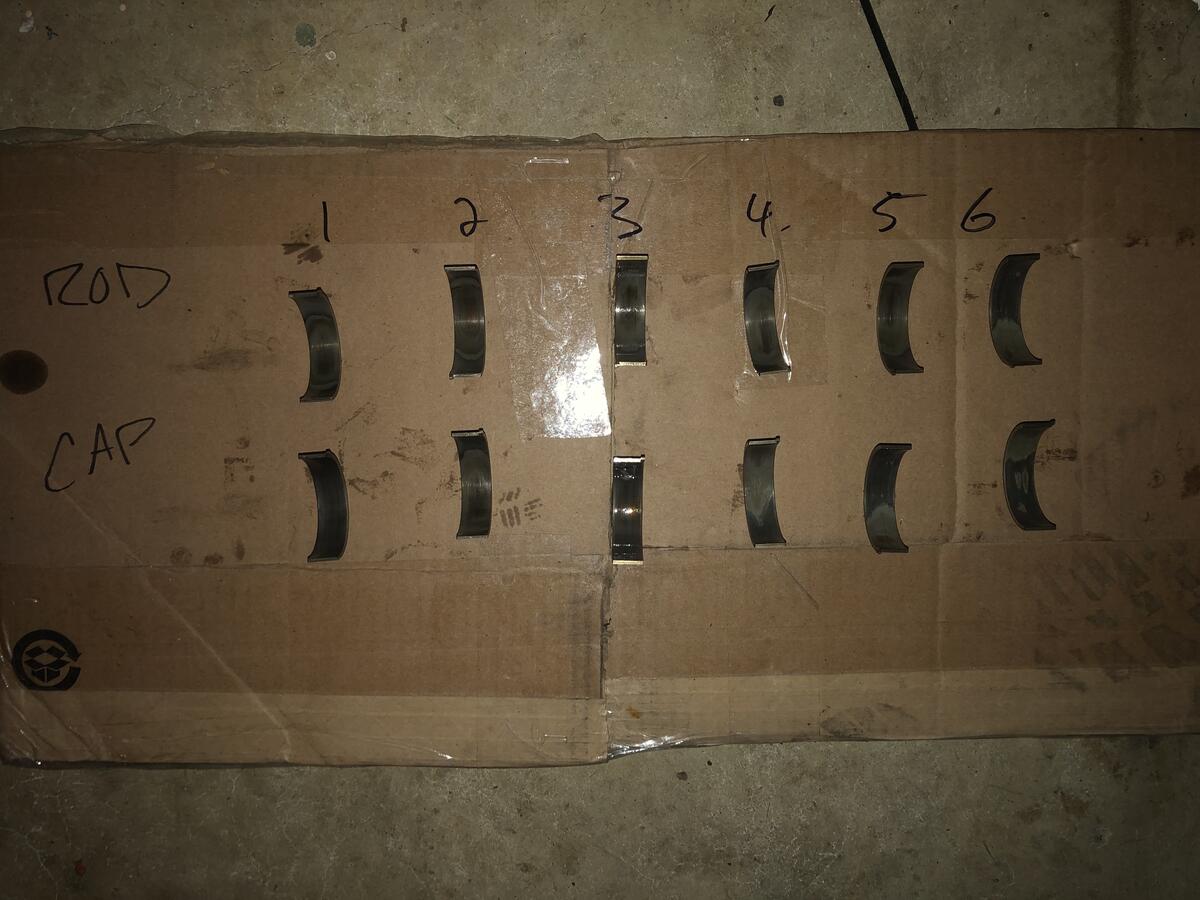

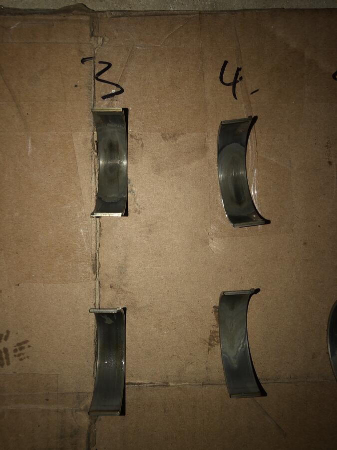

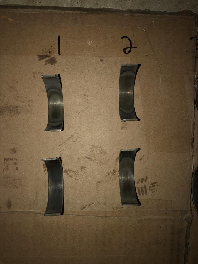

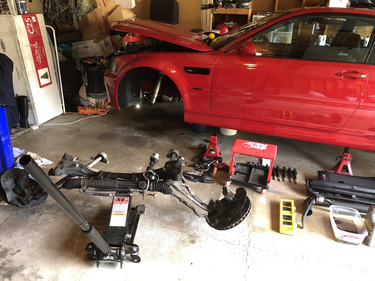

                        Been busy the past 4 days. Washed, Clayed, 2-Step Polish, and Ceramic Coated her. Rod Bearings changed (ACL Race) along with new OE motor mounts, OE steering guibo, BMW 10W-60 oil, and LM ATF power steering fluid. Engine should be good for another 70,000+ miles. Don't know when the old bearings were changed, if ever, but my last Blackstone was showing elevated iron, copper, and lead - so I just changed them for peace of mind and I am glad I did since three bearings were showing copper (#2 rod being the worst) with the others showing significant wear. Also, changed diff fluid since it was time.
                                When the shop did my mirrors, they actually did it in two pieces, one for the top half and another for the bottom. They aligned the split seam along the curve of the mirror. They complained most about the mirrors and the front bumper.
