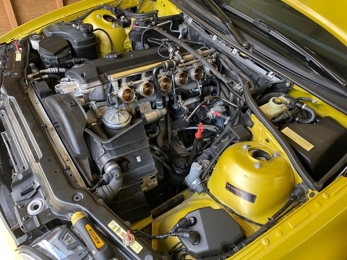

    New Valeo starter
    Cleaned TB's and plenum, cleaned MAF, cleaned IACV
    new fan clutch and blade. new belts and pulleys while i was in there
    bled brakes, drained radiator and engine block and filled with fresh coolant, flushed PS fluid, changed oil

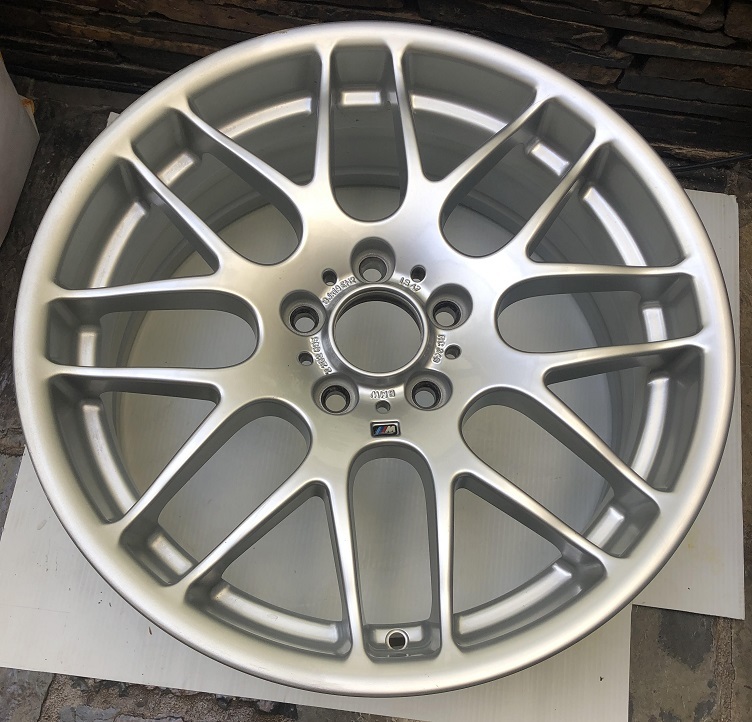

        Over a few hours last Saturday afternoon, cleaned a spare wheel with IronX and wheel cleaner. Spent a bit of time carefully removing old wheel weights and stripping all the adhesive and tire marks, then another round of Iron X and wheel cleaner. Did some claybar to finish it off ... for now. Will fix a number of rashes and a few nicks here and there hopefully this weekend then planning to polish then protect (with a dab of ceramic coating) before putting it in storage.

          Your car and my cars engine bay are twinses, right down to the color. Mine is missing all the same parts currently as well.
              haha yeah ! and we both own a S65 too
