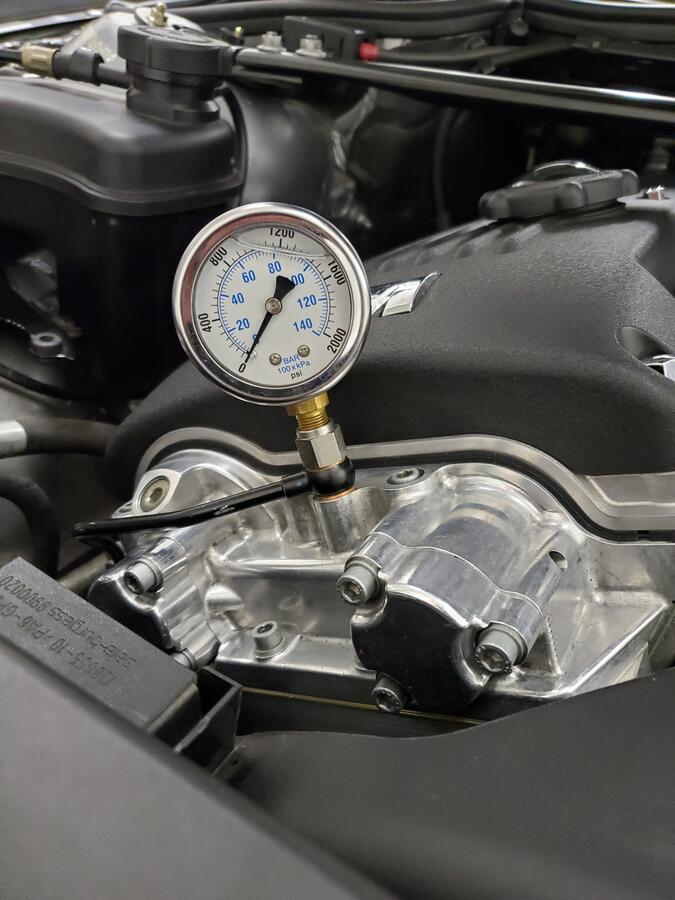

    Removed gauge (thanks Raj) as vanos is in spec and now I can drive the bitch without thinking about that aspect of the vehicle. Timed the engine 2x and have overcome the fear of the procedure so in the future I won't sweat it.

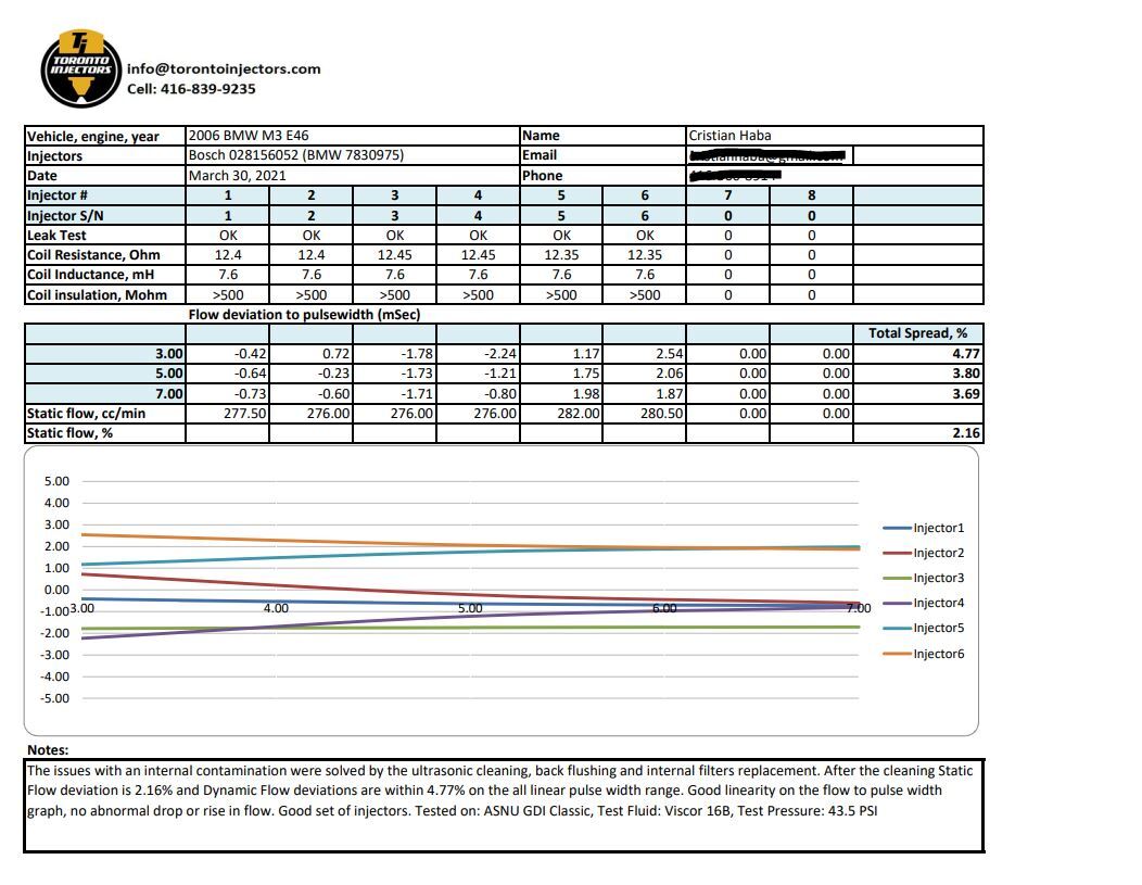

                          Took out injectors got them sonically cleaned, new o rings filters and flow matched. Based on the stats, was advised to place injector 4 3 closes to the fuel feed line, then 1 2 then 5 6. So far the idle is a bit cleaner, haven't noticed anything else, just very crisp throttle. Car has recently had a big overhaul (Reddish plates, CMP subframe bushings, CMP Rtab, guibo, fuel filter, new TPS sensors, Hotchkiss front and rear swaybars, valve adjustment) and a redo of the rod bearings due to a botched job by another shop.
                          Not Tbonem3 clean but close enough for me.
