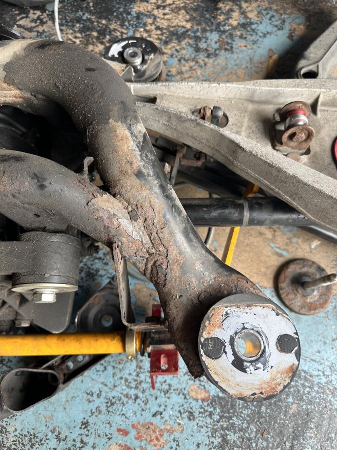

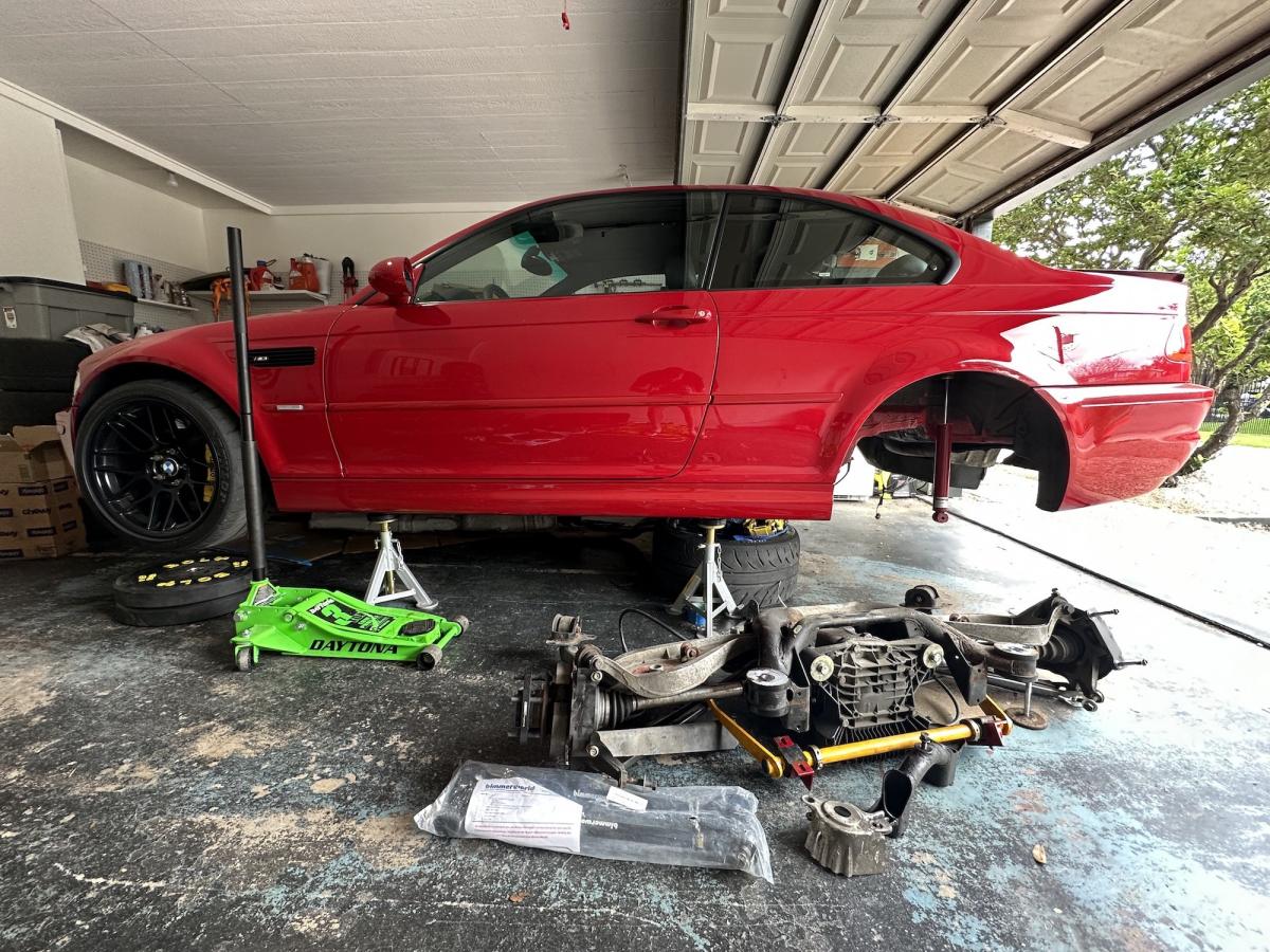

                      Dropped the rear subframe to do a full refresh and to install a topside brace. I'm glad I did, some of the rust on it was pretty concerning so I ordered a good condition used one that I'll swap everything over to.
                      This is the first time I've tackled a project like this on the car and, to be honest, it really wasn't that bad. The worst part was having to cut off the eccentric bolt that had seized inside the lower camber arm bushing on both sides. Luckily I have a new set of Bimmerworld arms to replace them with.

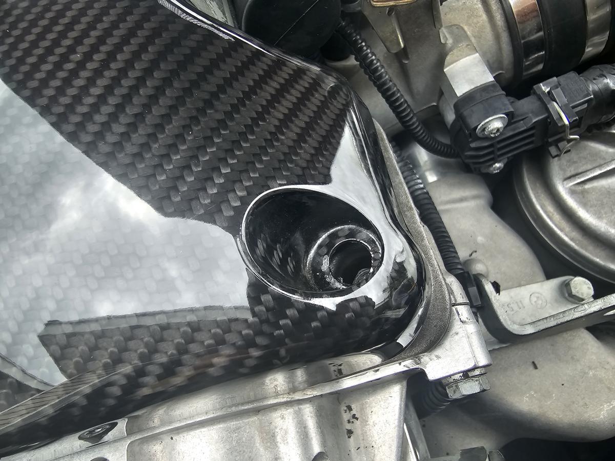

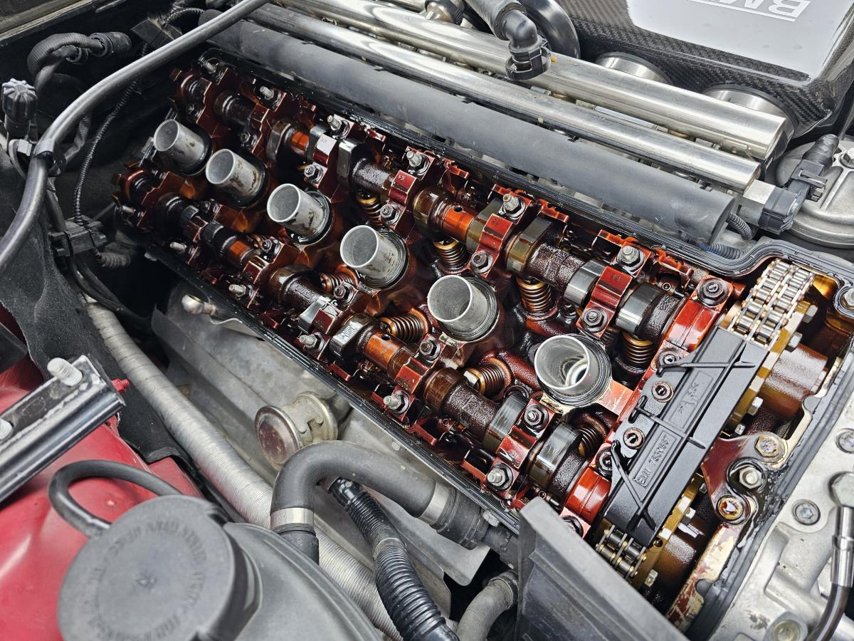

                          DIY'd the valve adjustment this weekend. Found the cause of the pronounced tap at idle: two very loose exhaust valve tolerances for cyl.6. Car's ticking is either gone or much quieter now at idle and just sounds like a bunch of mechanical noises rather than a distinct tap.
                          Also resolved my fears of worn camshafts or followers. They all looked good.
                          However, snapped off the damned upper portion of the valve cover stud on the front of the engine.Click image for larger version

                            Zamn zzyzx zat zucks.
                            That would annoy me to no end.
                              Yep. expensive lesson learned.

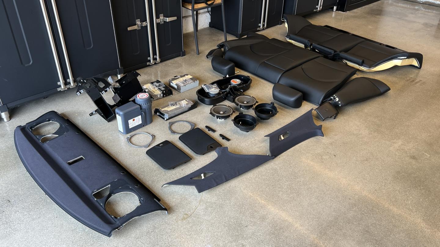

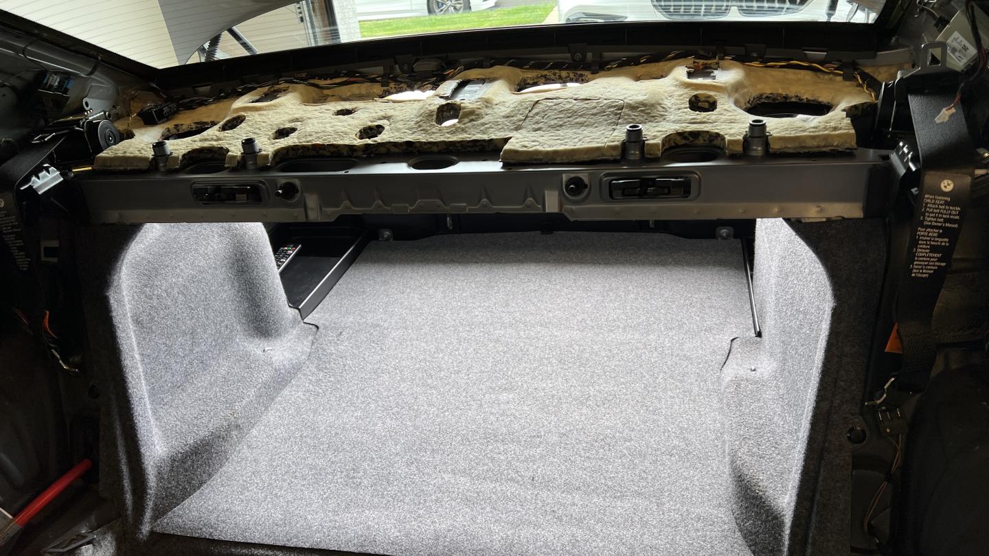

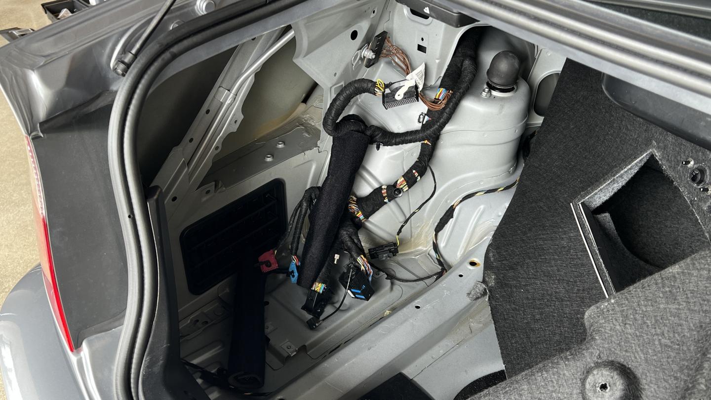

                                Audio delete, new euro parcel shelf and new c pillars going in
