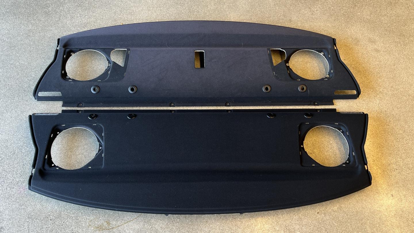

              Audio delete, new euro parcel shelf and new c pillars going in

              What's the difference between US and Euro parcel shelves?
              '01 M3, Imola/black
                It has no holes for the latch restraint system and uses the smaller hifi speaker grills. Subtle difference but a little more sleek

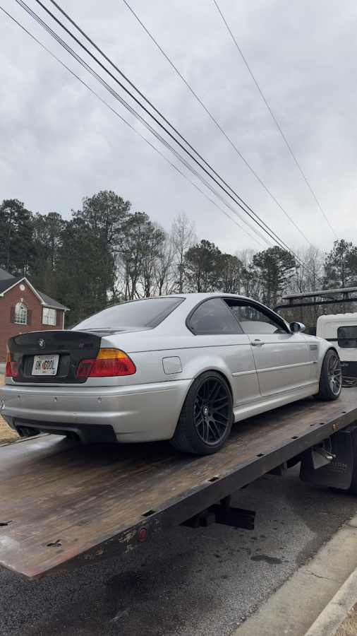

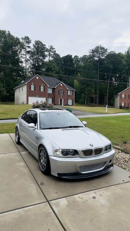

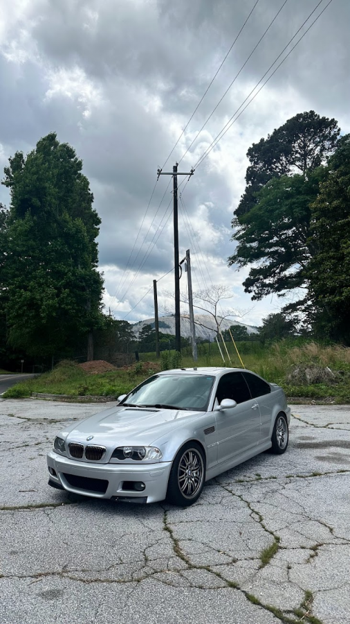

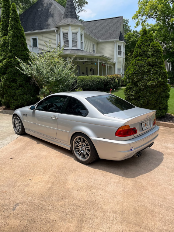

                  In the process of making the car my own, I replaced my oem bumper with a CSL style one and finally paint matched my csl style trunk and diffuser(installed by previous owner several years ago).
                  Before

                  After

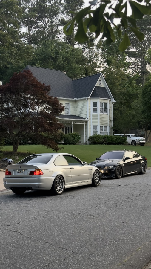

                  Bonus pic my car and a buddy's e92 ​

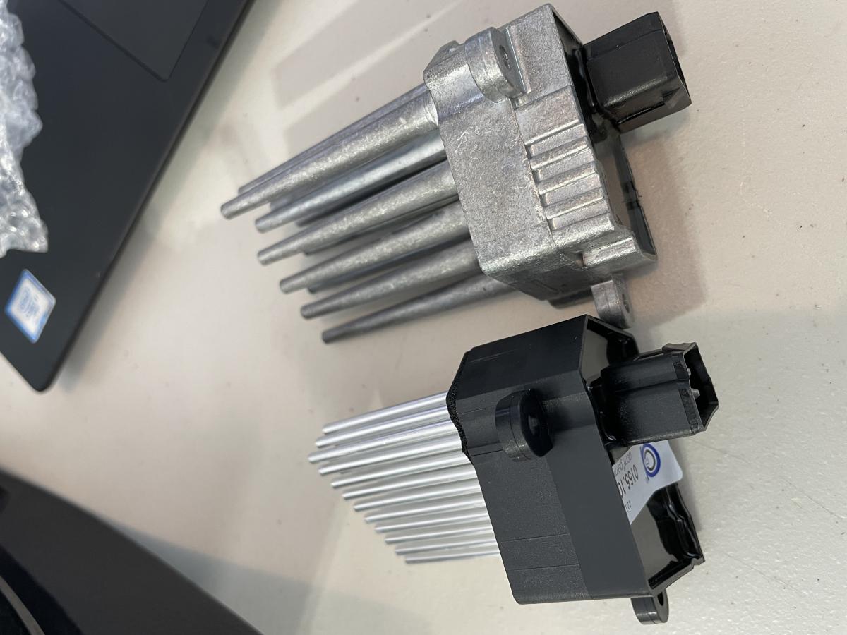

                        Started having some goofy AC blower fan speed modulation, so I did the FSR today thinking maybe that fixes it. I replaced original unit with the ACM brand part. I'll say that the new one has shorter "fins" so it goes in easier than the original one comes out (hits the actuator rod on the little motor thingy in the way), but the housing shape isn't quite the same (plastic v. metal) so it takes a bit to get it seated; looks same as the $200 OE part so figure WTH. The fat plug was a PITA to get off, AND re-seat; don't break the little motor thingy in the way; best to unplug it first and if you have a long T-20, all the better. Other than that, it works, hoping not to have to do this again--replacing glove box and foot bulbs while I'm in there. I always like comparing the old parts to new, seeing what's different, how they cut cost, etc.
                        EDIT: Drove around today and I noticed more air is output at the vents, and the AC feels cooler. Interesting.
